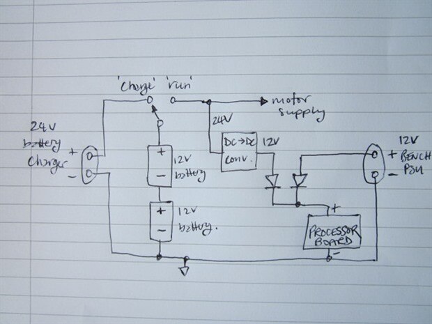

-How can I transform the 12v output from my batter(y/ies) to a 24v line to drive these motors? Series circuit would be out, because the Arduino will be running off that line.

    jc2048 over 9 years ago in reply to jc2048
    My first thought would be something like this (are you ok with circuit diagrams?). Others here may well have better ideas.

    vandia over 9 years ago in reply to jc2048
    I don't have very much experience with schematics.... I presume to the right of the 12v converter are diodes?
    I don't know what the triangle at the bottom means, and what's the 12v on the right?
    Also, will these schematics allow the board to stay powered without interruption when being plugged in?
    Thanks for the effort in drawing this, btw! <3

    rachaelp over 9 years ago in reply to vandia
    Also, will these schematics allow the board to stay powered without interruption when being plugged in?Yes you are correct these are diodes.
    The triangle at the bottom is a GND symbol, and whilst it's not strictly necessary on this schematic as the whole return path is shown as it's all wired together, if there was another part than needed connecting to this then using that symbol there too would imply the connection.
    The 12V on the right appears to be an external 12V bench power supply. What Jon is doing with the two diodes is OR'ing the regulator output with a bench supply so you can plug in the bench supply to maintain a constant supply to your processor board before switching over to charge the batteries.
    Best Regards,
    Rachael
