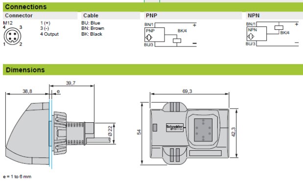

The ngerprint reader biometric switch is designed for use in industry to protect access to systems or machines. No type of interface is required for programming and operating the switch: it is an independent unit.
2 types of product are available:
- bistable biometric switches type XB5 S1B, with 2 xed states,
- monostable biometric switches type XB5 S2B, with pulse control.
The biometric switch is aimed at 2 types of user:
  • - the administrator, who manages the registration and deletion of ngerprints,
  • - the operator who, once registered, uses the product as a control unit.
  • The product is of monolithic design (a single plastic housing) and is xed by means of a nut (hand-tightened without need for tools) in a standard, 22 mm diameter hole.
  • It operates on a 24 V d.c. supply.
  • Connection to the power supply and to the control output (relay or plc) is by means of a 2 metre able or by M12 connector.
  • It can be installed on a at, horizontal or vertical surface.
  • A protective cover is available as an accessory to protect the active face of the sensing screen. This cover is xed by means of a self-adhesive hinge.
