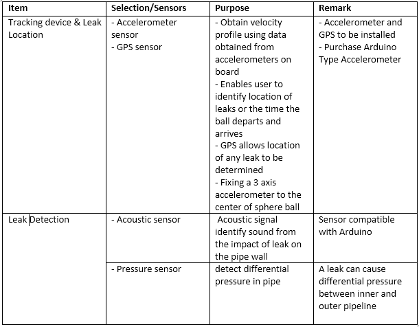

I am new here. I would like to have your kind help to assist me in my project. Actually, I was currently doing my Final Year Project for my study in university.
My project title is design + setup a tool which capable of detection and location of leak in designed pipeline.
To make it short, now I'm in the phase of identification and selection of components for my device.I would glad to have your opinions in which preferable type of sensors to be purchased in my project
The components selection criteria are as attached :
Basically I want to find for sensors using for :
1. Leak detection in pipe (acoustic sensor)
2. Leak location in pipe (accelerometer/GPS sensor)
3. Tracking device in pipe (accelerometer/GPS sensor)
4. Different pressure as leak occurred in pipe (differential pressure sensor)
Your attention and help is highly appreciated.image

    I have good luck with the following pressure and acoustic (I would recommend MEMS microphones). For the accelerometer, there are tons of options- what are your parameters and price point?  That would narrow down the selection.
    Acoustic: TDK/EPCOS MEMS mic --> B39000T4061P810
    Pressure: TrueStability sensor from Honeywell (without using ports, a high quality pressure sensor) .25% accuracy -->NSCSMNN150PDUNV
