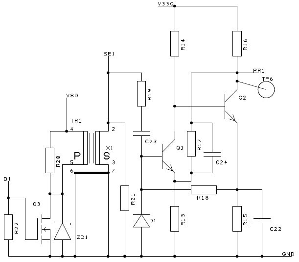

    The transmitter recieves 15v ac so ...
    I don't know if that is possible with this component
    • Reject Answer
  • michaelkellett
    0 michaelkellett over 9 years ago in reply to nicoloquinte
    You don't need a switch - you are trying to do exactly what car reversing sensors do - so there is a load of stuff on the web.
    I've done some of this work - here's a bit of circuit that I've used:

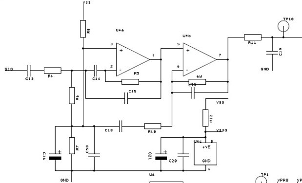

    The transducer goes between SE1 and ground, pulse D1 to drive the transducer, take the signal at PR1 to S10 on the filter. D1 and R19 protect Q1 from the huge voltage at SE1 when the transducer is driven. Most cheapo reversing systems work like this, although they often use a dedicated chip rather than discrete components.
    This is the bandpass filter and drives a 12 bit ADC on a micro.
