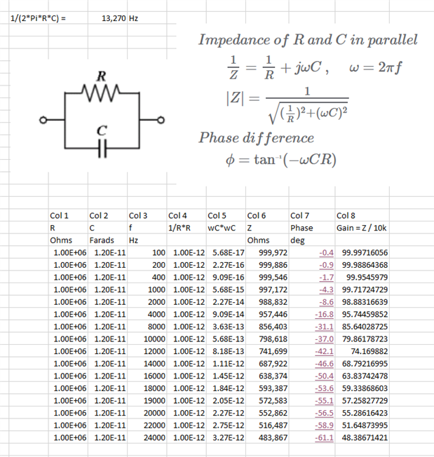

  • fmilburn
    0 fmilburn over 5 years ago in reply to michaelkellett
    Hi Michael
    I am trying to get an intuitive feel for what changing C2 in the Freetronics board does.  If there is no C2 then there is a straight forward inverting amplifier with gain of R4 / R2.  With C2 parallel to R4 in place then at higher frequencies the gain would intuitively be reduced because the negative feedback impedance of the op amp is reduced which reduces gain and thus it acts as a low pass filter.  Is that a valid way to think about it?
    Anyway, if the values on the Freetronics board are placed into the formula you give above then I get cut off at 13,200 Hz.  This seems low given human hearing and electret mics (maybe not cheap ones) can detect higher.
    Ignoring R2 for the moment I set up a spreadsheet and calculated the impedance for R4 and C2 in parallel and varied it with frequency.  Column 6 is the resultant total impedance and column 7 is the phase angle.  Then assume the total impedance in column 6 can be divided by R2 (10,000 ohm) to get the gain as given in column 8.  Varying the frequency in column 3 gives a 50% gain reduction at roughly 22 kHz by this method.  So my question is whether this is a proper calculation and also wouldn't the phase angle distort the sound?  It does not give sharp cut off either.  Is it a good idea to even have C2 in this application?
    Finally, I don't understand what is being done with the sound pressure level output.  The notes on the schematic say that the pin voltage varies with sound pressure level.  But it looks like a comparator with a low pass filter following it.  The comparison voltage is set at roughly 0.07 V with a voltage divider.  The notes describe the low pass filter (I get 60.29 Hz cut off) as “sound level storage.”  I can see where it does something but it doesn't seem like it is meaningful sound pressure level which is normally given in decibels.
    Thanks for the thoughtful and knowledgeable answers you give.
