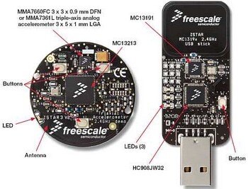

Hello Everyone and ADVthanksANCE for any input you have.
I'm looking for the proper sensor to measure the acceleration of a frisbee. I will be mounting it to the bottom of a frisbee on a PCB I design utilizing most likely an ATMEL AVR microcontroller. I'm in the early design stages so don't have many answers nor are there many requirements decided on. I plan on drilling holes into a frisbee and placing LED's strategically. The LED's I wan't to light up based on the measured acceleration. The faster the frisbee travels or the spin measured, the more lit up it will be. Cost is certainly a consideration since the project is a playtoy and an opportunity to learn from. It won't be marketed nor is it something I plan on showing off to anyone other than my buddy's at night trying to play catch in the dark. I'm trying to figure out the proper sensor to use in this case.
Thanks again,
Matthew

    I believe that a Gyro sensor would be definitly better to measure the rotation of a frisbee than an accelerometer but it is much more expensive image
    If cost is a constraint (you never know, may be your luminous frisbee will be the toy of the summer 2013 and be sold millions units), I would recommend to consider Freescale MMAxxxx or ST LIS3xxxx accelerometer, which are cheaper image

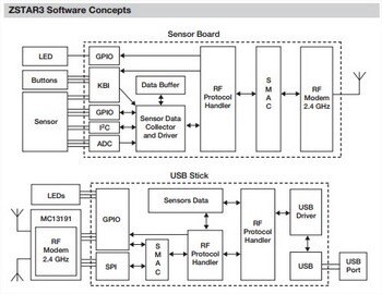

    May be you could start prototyping just with the Freescale ZSTAR3 reference design demonstrating Freescale accelerometers, Zigbee radio solutions and 8-bit S08 MCU family.
    This demo is based on two boards :
    - a standalone battery powered board featuring the accelerometer and a System on Chip embedding the radio transceiver and an 8-bit MCU from the Freescale S08 family (MC13213) that you could stick on the frisbee to measure the acceleration
    - an USB dongle featuring a radio transceiver (MC13191) and an 8-bit MCU embedding an USB device controller (MC9S08JW).
    Sensor board is available in two versions : based on a digital accelerometer MMA7455 or based on an analog accelerometer MMA7660 (higher bandwith but need a good ADC in the mcu) ?
    Sensor board RD3172MMA7455LRD3172MMA7455L is sold in Farnell store and costs less than 40£
