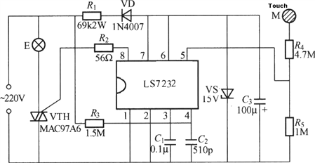

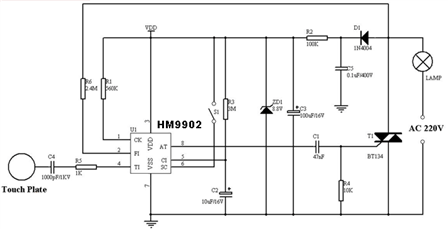

    0 dougw over 13 years ago
    Hi Richard,
    Here are a couple of standard circuits to make a touch sensitive ligh switch...
    Doug

    0 e14 Contributor over 13 years ago in reply to dougw
    Doug,
    Thanks for the circuits!
    I appreciate the circuits; I have been trying to figure out how to get started.
    I have not, yet, analized your circuits; though, it appears that they are using 220V.  Here in America, we use the 120V; I presume I would just need to make some applicable adjustments -- is that correct?
    This is great!
    Thanks.
    Richard

    0 dougw over 13 years ago in reply to e14 Contributor
    Hi Richard,
    The circuits should work as is with either 220 or 115 vac. The 15V zener limits the voltage to the chip in either case.
    You can find a datasheet here:
    http://www.farnell.com/datasheets/57961.pdf
    Doug
