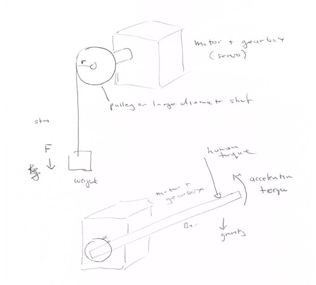

    I am using the servo to move a mounted rod back and forth (I'm currently moving it from 0 to 90 degrees-but the angle will change every time). What I am interested in is finding a way to calculate the instantaneous torque of the rod (or servo, I guess). While the rod is moving, there are times at which a force acting against the motion of the rod is applied, which is why the torque won't remain the same between each experiment (its actually going to be a person pushing against it-each time with differing levels of force). I am using a powerful, 200 oz.in servo with a 3:1 gear ratio, which means that the servo should push through most forces acting against it while moving at the same speed. The idea I had to calculate the torque was to place an accelerometer on the rod, and then use the values measured and multiply them by the moment of inertia. Theoretically, this should give me the torque, I was thinking. However, I'm not sure how accurate an accelerometer would be in this case, how to implement it, or if there are better ways to do what I want to do at a reasonable budget.

    If you want to know torque then a really good rule is to measure it as directly as possible - if the rod speed is largely independent of the human load but it's the human load you want to measure then trying to estimate it by acceleration will be really inaccurate.
    The simplest way to measure torque is to measure the motor current but this may not be very accurate due to losses in the gearbox etc.
    If the rod is accelerating sufficiently fast that the acceleration torque is comparable with the human torque you can calculate the amount of torque needed to accelerate the rod and subtract it.
    You could make or buy a torque sensor.
    You could use  a low cost load cell to measure the force the human applies so long as you can arrange for that force to applied via the load cell. This will be the cheapest and most accurate way.

    torque=moment of inertia * angular acceleration, true, but only applies to the torque needed to move the bar, tells you nothing about the torque applied by the human.
    If the bar has significant mass you will need to measure the torque applied by the motor, subtract the bar acceleration torque and possibly subtract the torque due to  gravity acting on the mass of the bar.
    I've attached a pair of drawings produced on a special high tech mechanical simulation package. The top sketch shows the calibration setup. The lower sketch shows what I think your set up looks like (how about some photos from you - it would help).
    Remove the rod to calibrate, the servo should be holding the weight still so the force of the servo is balanced against the force of gravity acting on the weight.
