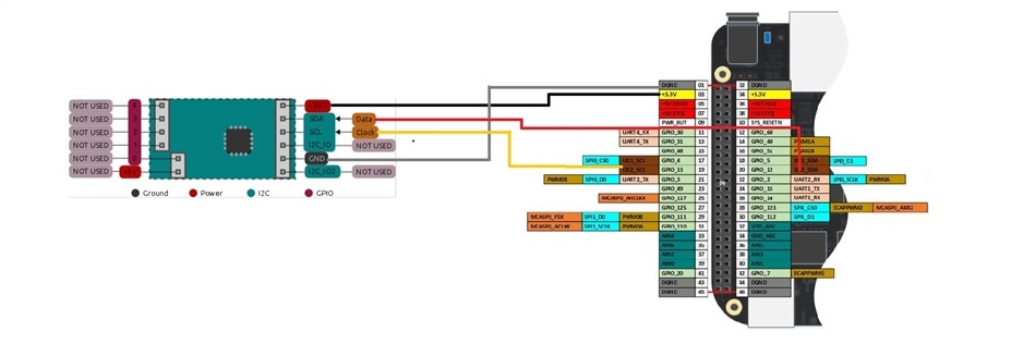

Hi Guys!

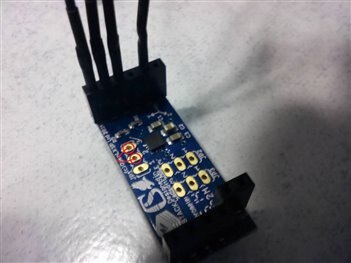

I've tried to mount a Microstack Accelerometer on my new Beaglebone Black using the Program Matlab. (Sensor Technical Page Franell: Microstack Accelerometer Accessory Board).
First i had some Issues because there was missing a Jumper on the board so i couldn't get the I2C Adress of my Sensor (JP1-2   JP1-3).
Now that i managed to get the Adress and connect to my Sensor via I2C i am not able to get any right Data.

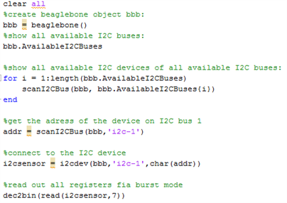

My Program in Matlab:

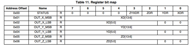

The Microstack Accelerometer has a MMA8491Q Xtrinsic 3-Axis Accelerometer on board (  http://cache.freescale.com/files/sensors/doc/data_sheet/MMA8491Q.pdf  ) so it has 7 registers:
Every time i am reading (via I2C) the data from my Accelerometer i get this:
00000000
01010101
01010100
10101000
10011000
10101111
00010000
ZYXDR, ZDR, YDR or XDR are set 1 if the Data is ready.
So there is no change in Data , could anybody help me?

    On the Microstack Accelerometer is a 3.3V pin where I connected 3.3V from my Beaglebone Black. I measured the Voltage with my Oscilloscope. I read also about the EN pin but there is no EN pin on the Microstack…

    Did you read all the data sheet? To go into ACTIVE mode (to collect data), you need to get Vdd to at least 1.95 volts (check for this with volt meter) and accelerometer subsystem is turned on at the rising edge of the EN pin.
    0 e14 Contributor over 11 years ago in reply to clem57
    On the Microstack Accelerometer is a 3.3V pin where I connected 3.3V from my Beaglebone Black. I measured the Voltage with my Oscilloscope. I read also about the EN pin but there is no EN pin on the Microstack board so I thought that it is connected internal.

    To prove this is good hardware wired correctly based on your assumptions, I would suggest to run this Python code from the manufacture directly.
    https://github.com/microstack-IoT/python3-microstacknode/blob/master/examples/accel-angle-upright.py
    If it works, the Matlab is missing something to set the EN pin on the board internally(?). If it does not workj, I would follow some hardware troubleshooting next.

    I found out, that there are maybe different Versions of the Microstack Accelerometer. On the technical Page of Farnel of the Microstack Accelerometer is the Datasheet of the MMA8491Q Xtrinsic 3-Axis Accelerometer so I thought that this Chip is used.
    However in the Python Code of the Mic.Acc.  i found a Link to this Device: http://www.freescale.com/files/sensors/doc/data_sheet/MMA8452Q.pdf
    So I used the wrong Datasheet... image
