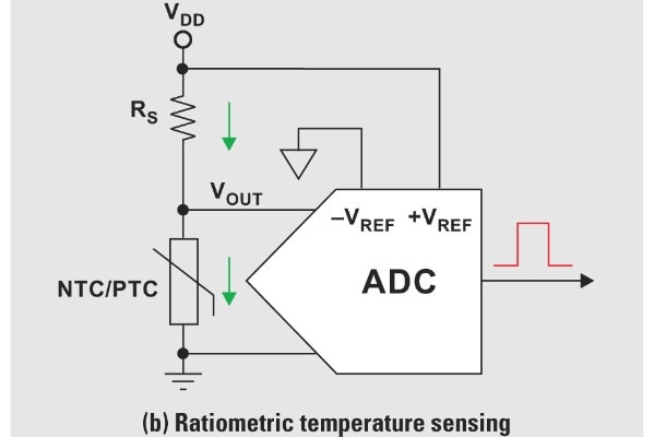

    A second point: do you measure absolute or ratiometric?
    The absolute temp. sensing, the +Vref has a separate ref. voltage.

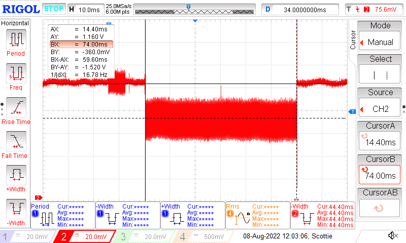

    That isn't necessarily true for low cost CMOS SAR ADC, some low cost ADCs operate on charge redistribution and the sampling capacitor's charge may be lost during a conversion. Here is one sample application note: https://www.renesas.com/us/en/document/apn/r14an0001-operation-sar-adc-based-charge-redistribution-rev100
  • scottiebabe
    scottiebabe over 4 years ago in reply to shabaz

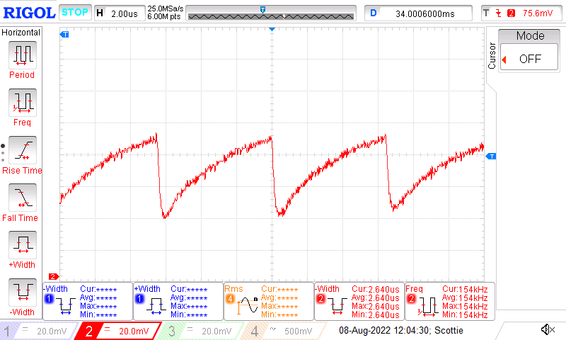

    This is a great project and great work! I have this ADCs little sister the MCP3425, and the input impedance definitely declines to 250 kOhms with the highest PGA and OSR. I input 100 mV with a 100 k series resistor to the in+ input (in- grounded) , and placed a 10x Scope probe on the in+ terminal. During a conversion cycle the ADC loads the 100k source resistance with approximately 250 kOhms.
    The actual sigma-delta sample rate is approximately 154 kHz
