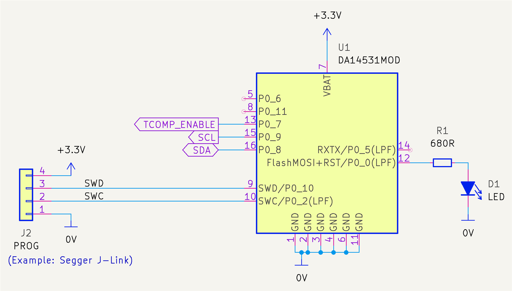

The BLE portion of the circuit consists of the DA14531MOD device, and not much else:

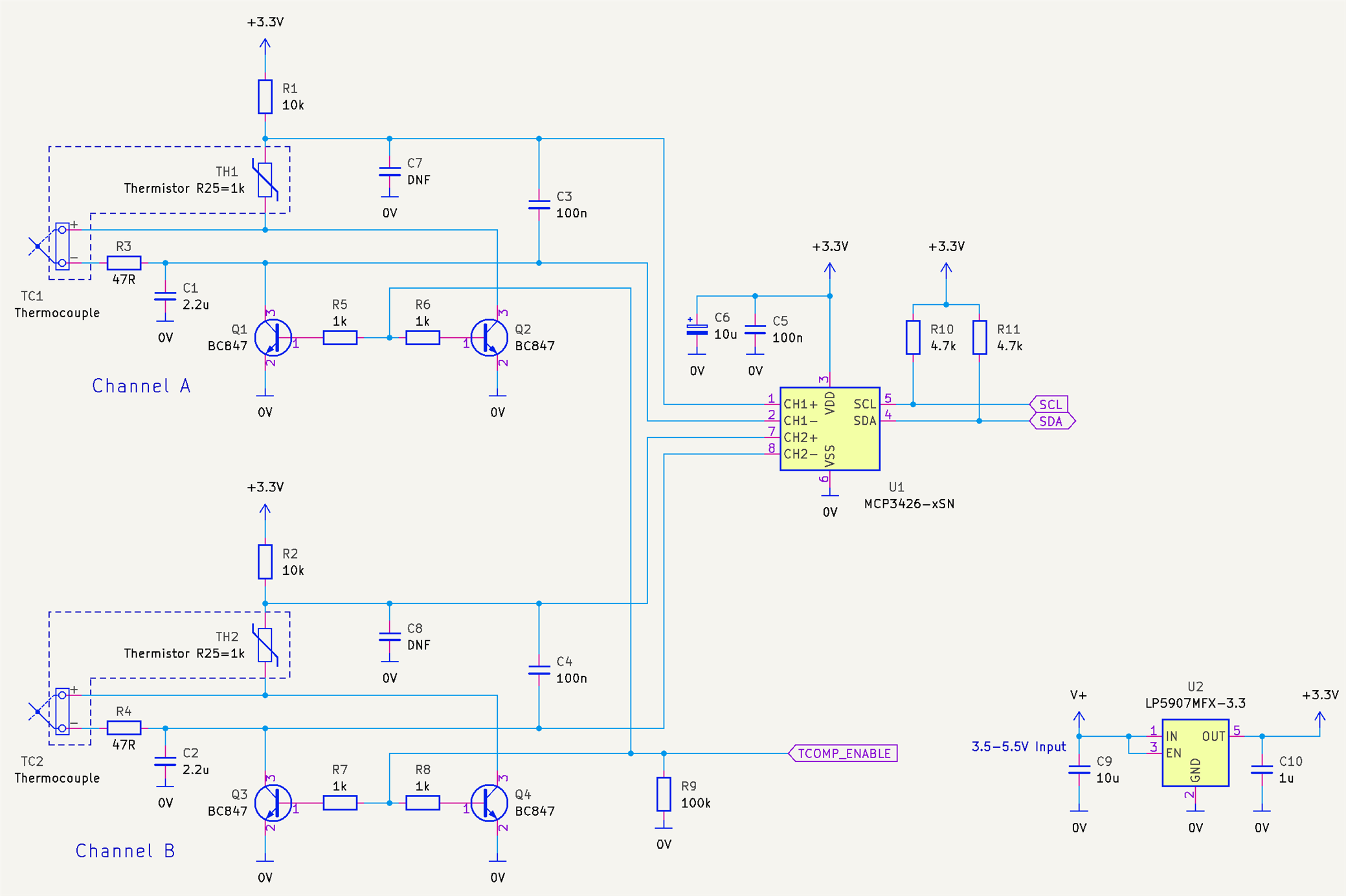

The thermocouple interface creates four channels out of a 2-channel ADC chip, using transistor switching; this allows for two channels to be used for cold junction compensation with thermistors. See the earlier linked discussion for commentary on the circuit.
The thermocouples should be Type K. Any other type will work in the circuit however the code currently only supports Type K.

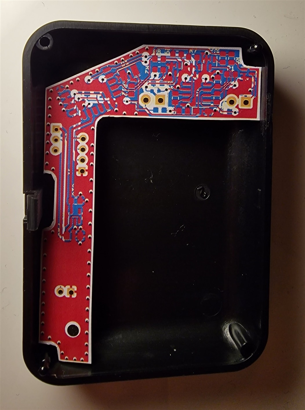

    shabaz over 4 years ago
    I found a nice low-cost enclosure that's the size of a very small bar of soap, but the 3 x AAA batteries take up 80% of the space!
    (It looks better than the photo, especially in black).
    I had to make a paper PCB model just to double-check, since everything is so tight.

    shabaz over 4 years ago in reply to scottiebabe
    Thanks! The temperature here is getting too hot to be bearable outside for long. Still, I'm not complaining (yet)!
    That's a good idea to reduce the voltage. The code has a #define with the voltage, so it would be a very quick change to implement (I used a 3.3V LDO because I had a lot of them).
  • scottiebabe
    scottiebabe over 4 years ago
    The prefect temperature probe for a summer bbq! Great work. You could consider using a lower output voltage LDO, say 2.85V. As you aren't sampling your thermistors ratiometrically, and assume 3.3V is constant. When the LDO goes into dropout your thermistor readings will be slightly off.
    shabaz over 4 years ago in reply to shabaz
