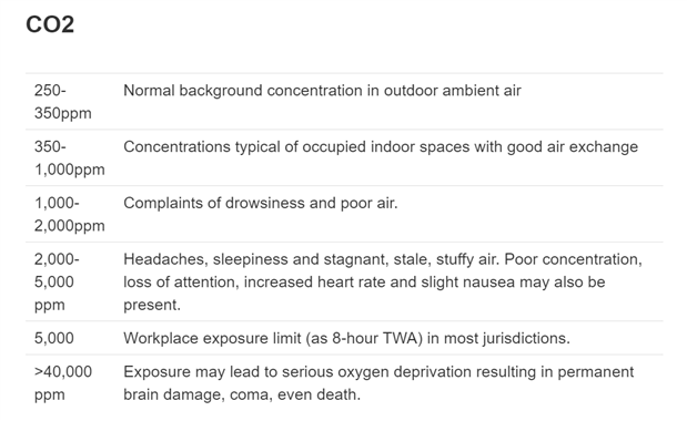

    Here are the levels an equipment manufacturer suggests.. (source kane.co.uk). It suggests that some physical effects are noticeable at that value (5000ppm) and below, whereas you're suggesting the level needs to be 20,000ppm for any detectable effect:

    michaelkellett over 6 years ago in reply to shabaz
    Hi Shabaz,
    Your table is a bit old - the current atmospheric base level is 406ppm:
    https://www.co2.earth/daily-co2
    The other numbers are broadly correct.
