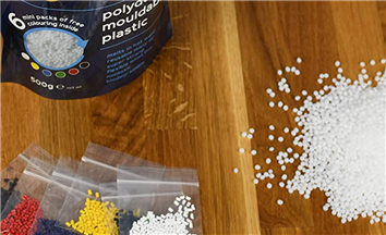

Next, to make the colored plastic blobs, Polydoh was used. If you’ve not used it before, it is like a manual version of 3D printing plastic; it melts at a low temperature and can be formed with ease. It comes as a bag of white granules/pellets and can be purchased bundled with pigment granules too, to be mixed in. It is really cheap – about $15 for a bag containing thousands of granules.
Ordinarily, the granules are supposed to be used with boiling water, but I didn’t want to get my resistor wet, so an alternative procedure was used. I took two granules and placed them on a surface (I used a metal block) and heated it with a hot air tool. After a few seconds, it was possible to place the wire and resistor between the two granules and fold it all around into a kind of pod or egg-shape, using bare fingers (it doesn’t burn the fingers, just feels slightly hot briefly). If it hardens too soon before it is fully shaped, then it can be re-heated with the hot air tool.
If you don’t want white blobs and want to color-co-ordinate with the ‘scope channel colors, then instead of just heating two granules, add a single pigment granule too, and then mash the molten color into the molten granules with fingers, and then (because it will have cooled and solidified) place back on the block and re-heat, and then wrap it around the resistor and form the blob. It’s really easy!

    shabaz over 5 years ago in reply to 14rhb
    Hi Rod,
    If you don't have a 3D printer (I currently don't have one) then I think perhaps you'll love this material. It's unfortunate, the name is very similar to Playdoh, but it's Polydoh: https://www.amazon.co.uk/gp/product/B01MZE4LYK/ref=ppx_yo_dt_b_search_asin_title?ie=UTF8&psc=1
    The normal method is to boil up some water and throw the granules in there, then wait until it gets transparent like tapioca : ) and then fish it out with (say) a stick, and just mould it with hands or push it into position. It cools and becomes rock-hard, and won't easily re-melt if reheated if it is in a large shape, because it's a heat insulator. It is supplied in small granules so they can heat up, either with boiling water or hot air tool. It's non-toxic too.
