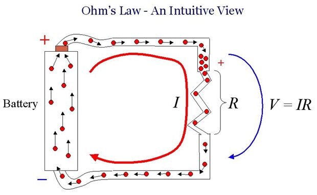

Let’s take a look next at a conductive path and load made of a metallic wire and a resistor, as shown in the figure below:
A simple way to imagine this is to visualize a metal as made of many atoms which each is neutrally charged: the negative charge of the electrons is equal to the positive charge of the nuclei.  This is exemplified in the magnified view of the metallic wire on the right side of the figure.
What is special about metals is that many of the electrons do not stay attached to their atom, they just float around within the metal. This happens mainly due to a thermal agitation force that is higher than the force that attracts these electrons to their atom's nucleus. So millions of atoms have these loose electrons floating around, but still the total number of electrons is equal to the total number of positive charges in the atoms, so the metallic wire is neutrally charged.
Let’s connect now the metallic wire to the battery, as I am showing in the following figure.
From electrostatics we know that particles charged with opposite polarity attract each other and particles charged with the same polarity repel each other.
Based on this, electrons on the negatively charged side of the battery, which tend to repel each other since they are charged with the same polarity, find a way to flow out of the battery through the metallic wire, so they start “pushing” each other through that “exit” path.  As they enter the metallic wire they push the mobile floating electrons inside the metal.  This pushing propagates from electron to electron through the entire metallic wire and resistor towards the positive terminal of the battery, where the electrons are attracted inside by the positive charge of the ionized atoms. Since this flow would eventually neutralize the negative and positive charges of the battery, thus lowering the 1.5V, the "motor" or "pump" inside the battery turns on and pushes more electrons towards the negative terminal trying to maintain the 1.5V potential difference. This mechanism maintains the flow of electrons through the circuit.
So we learned that at a microscopic level of analysis, electric current in metals consists of negative charged electrons that flow in a circuit starting from the negative terminal of a source/battery, passing through the circuit elements, and entering back into the source/battery through the positive terminal.

Ohm's Law is used to calculate the voltage drop on a resistor when knowing the current and resistor value.  To illustrate this let’s look at the figure below:
We know use the analytical model of electric current as consisting of positively charged particles flowing from the positive terminal of the voltage source, through the circuit and back into the negative terminal of the voltage source.  This circuit has a resistor in the path, which we can view as a section of the path that partially blocks the flow of electric current.  This is analogous to traffic on a highway that at some point has a lane closed and cars slow down and accumulates at the beginning of the narrow section.  This is illustrated in the figure above by a larger number of charged particles accumulated at the entrance into the resistor.  Since these particles are positively charged, if we take a voltmeter and measure the voltage between the entrance into the resistor section and the exit from the resistor section we will notice a difference in electric potential due to higher density of positive particles at the entrance.  This difference of potential is called voltage drop on the resistor.  Ohm’s law quantifies this voltage drop as being equal to the intensity of the electric current multiplied by the resistance of the resistor:  V=IR.

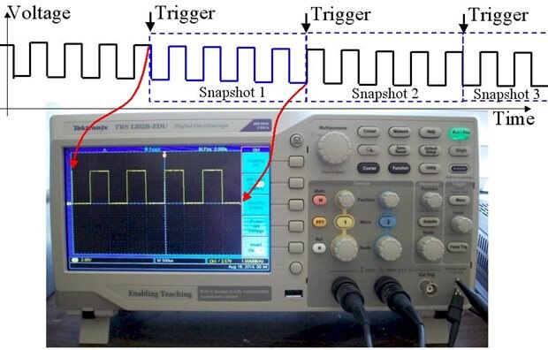

In a very simplistic way, an oscilloscope is an instrument that can be used to visualize how signals vary in time.  The following figure shows the graphical representation of a square wave signal and the image of this signal as shown on the display of an oscilloscope:
We can view the oscilloscope as an instrument that captures successive snapshots of the signal waveform and display them one after another on the screen.  The trigger function of the oscilloscope ensures that each snapshot starts at the same location within the signal period so the image on the display stays stable.  The time base function of the oscilloscope ensures that each snapshot has the same length in time, thus when sequentially displaying these snapshots the image is clear and stable.
In this measurement I used a Tektronix TBS1202B-EDU oscilloscope, which I personally like because it has a crystal-clear and colored screen and offers very useful built-in functions besides the displaying signal waveform.  Some of these functions, like the automatic measurement of signal amplitude, frequency, rise and fall time, RMS value, mean value, duty cycle, pulse width, overshoot and undershoot, performed digitally rather then visually approximating them on the screen help me significantly in design and troubleshooting of electronic circuits.  Also the Tektronix TBS1202B-EDU oscilloscope has a built-in Fast Fourier Transform function that allows signal conversion from time domain to frequency domain, which enables additional analysis and troubleshooting areas like signal jitter components and electromagnetic interference.
