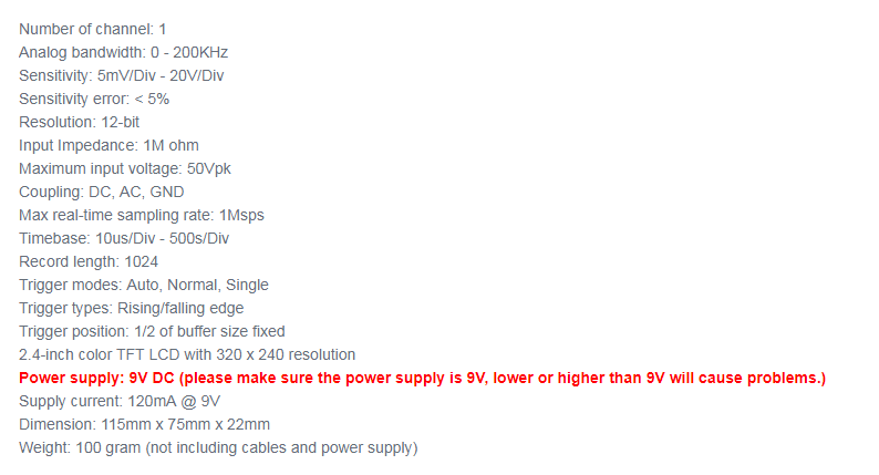

    Hi Scott,
    I have had a lot of fun building a few of these kits. If you have some soldering skills you can't go wrong for $20.99 US. Here are the specs and a link to the vendor.
    https://www.banggood.com/Orignal-JYE-Tech-DS0150-15001K-DSO-SHELL-DIY-Digital-Oscilloscope-Kit-With-Housing-p-1093865.html?rmmds=search&cur_warehouse=CN
    As far as looking at the electronics of video games with a scope you will probable need a better scope and a lot of foundational electronics and software experience to be able to interpret what you are looking at. If you just want a basic scope to look at lower frequencies this kit is pretty great.
