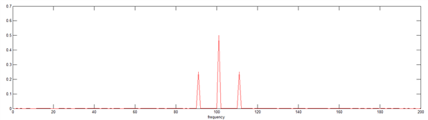

The multiplier has a popular use-case as a modulation device. Here is an example topology for a transmitter. The signal from the microphone is brought up to the correct levels (and filtered/processed for a good quality transmission) for the multiplier which will multiply with the desired carrier frequency. The output is amplified and filtered before transmission. To see how this works, the core of this can be simulated using MATLAB or GNU Octave as before.
For example, if we have a (say) 10Hz signal to represent an audio input (10Hz is low of course but it’s just an example), and the desired carrier frequency is 100Hz, then as before they can be multiplied. The expected time domain and frequency domain output is shown below (10Hz signal is in blue, 100Hz carrier is green):
The purple output above is referred to as double sideband suppressed carrier. An AM signal contains the carrier frequency too. In other words, for AM we want the purple output signal to also contain some of the green carrier signal. We can inject that into the time domain representation of the signal, by an addition:
a=m+c;
By adjusting the level of the carrier, different output occurs. The red and yellow overlaid traces above show the effect of two different levels of carrier.
So, injecting the carrier into the multiplier output has had an effect. The red trace above looks a different shape to the purple trace above it. Again, the frequency domain view will reveal what’s going on:
A=fft(a);
plot(abs(A(1:200))/10000, 'r');
As expected, it can be seen that the signal contains the sum and difference frequencies as well as the original 100Hz signal.
