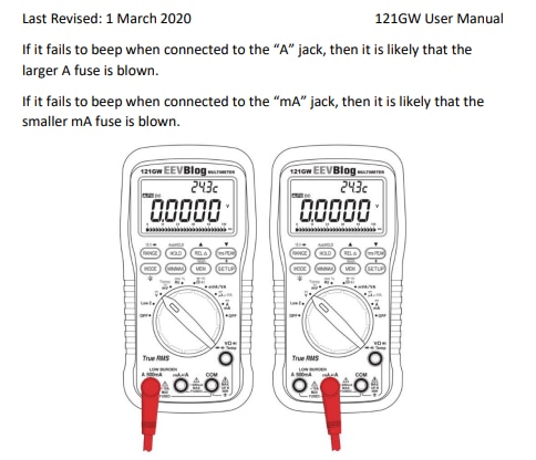

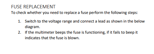

    Hello, is this method of checking the fuses indicated in the user manual valid for other DMMs?
    Jan Cumps over 4 years ago in reply to javagoza
    It is the only meter I ever owned, that explains it this way. I think it would work with other meters that have lead detection ...
