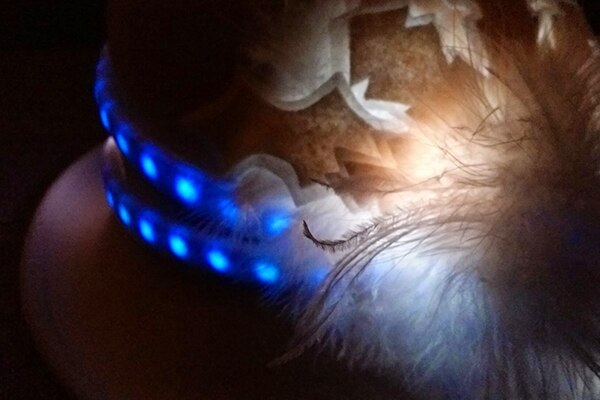

A post with the program.
Here it is, folks. The program for my Christmas Hat! I just want to give a big thank you to my Hunky Assistant, Pierre-Marc, for doing fancy code interpolations and humoring me during the lighting design process. I'm not yet good at enough at coding to have written all of this myself.
One of my favorite late-stage additions to the code is in line 134 below: "return get_tempF_serial();" which I un-comment and use to in order to tell the hat a specific temperature via the serial port. This was especially helpful when working out how it would look at what temp.
Let me know what you think!
