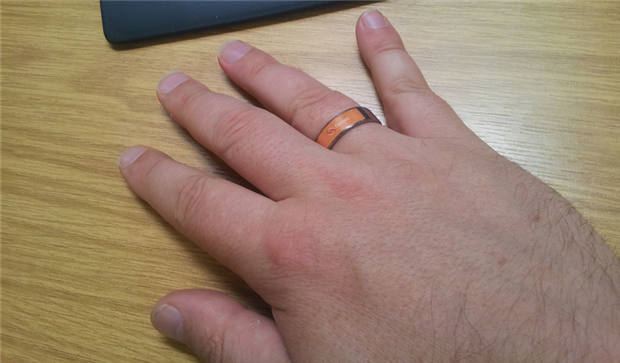

The NFC Ring
The ring itself is solid, titanium and looks good. It has the company name on it, causing my wife to accuse me of being married to the company! Just engaged I say image

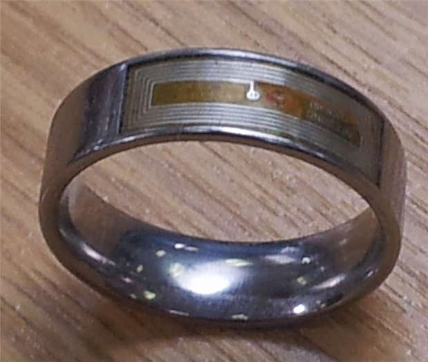

The back of the ring has the magic.
I've worn it solidly since I got it about four weeks ago, and I wear it in the shower, when washing my hands, and also when doing chores. It's got a few scuffs but nothing that wouldn't polish out.

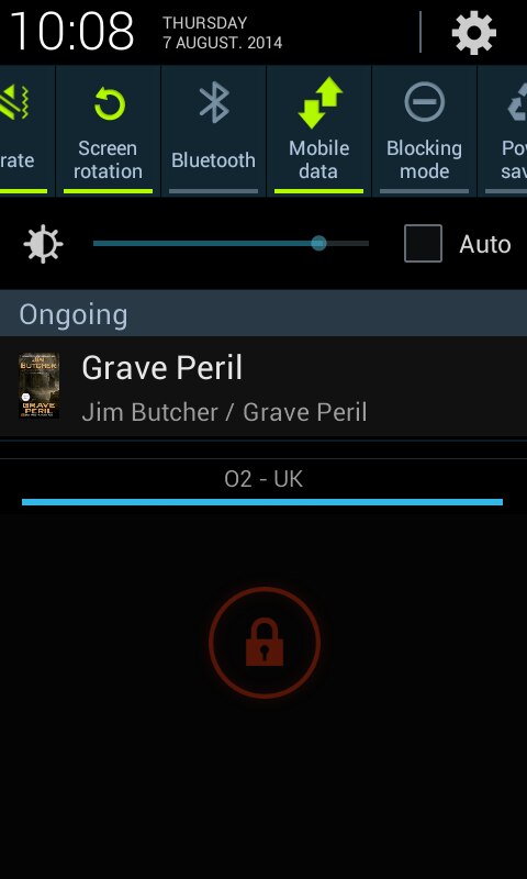

My main issue with the unlock application is that it isn't a lock screen, it's an application that is always on top, and this results in some funny quirks. The first is that I still need to have a lock screen for the functionality that I like on my lock screen. Things like the time and date, and the place for my audiobook client to show pause buttons. So I now have two lock screens, a simple low security swipe lock screen, and then behind that I have the NFC unlock app. You can see this in the video.
I'd prefer this if it was a proper lock screen, with all of the options that I can include on a lock screen. Then I'd have no need for a second locking mechanism.
The second issue is that because it's an application, it can't block system functions. So, for example, with the nfc lock screen up, you can make the status bar appear, and swipe this down to see all notifications and enable and disable system functions. Not ideal - but mostly not significant drama. Certainly not a deal breaker.
What is more concerning is that because the locking app appears always on top - it bypasses the ability to shortcut the lock screen to make a call to emergency services. There is no way to call 999 ( or 911, or 112 ) from my phone at present without knowing how to unlock it - meaning that if I am ever in an accident, people can't use my phone to call an ambulance.
