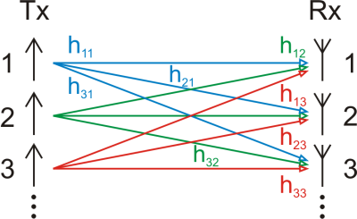

802.11(n) increased speed in several ways:image
  1. It offered the option of channels with just over twice the number of subcarriers.  This makes the Wi-Fi signal occupy 40MHz instead of 20MHz when on the 5GHz band.  (The standard provides for ways to use 40MHz channels on 2.4GHz if the channel is not crowded, but I have never seen this implemented, probably because 2.4GHz is generally very crowded.)
  2. It added MIMO which allows multiple streams to be transmitted at the same time on the same frequency by creating a matrix of channel functions between each TX and RX antenna.  Inexpensive MIMO is the most amazing engineering wonder I know of, but for it to work you need multiple antennas on both sides.  It’s best if they are far apart and differently polarized.  The distance between the transmitter and receiver must not be too large compared to the antenna separation.  The antenna must have some multipath reflections but not have strong reflections delayed by more than the guard interval.
  3. 802.11(n) offers the option of decreasing the guard interval from 800ns to 400ns.
