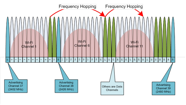

The BLE physical layer divides the 2.4GHz ISM band into 40 channels.  Three of them are dedicated for advertising (finding and connecting other devices).  These channels are located between the commonly-used Wi-Fi channels 1, 6, and 11, with the idea that these frequencies will be freer of interference.  (Wi-Fi bandwidth is 20MHz, but the channel spacing 5MHz, making 1, 6, and 11 the only set of three channels with no overlap.)
The remaining 37 channels are for data.  The frequency hopping algorithm simply increments the channel number by a hop value every transmission.  Since the number of data channels is prime, all channels get equal use.

    gervasi over 13 years ago in reply to craigh@bugsoft.com
    Thanks Craig.  You are right.  It's now changed.
  • craigh@bugsoft.com
    craigh@bugsoft.com over 13 years ago
    Minor correction - BLE has 40 radio channels total, not 39.
