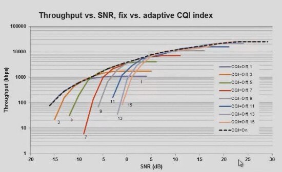

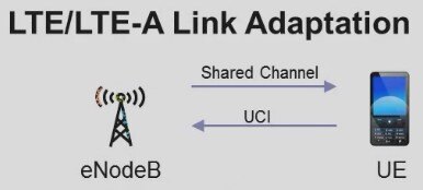

Last week I watched an IEEE talk on LTE “4G” mobile wireless.  Surprisingly, the same fallback issues affect LTE.  They call number of streams “rank”, but the issues are the same.  They address it by selecting the "rank" first and then calculating the best data rate.  The presentation showed how, just as in Wi-Fi, once rank is determined a good fallback algorithm allows a higher throughput (the dashed black line) by selecting the best rate for a given SNR.
I would love to hear from some LTE engineers about how good the fallback algorithm is in practice.  An explosion in the amount of mobile data is in progress. Journal articles I read accept the notion that LTE approaches the theoretical limits of data per unit bandwidth.  If that’s true, LTE must use an excellent fallback algorithm.  During times of congestion, is a base station smart enough to drop a distant user who requires a low data rate in order to share that user’s time slot among five nearby users at a higher data rate?  I have never worked on LTE, but based on my experiences with Wi-Fi I suspect more data can be squeezed into the mobile wireless band by tweaking fallback.  image
