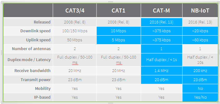

Today, we are at a fork in the road. One path can leverage Gigabit LTE for high-speed applications in retail, enterprise or transportation industries that need to connect sites or people with mains-powered, high bandwidth – and higher cost – solutions. The other path can leverage 4G LTE optimized for IoT applications in industrial locations to connect machines and other critical assets that require low bandwidth, low cost, and low- or battery-power as indicated by the chart below.
4G LTE Evolution for IoT
Each 4G LTE technology has its pros and cons, while carriers considering a roll out of LTE-M or NB-IoT as a secondary network only adding to the complexity. Here’s a deeper dive into the technology options for IoT devices:
  • CAT 1: represents a good fit for many single-device IoT applications with mains-power, such as digital signage and kiosks, industrial controllers and security cameras. It is globally available where LTE is accessible.
  • CAT 3/4: with the potential of speeds up to 100-150 Mbps, this technology is designed for IoT routers connecting multiple devices. However, it may be excessive for most single-device IoT applications.
  • CAT-M/LTE-M: fits traditional 2G-type applications, devices that require mobility, such as asset trackers, as well as battery-powered IoT sensors. Defined in 2016, it is not yet fully globally available, but is predominant in North and Latin American and Asian markets with early LTE adoption.
  • NB-IoT: best fit for battery-powered devices that do not require mobility, such as fixed-asset sensors. Also defined in 2016, it is not globally available as this time, but suits markets with late LTE adoption, like Europe.

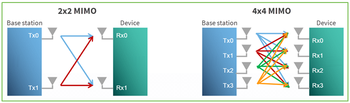

3. More MIMO (Multiple Input, Multiple Output) antennas: think multi-lane highway with traffic moving on two directions (using multiple antennas to both transmit and receive data in parallel). Most devices today have two antennas per cellular modem, while Gigabit LTE devices will require four antennas to achieve higher speeds. For many devices, this means moving from direct-attach to cabled antennas.
