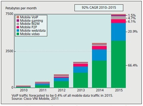

At first I thought of this as just an issue of efficient frequency reuse to minimize unnecessary base stations.  It turns out that mobile data service is approaching what could be called a crisis.  The wireless industry believes wireless internet access has become “viral” and will grow exponentially.  They predict wireless traffic will grow 25 to 30 times by 2015 and 1000 times by 2020.  In some ways this is analogous to the the growth of the internet in the 90s.  The industry has motivations to overstate growth, but experts believe the predictions are reasonable.  image
