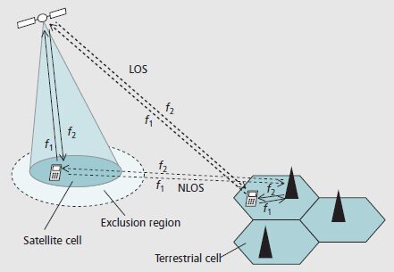

Because of the advantages of having true two-way hybrid systems using satellites and terrestrial sites, in 2004 the FCC began approving ancillary terrestrial components (ATCs) to existing satellite services.  The networks will seamlessly hand off between the ATC and MSS.  Transceivers that use ATC/MSS networks have not been developed yet.  They are not immediately on the horizon because they will face all the difficulties of devices designed for terrestrial sites plus the complexity of satellite transceivers plus the difficulties of integrating the two.

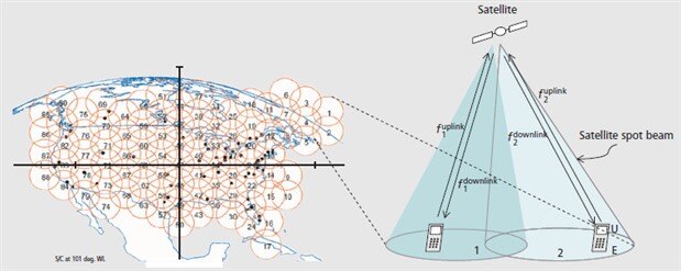

The systems will face the well-known problem of interference between one cell and a nearby cell that reuses the same frequencies and all a new problem of interference between the MSS and ATC components.  The satellites cells could be focused down to a minimum of 100 km in diameter.  The signal strenght does not drop off that rapidly as you leave the satellite cell, so there needs to be an “exclusion region” buffer zone around the the cell.  Complicating cell structure further, the cells boundaries move with the orbit of the satellites.  To overcome interference from satellites, terrestrial sites may use beamforming to make their antenna pattern directional toward each user it communicates with.  Beamforming is a technique that uses several antennas act as a directional antenna focused on any desired direction.  It sounds like something that exists only in MATLAB simulations, but it has been used commercially for years to control the directionality of an array of microphones.  It is also option in the 802.11(n) standard.  Beamforming technology is mature enough.  The devil will be in the details of keeping the system robust against a real-world RF environment with moving users, satellite cells, and interference sources.  image
