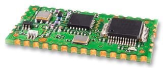

  • vittally
    vittally over 15 years ago
    Hi R_Phoenix,
    What about a transceiver with a size of 16x32mm like this one: http://uk.farnell.com/adeunis/arf7580aax-un/module-rf-twimo-mp868/dp/1847388 ?
    Cheers,
    Laurent
