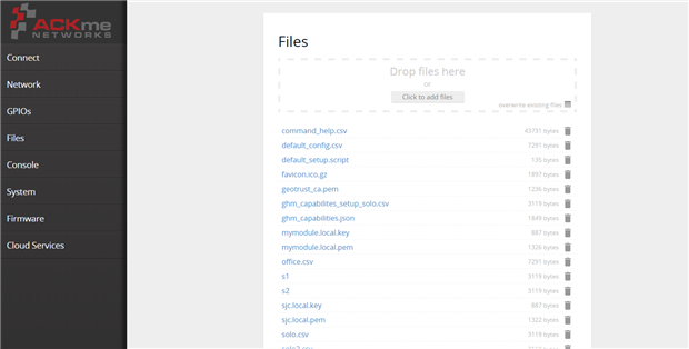

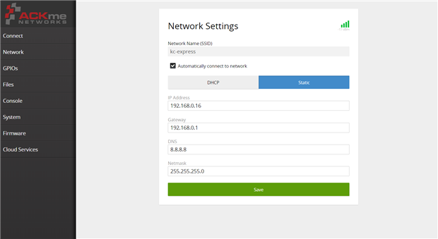

WiConnect 2.1 provides the following new functionality as well as general improvements and stability enhancements.
WiConnect is designed for use wiith ACKme's Wi-Fi modules
§  Secure HTTP webserver with RESTful API and Websockets that can be used on the wireless softAP or WLAN client interface. The web server enables 100% wireless control and data exchange with the module using a web client such as a phone, tablet or PC. See Networking and Security, HTTP Server REST API.
§  A responsive web application based on the WiConnect Javascript API library. The web app may be 100% customized to suit end-product requirements. The new WiConnect web app includes a web console and graphical drag and drop file browser.
(Sample Screen Shots)
§  Device discovery to enable network clients to discover ACKme devices and WiConnect services (such as the HTTP webserver), and enables WiConnect to discover services offered by network servers. The discovery protocol supports various protocols including mDNS/Zeroconf, LLMNR and Netbios. See Networking and Security, mDNS.
