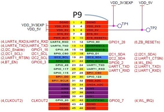

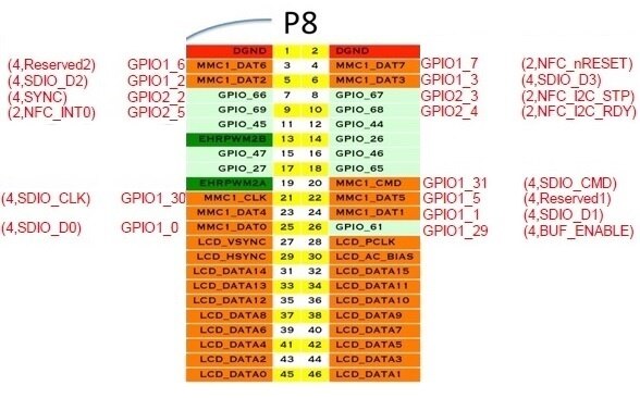

    I dont think Official schematics are available. From the man thread I got these.
    but good thing is datasheets of all ICs used on the cape are ablv at ti.com so image
    Hope this helps image

    0 alan.chapman over 7 years ago in reply to jomoenginer
    Thanks Jon
    I cannot see anything in your links that will help me understand
    - what the functions of the jumpers are on the cape
    - nor the functions of the secondary headers.
    Of course the main headers are common across BBB, but which ones are not used and therefore expose the functionality of the underlying BBB iimage

    0 alan.chapman over 7 years ago in reply to gsgill112
    Thanks GS
    The cape has secondary headers and jumpers, but i cannot locate any specific documentation on their purpose or function
    Can you kindly provide the link to the source document for the pin out provided?
