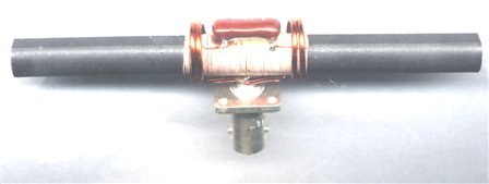

I know this sounds archaic, but I have a local public radio station I love listening to, on the AM band.  There are times when there is little static interfearance and times when the static overwhelms the broadcast.  Who can I consult about clearing up AM signal reception by improved antenna or damping interfearance from other sources (? dirty utility line current)??

    Improving reception of medium wave broadcast stations. The reception of medium wave broadcast stations has become worse for several reasons. The receivers that are sold nowadays still have the possibility to tune to the medium wave band. The quality of the AM-part of most receivers is not better than that of the cheapest portable radio. With modern techniques this could be much better. With a communications receiver the reception is much better. However, the filters in most modern communication receivers are too small for high fidelity reception. While the performance of the receivers is decreasing, the interference levels increase as a result of the use of digital circuits, switched mode power supplies, energy saving lamps, digital motor control etcetera. In some areas the interference levels are so high that the reception of medium wave broadcast stations is almost impossible. But to solve your problem, what can you do? Most man made noise is distributed mainly by the mains wiring. Even at a short distance of a building the reception is much better. Using an outdoor antenna will help. Coupling the antenna signal via isolated RF transformers prevent common mode ground signals to enter the receiver. Ferrite rod antennas can be connected to a coaxial cable, using an extra winding of one or two turns. Big antennas are not necessary, the signal strength is high. Unfortunately the noise level is also high. A receiver made before 1970 or an old car radio is sometimes much better than a modern receiver. You could decide to build your own radio or improve an existing radio. High sensitivity is not important. Narrow bandwidth and high dynamic range are. The use of a synchronous detector in stead of a simple diode detector will reduce the unwanted signal output. Signals in the upper sideband and signals in the lower sideband that are not related to the carrier are reduced this way. In some radio receivers the coupling capacitors are too big. The result is that small clicking noise pulses with high amplitude are rectified in the RF and IF amplifiers and temporary change the bias voltages setting of those amplifier stages after each pulse.  This way the small pulses are widened and distortion will occur. Replacing those capacitors by capacitors with a lower value might help. Resulting noise pulses can be clipped or cut out using a noise limiter or noise blanker circuit. As you can see there is a lot to improve. I hope this information will help you to improve the reception of your favourite radio station.

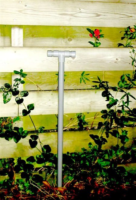

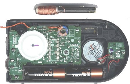

    It is possible to modify a radio with a ferrite antenna into a radio with a connection for an external antenna. To do this, you have to remove the ferrite rod and replace it by an inductor with the same inductance. I did this using a small ferrite ring core. After the removal of the ferrite rod I measured the inductance of the coil and the tap. I wound the ferrite ring core to achieve the same inductance. I did this so well that it was not necessary to realign the radio. The photograph below shows how this was done. On top of this photograph the ferrite antenna that is no longer in use. The red wire is the coupling winding to the coaxial cable.
    For reception of a single station it is possible to use a fixed tuned ferrite rod antenna, connected to the receiver over a coaxial cable.
    This antenna has a sharp minimum that can be directed to a noise source.
    The photographs below show the construction of this antenna. Two coupling loops are connected in parallel. So the capacity to both ends of the tuned coil is about the same.
    The outer sides of the coupling loops are connected to the screen of the coax.
    If the construction is symmetrical, electrical fields have no influence on this antenna.
    The other photograph shows the weatherproof construction of this antenna in my garden.
    But a loop of wire with both ends connected to the coaxial cable will also do. You can even install the antenna up to one feed below the ground.
