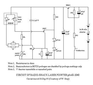

Hi every body,
I am looking for a driver circuit for a laser diode. Does anybody have circuit map of it?
  • Eavesdropper
    0 Eavesdropper over 14 years ago
    Here is a scematic for a typical laser pointer:
    What are the specs of the laser diode you are using?
    E
