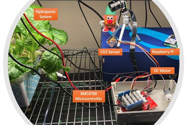

Now, the 1 meter of Pi setup is like this !
I would like to add a couple of sensors for this 1 meter of Pi system with Arduino compatible board.
1. CO2 Sensor
2. DC motor for air pump to the hydroponic system
3. Water Level Sensor - Non-contact liquid sensor is interesting!
4. Fan control for pollination (still researching)

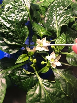

2.2 Green Peppers

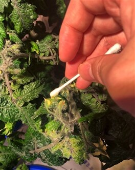

I wonder how to pollinate green peppers and tomato inside space rockets. They are usually self-pollinate plants by wind and bees. I just helped them using cotton swabs.
2.3 Tomato

A bit Painful Experience to get Raspberry Pi to work with Arduino Compatible Board (ex: Infineon XMC4700 Relax board)
1. (Fail) Install Arduino on Raspberry Pi
This is a typical Arduino installation. However, this actually ended up installing the Arduino in an old 2017 version. The problem with this is we cannot use a 3rd party board package for Arduino.
sudo apt-get update
sudo apt-get upgrade
sudo apt-get install arduino
2. (Fail) Instal the Arduino ARM 32-bit version from Arduino Website: https://www.arduino.cc/en/software
// Extract tar ball and source the installation file.
tar -xvf arduino-a.b.c-linux64.tar.xz
cd arduino-a.b.c/
sudo ./install.sh
However, installing board package for Infineon XMC microcontroller board failed. Another fail ! This method probably works with pre-installed Arduino compatible boards, though. So, this problem is on my side.
(3) (Success) instal Arduino package on Platform IO with VS Code.
This method finally worked on Raspberry Pi after many hassles image
The instructions for downloading board package and installing library are summarized in the link below.
https://green-scientist.com/2020/08/08/infineon-xmc4700-relax-lite/
Good thing about VS code is cross-platform between different operating systems. Even raspberry Pi OS which is ARM 32bit based (I didn't try the 64-bit version), this worked fine for my case.

    Thanks for the suggestion. I now have one (good or bad) idea just to try out to see if it works - use a (servo) motor and string to shake a stem and branches once a while.
    Really appreciate your comment. Will give it a try and report out soon.
    Satoshi
  • ilvyanyatka
    ilvyanyatka over 5 years ago
    Interesting project!
    I pollinate my tomatoes (if I don't want hybrid) by tapping branch with my finger right under the flower. Branch and flower are shaken, pollen is released. I wonder if it can be done mechanically and controlled by Arduino or PI. Like shaking the whole plant or dragging a net over it so all the branches are shaken.
