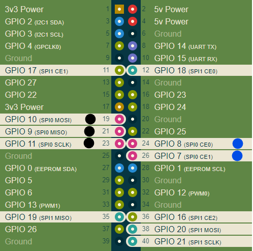

On RPi there are 2 SPI busses:
  • SPI0: GPIO 7, 8 as CS pins and 9, 10, 11 as common pins
  • SPI1: GPIO 16, 17, 18 as CS pins and 19, 20, 21 as common pins
Our two HATs use SPI0 bus for ST7735 LCD display. They use common GPIO 9, 10,11 (marked black) and these are safe to share between both displays
But they also both use same CS pin GPIO 7, and we have two CS pins available on SPI0 (GPIO 7 and 8) so one of them should be switched to GPIO 8.

Clashing pins
As a result of research these are the only clashing pins:
GPIOEnviroAutomation HAT Mini
7SPI CSSPI CS
12Display BacklightOutput 2
20I2S Serial Data In (microphone)Input 2

Enviro GPIO 7
This is one of a SPI0 bus CS pins (we have two available), so we will move it on Enviro to other available CS pin GPIO 8. On Automation HAT Mini it will stay the same.
Important thing here is to change that pin in the Enviro example code (ST7735 initalization).
Enviro GPIO 12
This one is used on Automation HAT mini as an Output 2 pin, and on the Enviro for display backlight.
On Enviro I will switch that pin to GPIO 25, it's the same pin Automation HAT Mini is using for backlight (it can be shared)
