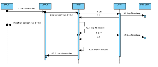

        • WF3.py -- Maintain the right amount of Light for the Growing Container

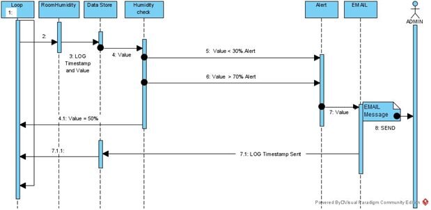

        • WF4.py -- Try to keep the Growing House Humidity level at 50%
          • The Code -- WF4.py

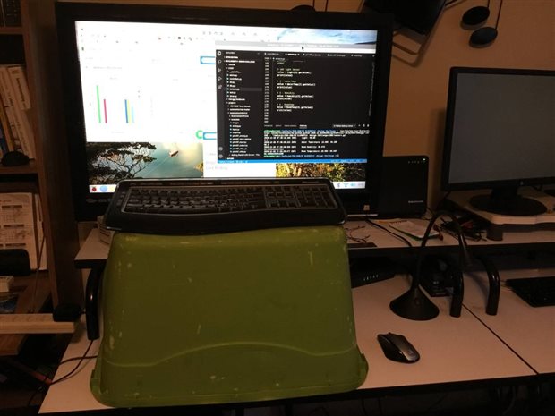

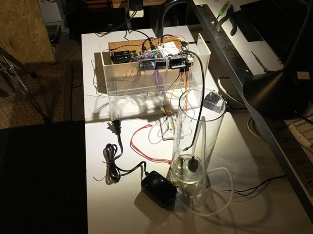

Growing House and Growing Container

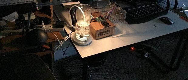

Hear is the Growing House. A storage bin I had around the House
I needed to have a controlled environment to contain the PI Control unit and Growing Container
I'm using a wireless keybord and mouse with one of my televisions that I use as an HDMI monitors.

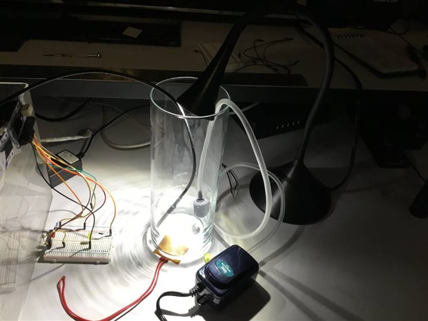

And here is a top view of what is underneth the Gorowing House Storage Bin
THe Control unit and growing Container

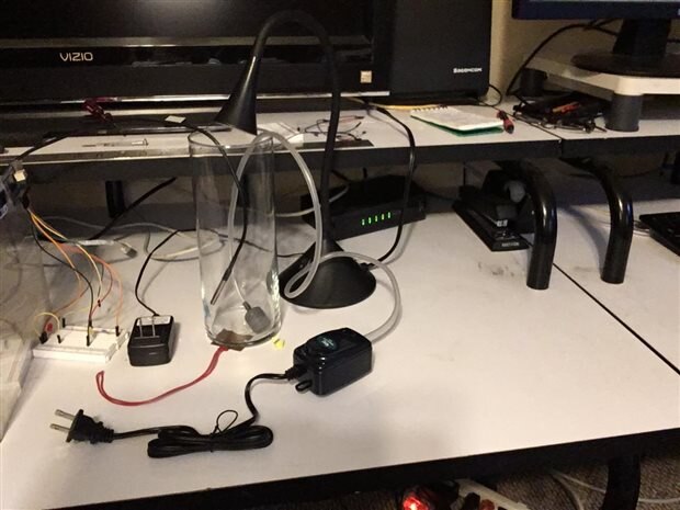

Showing the PI Control Unit on the Left hand side.
And the Growing Container with the waterpub, HeatingPad and Lamp on the right hand side
ANother perpective of the Growing ContainerRight Side Perpective
Left Side Perpective
Closer shoot of the Growing Containr with the lamp on

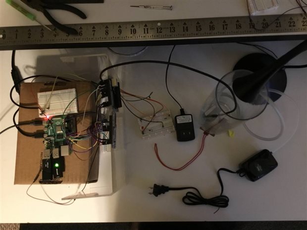

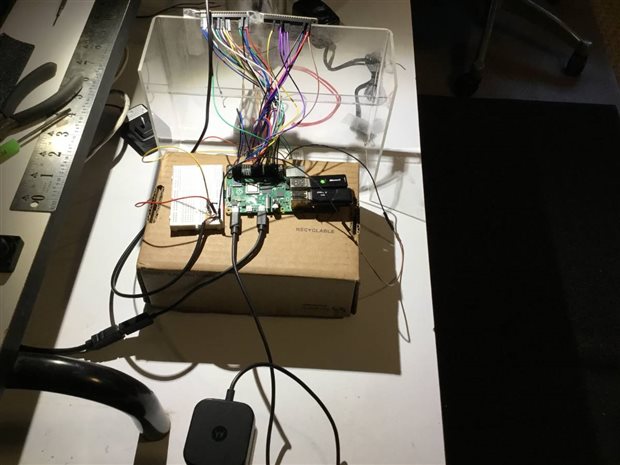

Also shows the LED test circut I used to test the Automation Hat Controler Output channels

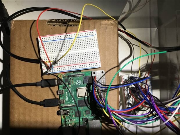

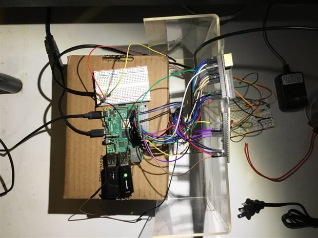

Top view of the Control Unit
Showing the PI, with the 2 hats attached.
A breadbord that has the Waterproof tempreture sensor atached
and if you look real close, a breadbord used as a junction box for PI shared pins.
A close up shot with a little better shot of the Junction box between the PI and the Hats

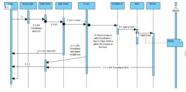

    • WF1.py -- Make sure the room light is operational
    • image
      • THe CODE -- WF1.py

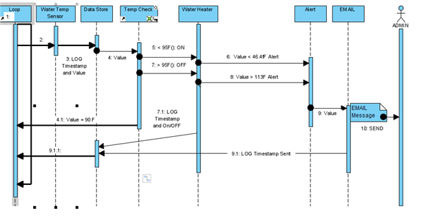

    • WF2.py --  Maintain the Water Tempreture to 90F
    • image
    • The CODE --  WF2.py
    • image
    • The CODE -- WF3.py
    • image

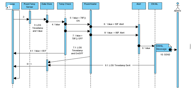

    • WF5.py  -- Try to keep the Growing House Tempreture at around 70%
    • image
    • The Code -- WF5.py

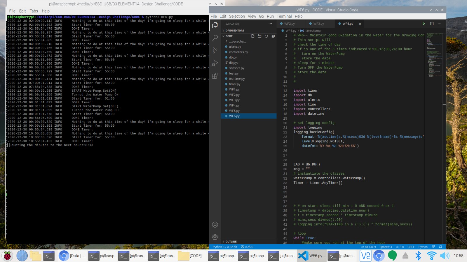

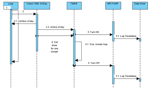

    • WF6.py - Maintain good Oxidation in the water for the Growing Container
    • The Code -- WF6.py

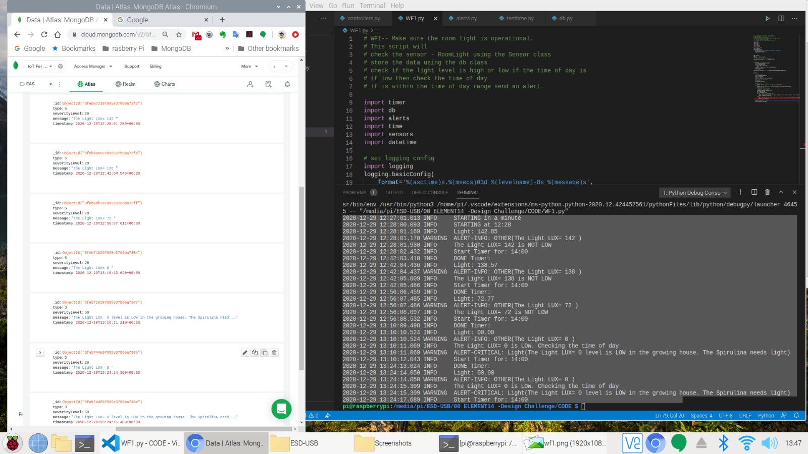

    • WF1.py-- Make sure the room light is operational
      • In this screen shot I show the test run of the code I ran the test for about an hour starting at 12:28 on december 29 2020.
      • you can see the alerts collection too the left with the alert messages.
      • image

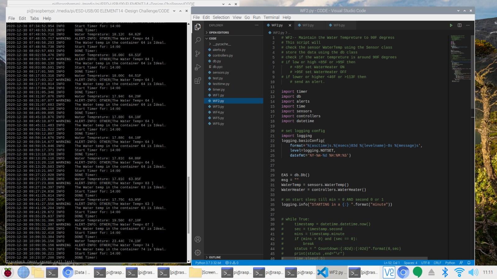

    • WF2 .py--  Maintain the Water Tempreture to 90F
    • Test run --  December30 2020

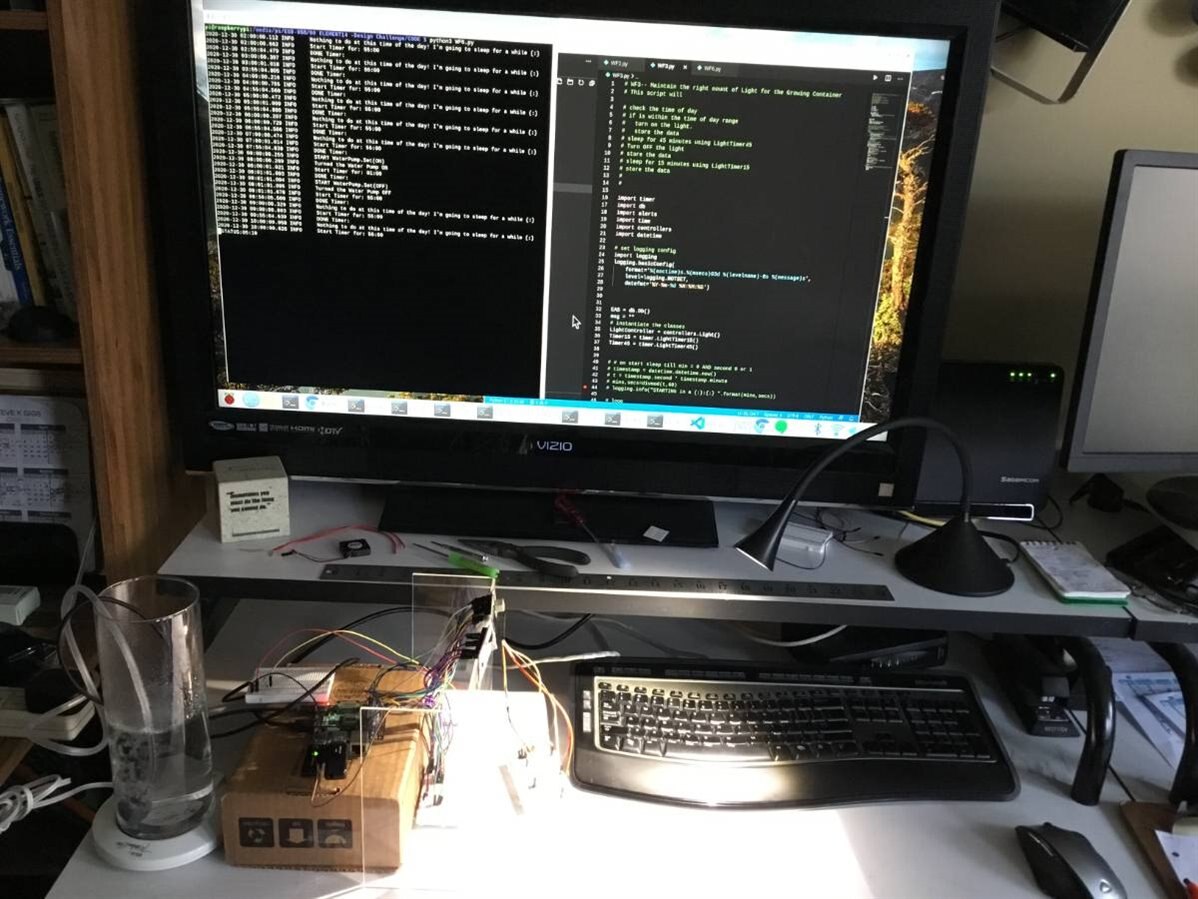

    • image

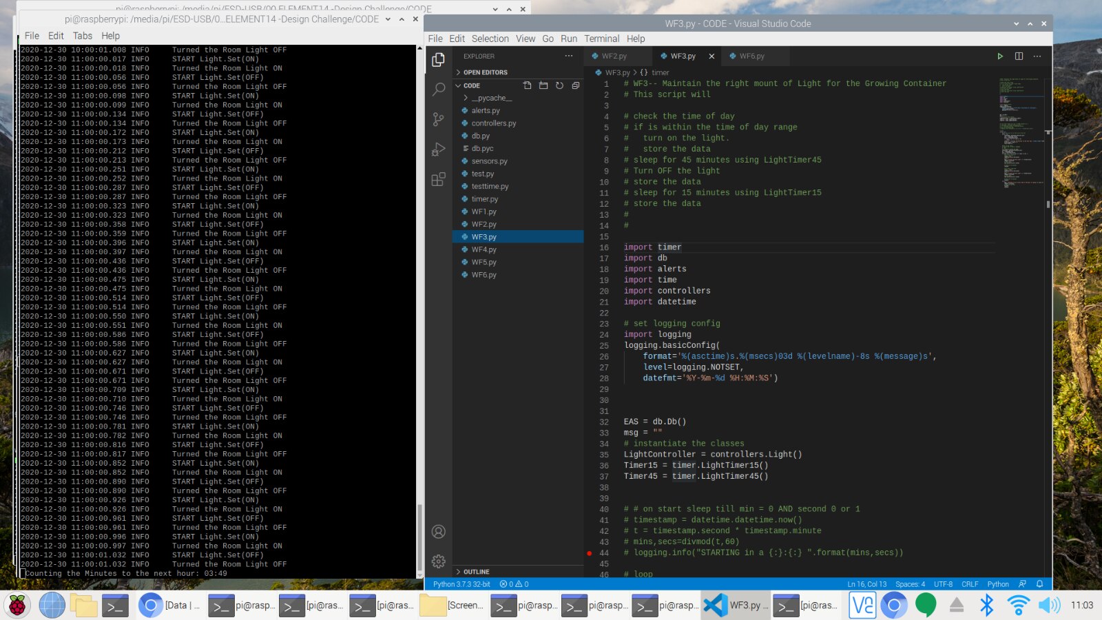

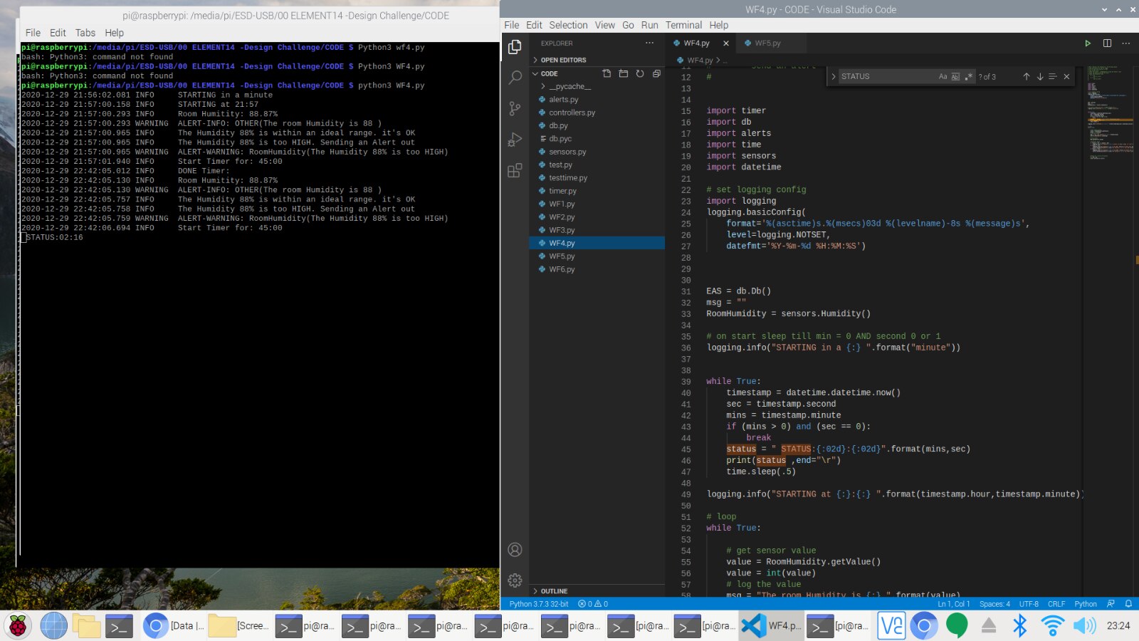

    • In this screenshot I show the terminal window running the script on the left hand side.
    • The VS code editor with the code is on the right hand side
    • I'll be coming up with some reports and charts using Mongodb atlase for this test run
    • image

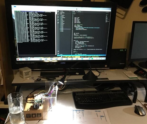

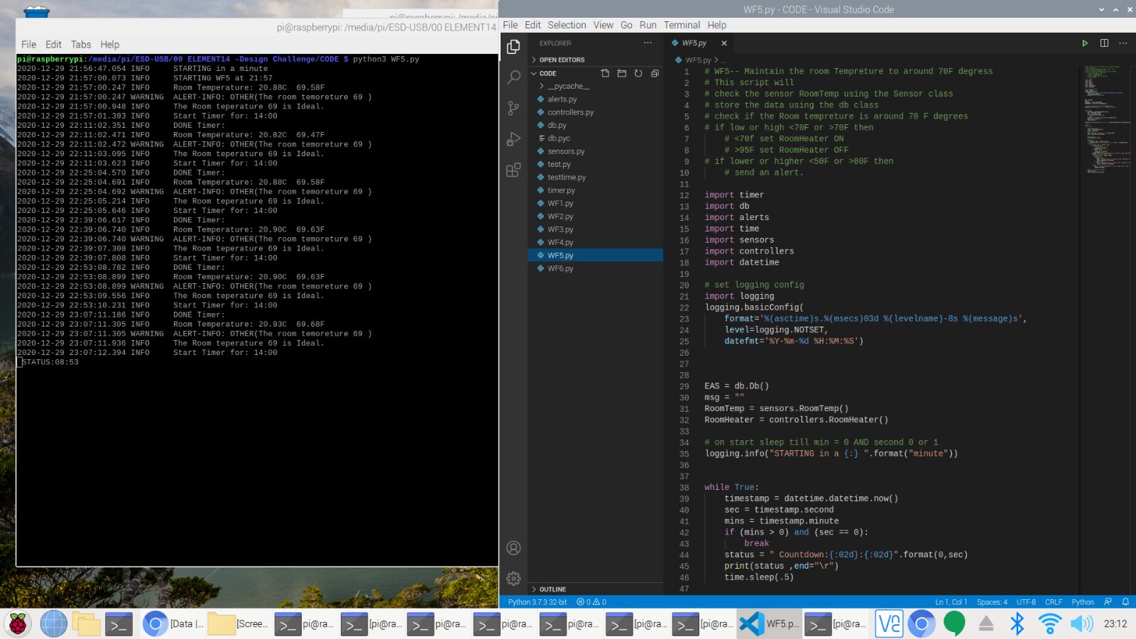

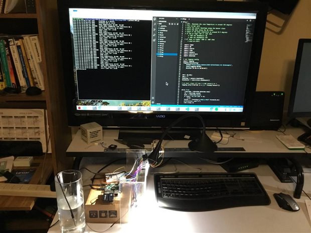

      • image
    • WF6.py  -- Maintain good Oxidation in the water for the Growin
    • image

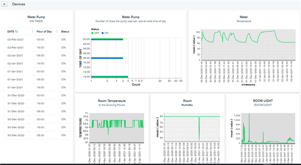

Monitoring The Test with Charts and Reports
  • This section will be used to display charts on the test data. in order to analyze the test run for the scripts
  • MongoDb Atlas Charts will be used to build charts
  • Charts
Updated
EAS Dashboard
This is the Atlas Charts Dashboard that I created to display the test data. In each of the following section, I have display the chart  in the Chart editor for each Script.

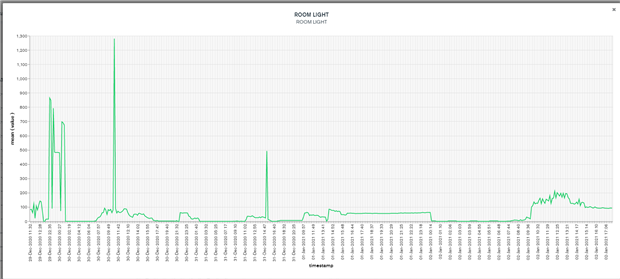

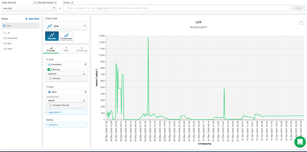

This chart shows the room light Intensity Levels in LUX

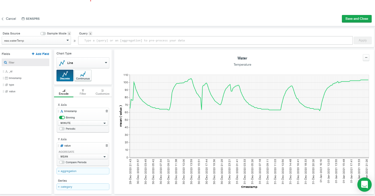

WF2.py --  Maintain the Water Temperature to 90F
Here is the editor view using the collection waterTemp
Notice the temperature going up and down with the heating pad going down
I shut the system down on new years eve December 31 an brought it back up on January 1, 2021.
Notice the gap in time between those dates.
. Looks like the light was out overnight to give the Spirulina a rest.

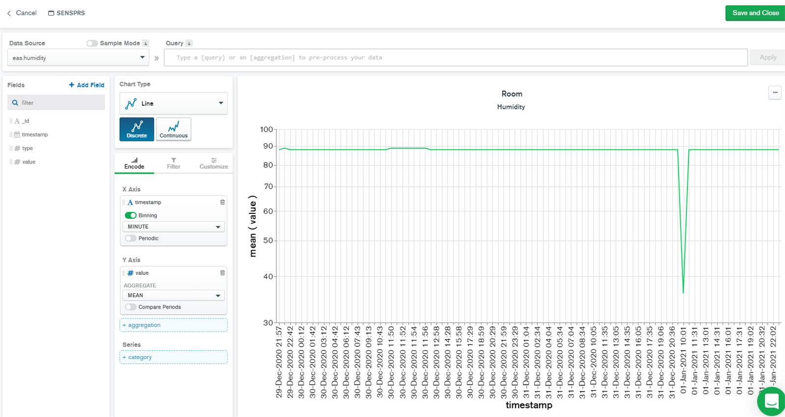

THe humidity over the 3 days pretty much layered around 88%

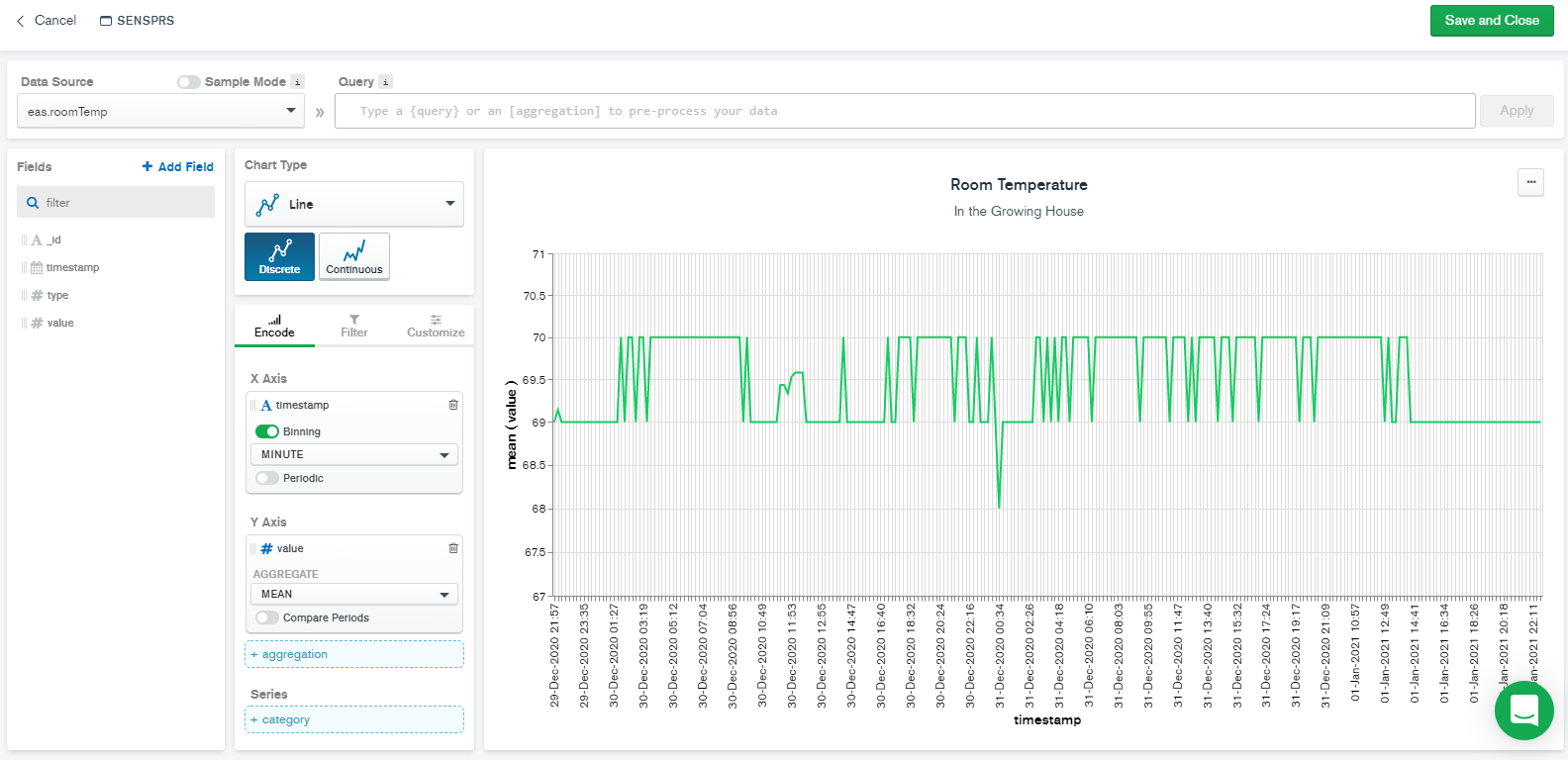

WF5.py  -- Try to keep the Growing House Temperature at around 70%
The Room Temperature did not change that much over the 3 days of testing. The chart shows that the temperature ran between 68 and 70 degrees Fahrenheit over the test time period

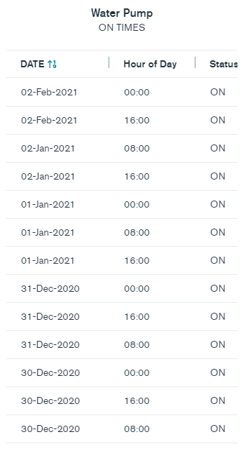

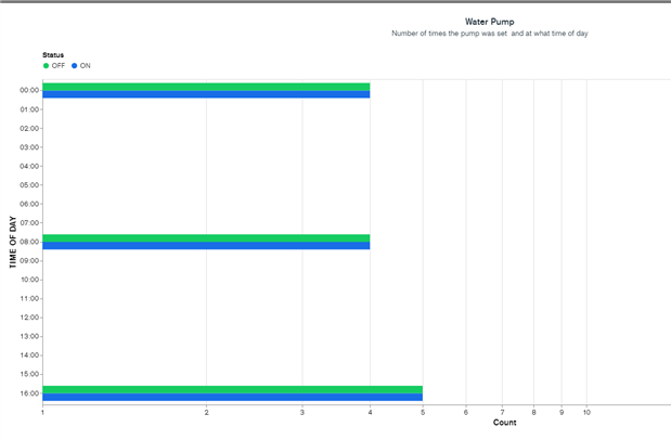

This report, shows the Date and Time the Water Pump was turned on
The Water Pump should come on 3 times a day. This chart will show the number of times it was set to OFF and ON. Midnight, 8:00 and 16:00.respectively.

  • I was a little short on getting the Automation HAT connected to my 6 devices.as described in my Design
    • My design called for these devices to be switched on and off, as different conditions happen in both the Growing House and Groewing Container.
    • I could not get the lamp, pump and heating pad to work at all?
    • I'm not real familiar with Power circuits and I think there might be too much load for the Hat Output channel. It works with the Test circut using an LED and a Resistor. If anyone has experience hooking up these devices to the hat, It would help me get over this hurdle.
    • I'll need to do some more experiments with the Automation HAT Mini. The other hat has more power and relays, I might give it a try.
