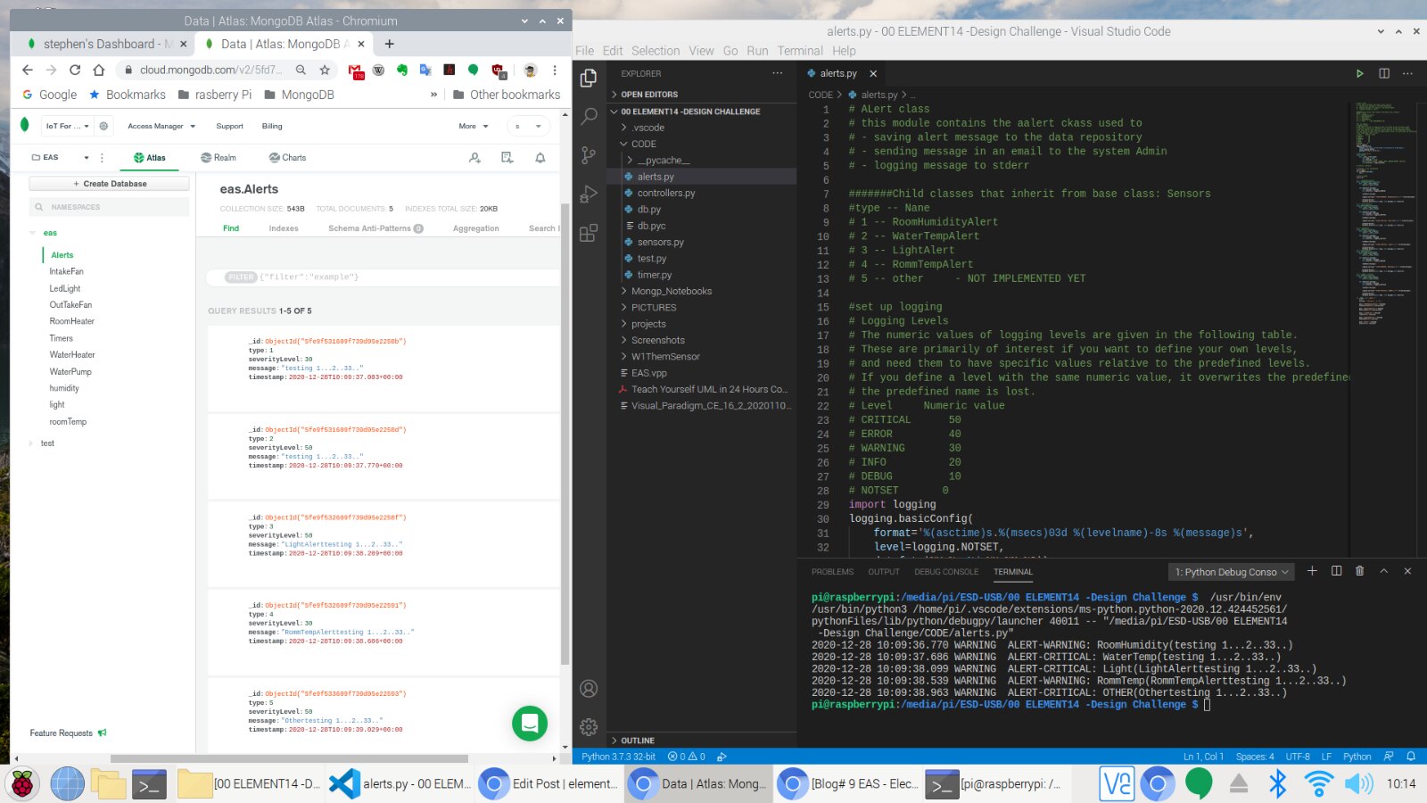

TEST run and results
  • the following screenshot shows:
  •      THe Visual Studio run of the test script
  •      The test run output is display in the Terminal window beneath the code.
  •      the Mongodb Alerts Collection is displayed on the left, indicating that the data was saved properly.
  •      Later section in this blog will display the test run in this format.

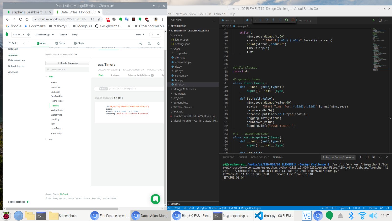

Timers
timer.py
--CODE

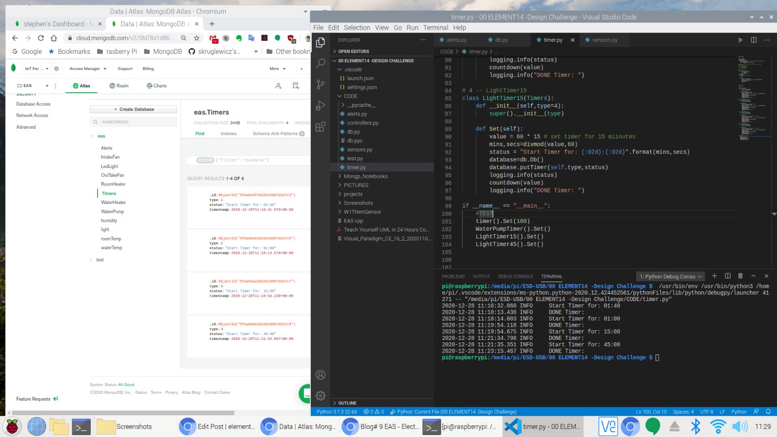

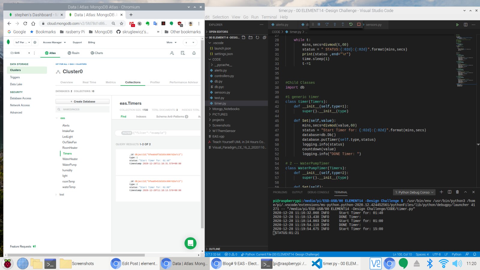

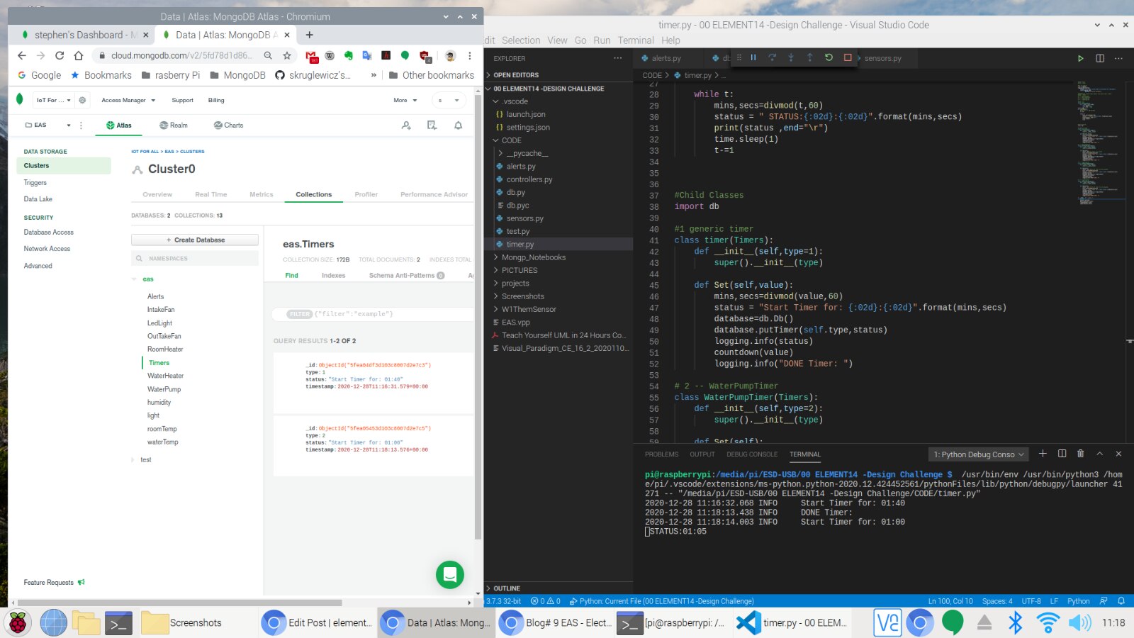

  • Test 1
    • Showing the first timer being set and the data saved to the collection Timers
  • Test 2
    • showing the second timer running and the data added to the colection Timers.
  • Test 3
    • Showing the third timer running
    • I did not refresh the data collection screen, so the data in the clolection is not displayed. It will be displayed in the next screenshot.
Test 4
Showing the forth and final timer running
And the 4 documents in the alerts collection view on the Left.

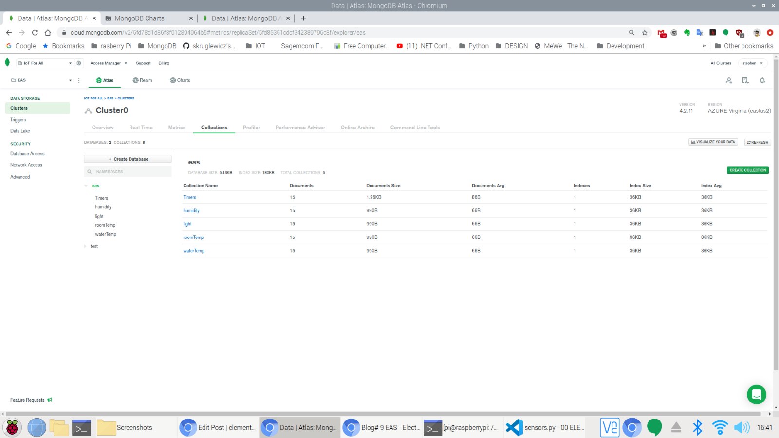

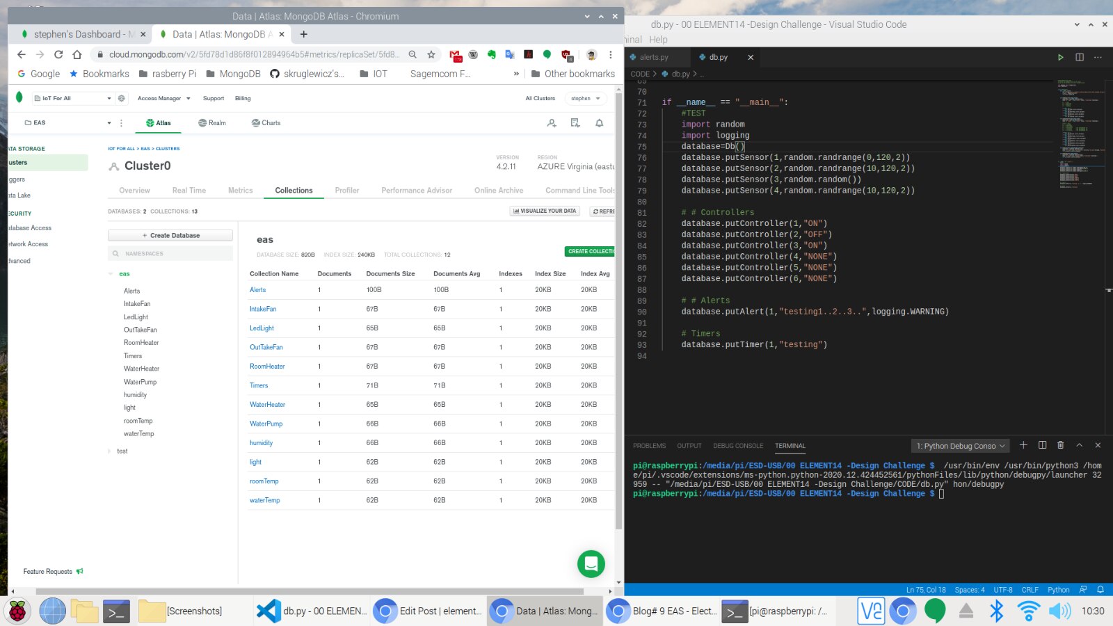

  • Test 1
    • THe run of the test THere is no logging in the out.
    • The MongoDB database list is shown on the left. It list all the tables created in the script. showing on document for each.
    • I stated out with an empty database before this test run(I deleted all the data in the database)
    • It should be noted here, that if a collection is not present in the database the insert statement will create it and put the data into it.

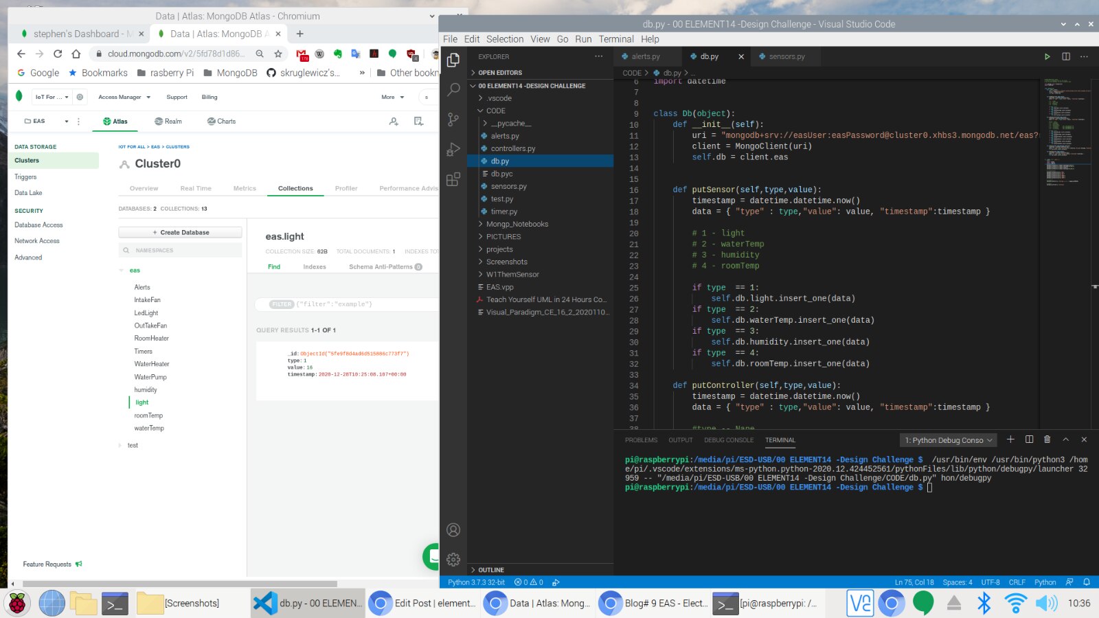

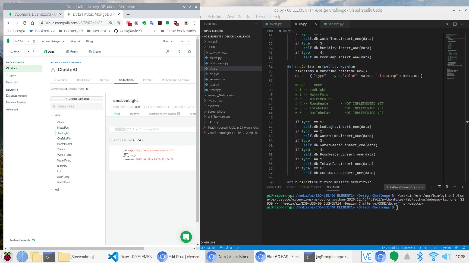

  • Test  2
    • I wanted to show the putSensore() method in the screen
    • I'm displaying the Light collection with the docuent inserted from the test run
  • Test  3
    • I wanted to show the putController() method() in the screen
    • I'm displaying the LedLight collection with the docuent inserted from the test run

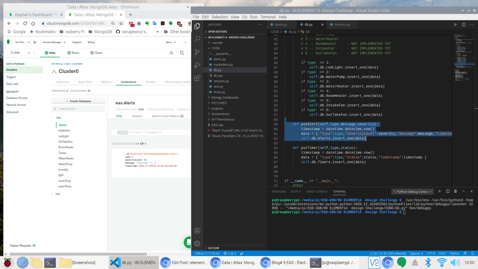

  • Test  3
    • I wanted to show the putAlerts() method in the screen
    • I'm displaying the Alerts collection with the docuent inserted from the test run

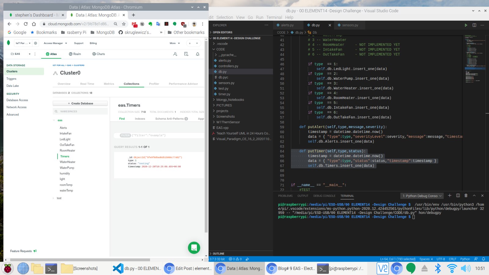

  • Test  4
    • I wanted to show the putTimer() method in the screen
    • I'm displaying the timers collection with the docuent inserted from the test run

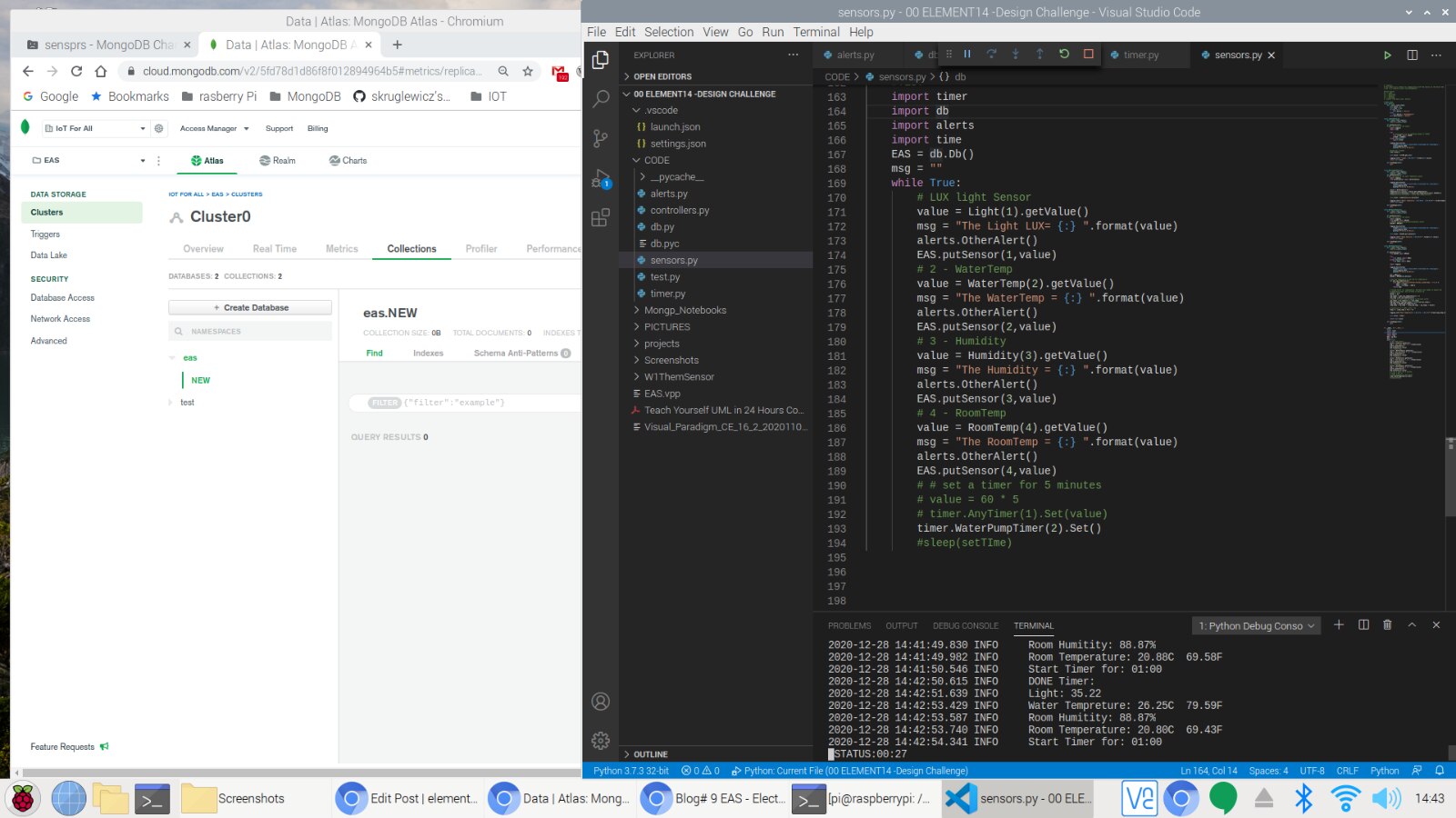

  • Environ Hat  -  the three sensors used for:
    • Roomtemp
    • RoomHumiidity
    • RoomLight
  • Water temp Sensor used for:
    • WaterTemp

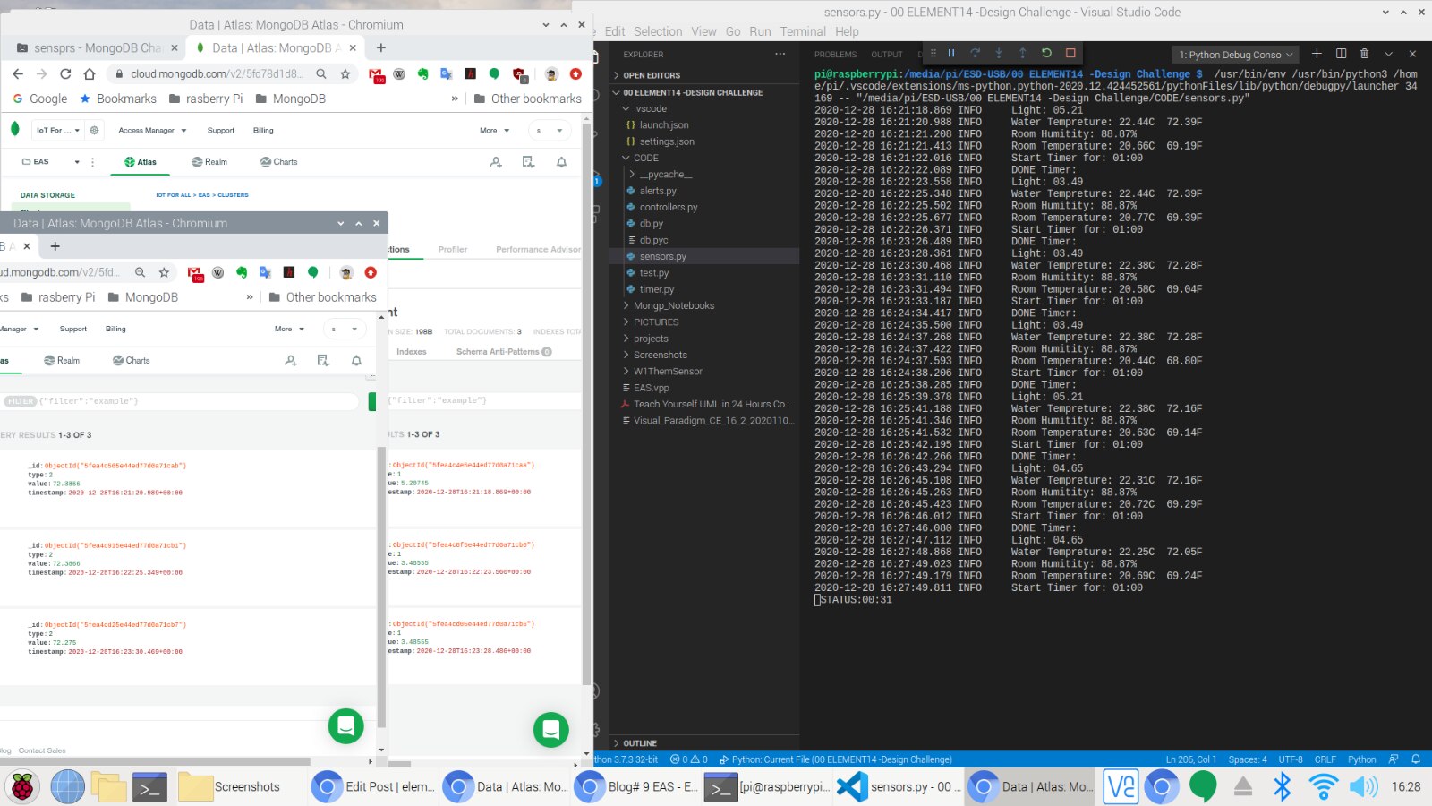

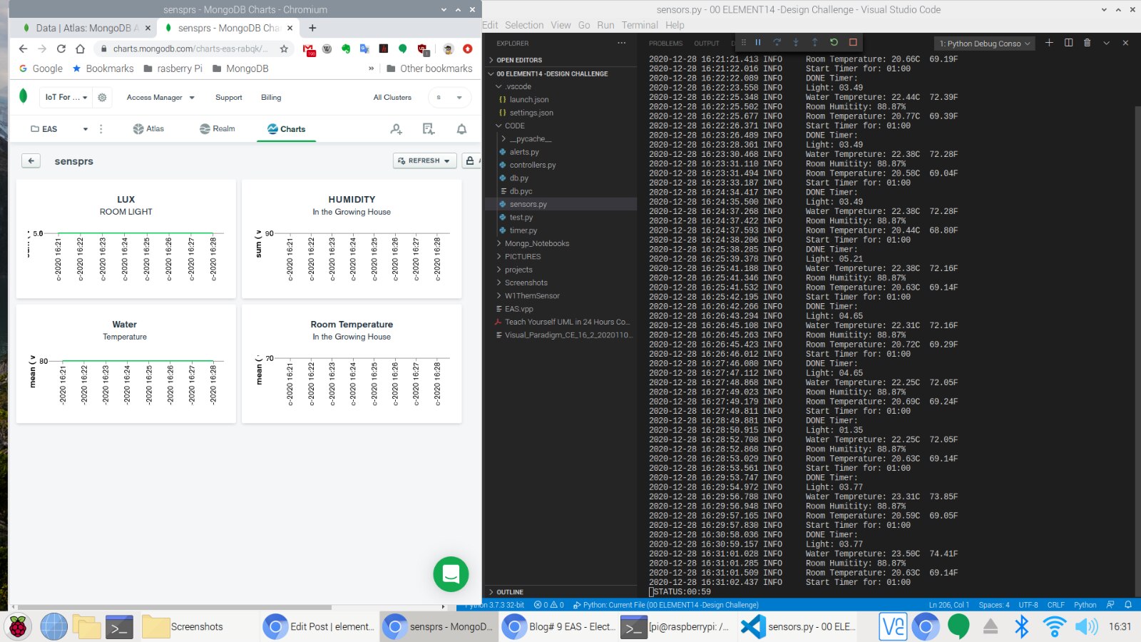

Test 1 the start of the test run
Test 2
I let the test Runn for a little while acumulating documents
Test 3 Atlass Chart Dashboard
Test 4 -- Document list
showing the number of documents in each sensor collection.

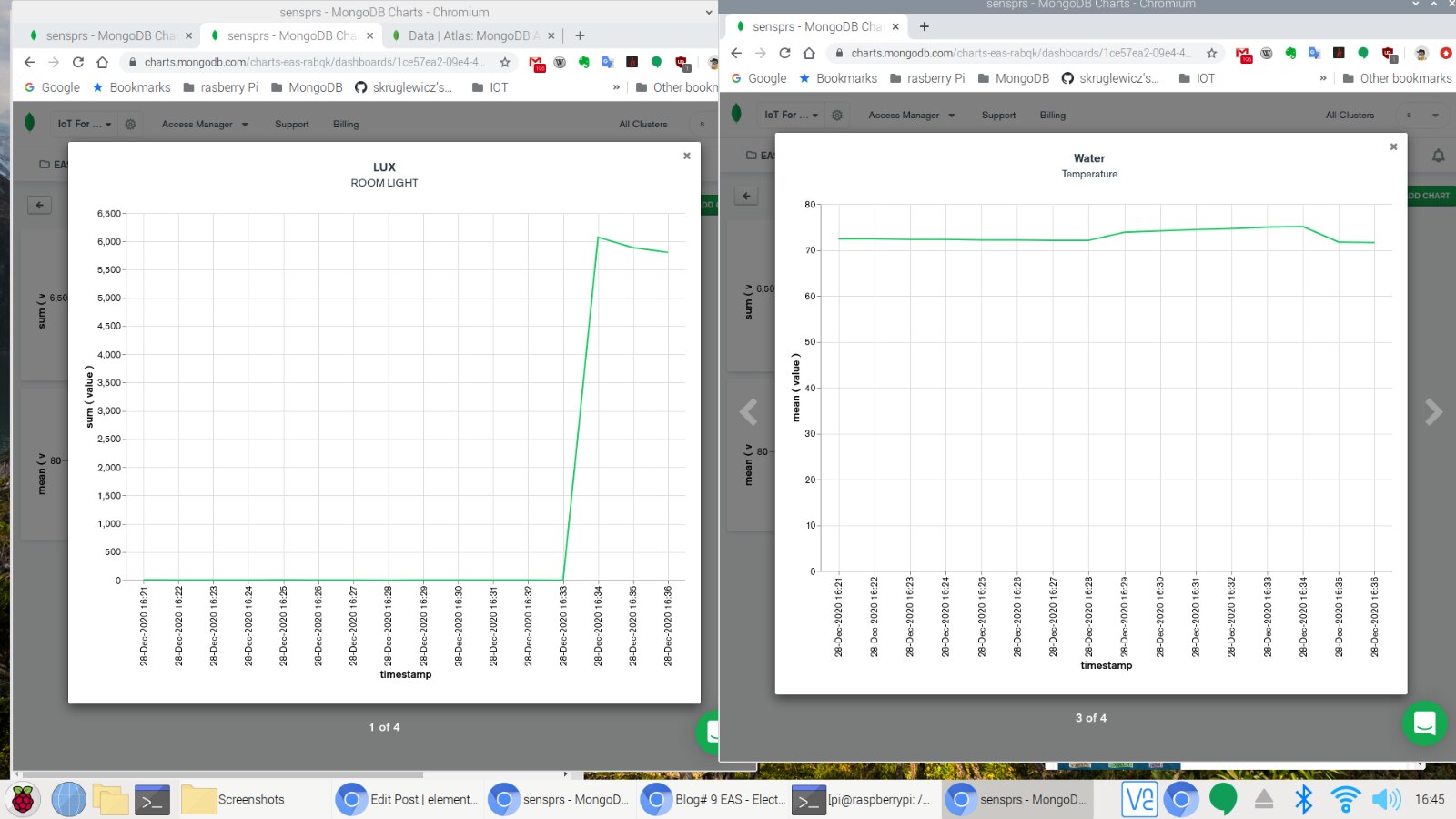

Test 5 - Atlase charts
Showing the Roomlight and the Water Tempreture during the Run

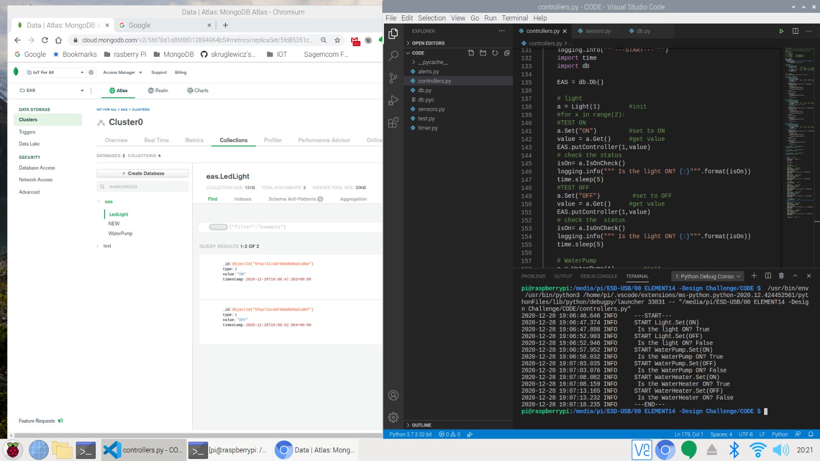

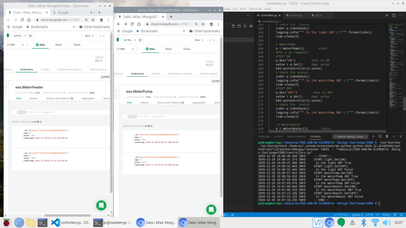

The following  video will show the controller test running and turning ON and OFF the Test circut LED.
Notice that the LED does not light for WaterPump on output2 even though the driver status indicated it's on.?
I spent a while trying to figure out why but had to move on.
  • AutomationHat -- output 1-3
    • LEDLight               output1
    • WaterPump           output2
    • WaterHeaterPad   output3
    • There was not enough outputs for these devices, so they are Not implemented yet. But the classes are included.
      • RoomHeater
      • IntakeFan
      • OutTakeFan
  • TEST 1
    • the Light section of the test script is displayed
    • Shows the entire run with the  LedLight collection display with the 2 documents with the on/off times
  • TEST 2
    • The waterpump test script is shown
    • the WaterPump and the WaterHeater collections are displayed on the left.
