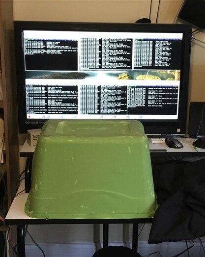

Prototype Operation
  • Here is a pictorial of  my prototype, that I  implemented based on my design..
    • I had to cut up the original video into these pieces, because it was too large.
  • It is running the 6 Python scripts that  were used to implement my design. These scripts are described in more detail in the previous blog.
    • They are each running in a terminal window on the PI.
  • The Breadboard next to the PI, is handling the Waterproof sensor, located in the Glass container
  • The other Breadboard, is used for the Automation Hat Output channels, for the Heating Pad, Light source, and Water Pump
  • The Glass container contains the spirulina culture used to grow the algae.
    • It also contains the hose and air stone attached to the pump, for Oxidization.
    • And, the waterproof Temperature sensor.
The 6 scripts running

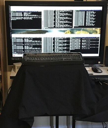

What's underneath the Green storage Bin?
It's the Growing house. I decided to shroud it with  black peice of fabric.
The next group of video's will show what is under the storage bim
Ok , here is what is under the storage bin.
Since I'm planning on using the Lamp as the only source of light in my basement, I wanted to cover the entire thing with something. This way, the growing environment is totally self contained.
The Monitor will be used now so I can experiment with everything, but eventually, a headless PI , ould be accessed remotely using VNC or @PuTTy  from a PC. or another PI.
