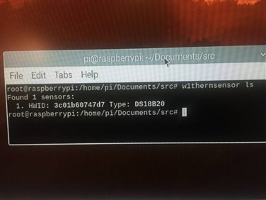

Testing
you can check the connection from the command line
List all available sensors:
$ w1thermsensor ls

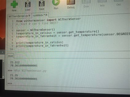

The CODE
here's the code that worked for me
import Unit from w1thermsensor but this did not work for me
from w1thermsensor import W1ThermSensor
sensor = W1ThermSensor()
temperature_in_celsius = sensor.get_temperature()
temperature_in_fahrenheit = sensor.get_temperature(.DEGREES_F)

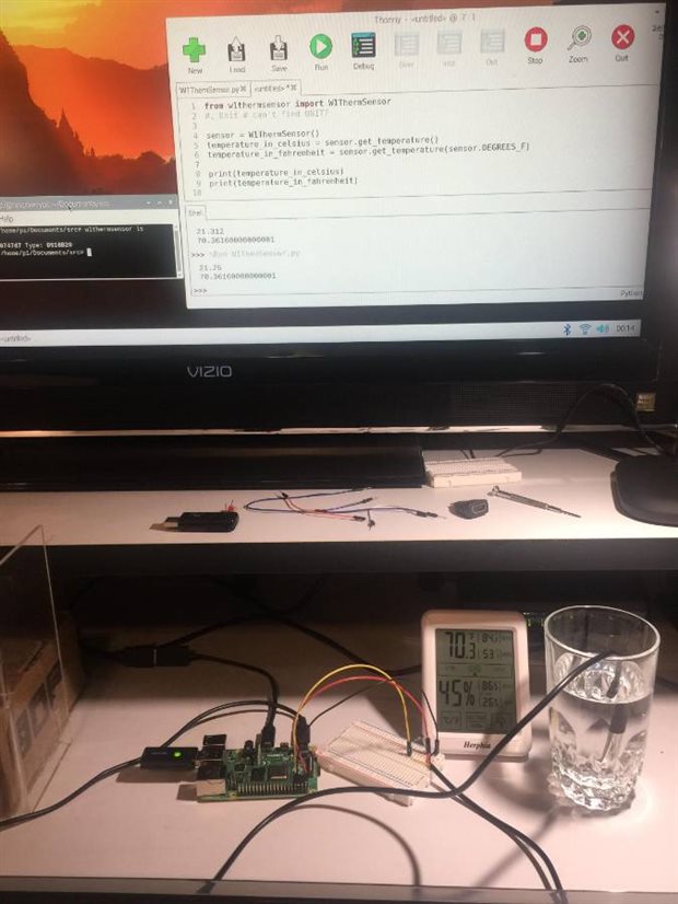

here it is running
The water in the glass is almost the sane as the room here. a cowincidence.
SUCCESSThis sensor works great.
