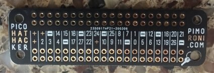

I'm not sure if I will get to use the PIM 300 PICO HAT Hacker yet since it appears like it requires soldering. My soldering skills are not great, so I might pass. It would be nice to be able to stack the 2 hats on one PI.
It would be nice if Pimoroni had a product that had the Header already soldered onto the board for me.

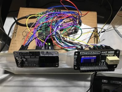

Updated
Since first writing this blog, I have Used the Pico as a guide to GPIO PINS, and I used header wires to make the connection. I seems to hold the Pico In place
You can observe it being used later on in this blog.

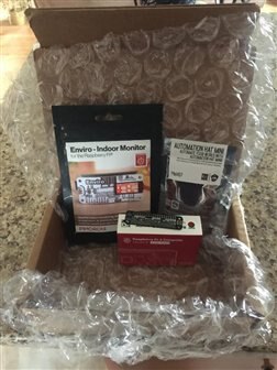

Unboxing
  • My package arrived on Monday, November 2,2020 @ 1:30PM Eastern Standard Time.
  • Thank you,  #danzima danzima  for your efforts.
  • The following images will tell the story of the unboxing.
  • The Challenge kit came delivered in a box via UPS from Newark.com
  • Inside the box contained the components of the Challenger Kit.
  • Each component was contained in separate packages except for the Pico Hacker, which came loose in the box.
  • The box was lined with shrink wrap..

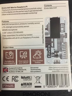

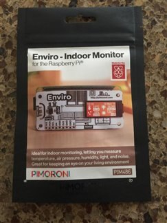

  • The Enviro HAT model PIM486, came in a nice black shielding bag, shown on the left.
  • Very poppy labeled package.
  • The board was wrapped in a shrink-wrap bag for added protection.
  • The back of the bag, shown on the left, has:
    • a description of the board
    • Features of the Board
    • Product Ideas
      • Portable for data mapping
      • How noisy is your office?
      • Tiny weather station
    • Contents of the bag
    • the Address of PIMORONI
      • With with help links and support email
      • Get Started
          • https://pimoroni.com/enviro
        • Technical help:
          • https://forums.pimoroni.com
        • Got a Problem?
          • support@pimoroni.com

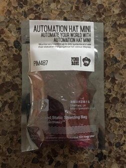

  • The Automation HAT Mini Modell# PIM487 came in Static Shielding Bag shown on the Left.
  • The packaging is not a poppy as the Enviro Hat package, but sufficient to keep the board from static..
  • The back of the package shown on the left, has the link to the Hat Mini page:
  • https://shop.pimoroni.com/products//automation-hat-mini

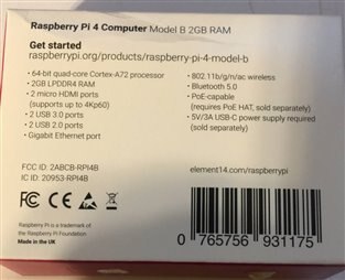

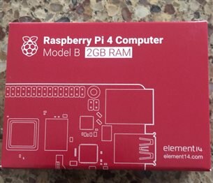

  • The Raspberry PI 4 Model B 2GM RAM comes in a nice red box, shown on the left.
  • The back of the box has a get started link:
  • https://raspberrypi.org/products/raspberry-pi-4-model-b
  • It also list the great new features of the PI 4.
  • The PICO Hat model# PIM300 did not come in a package.
  • It has no instructions on how to attach it to the PI.
  • There is limited information on the PIMORONI site as well.

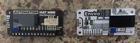

Here is a Front view of the PIM487 and the PIM486.
More on this later in this blog

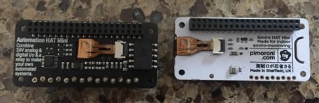

Here is a Back view of the PIM487 and the PIM486.

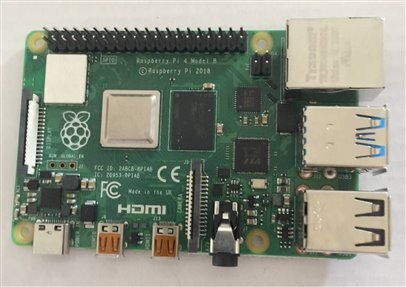

Here is a Front view of the Raspberry PI 4 B

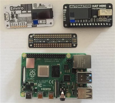

Here Is all the components in the Kit.
From left to right:
  • PIM486
  • PIM487
  • PICO Hacker
  • PI 4 B
Each Section that Follows will describe how the PIM486 and PIM487 fit onto the PI 4 B and how to do a quick test on the hats

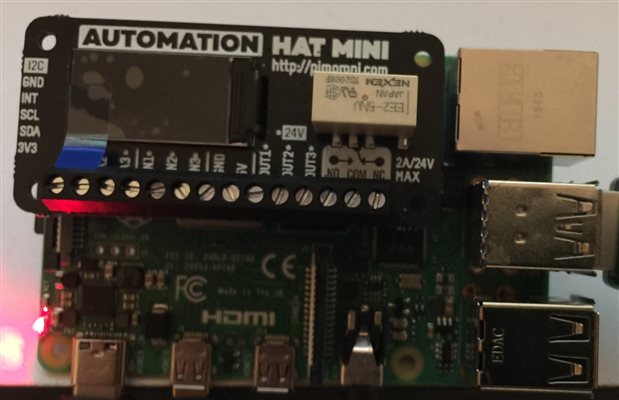

How to attach Automation HAT Mini to your PI
  • I was intrigued to find out that the HAT Mini is the same size as the  Raspberry PI W. In fact the Raspberry Pi W model has the same 40 Pin GPIO header as the larger Raspberry PI.  Making the HAT Mini a perfect fit.
  • The challenge is offering a Raspberry PI 4, so I'll be attaching to this model in this design.
  • To attach Automation HAT Mini to your Pi
    • place the hat on the Pi as described in the following image
    • image
    • push the female header on HAT down onto the male header on the Raspberry Pi, as far as it will go, making sure that you've lined all of the pins up correctly.
    • Lastly, carefully peel the protective film off the LCD using the little green tab. You can leave it on, if you wish, to protect the display of course.

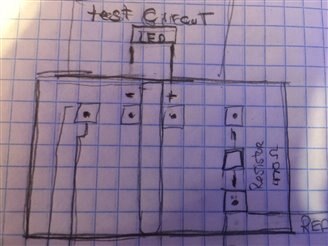

  • You will need the following components  to run some of the test
    • Breadboard
    • Male-to-Male jumper wire
    • an LED
    • A 470Ω resistor

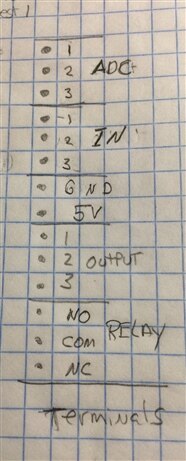

  • Here are the terminals that you will be connecting to on the Hat:

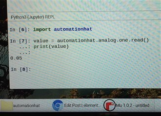

So, in your favorite REPL editor ( I use MU )   type:
import automationhat
now your ready to test the different functions of the board.

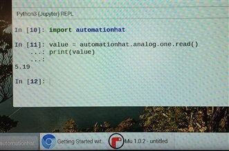

Analog (ADC) channels
  • The analog channels will return a floating point number between 0 and 24, representing the voltage measured on each channel.
  • The three screw terminal connected channels are tolerant up to 24V,
  • while the fourth channel, available on the broken out pins in the center of the board, can measure up to 3.3V.
  • Note that the ADC channels have an approximate ±2% accuracy, and you should take this into account when looking at your readings.
  • To read analog channel 1, type the following:
value = automationhat.analog.one.read()
print(value)
The 4 analog channels can be referenced either by:OR by:
Or By
automationhat.analog.two.read()
automationhat.analog.three.read()
automationhat.analog.four.read()
automationhat.analog[0].read()
automationhat.analog[1].read()
automationhat.analog[2].read()
automationhat.analog[3].read()
  • Note that the channels are indexed from 0 to 3 in the latter case.
  • Now, try connecting a jumper wire between:
    • 5V screw terminal
    • and the analog channel 1 terminal,
    • image
  • Read the channel again, as you did before. What value do you get back?

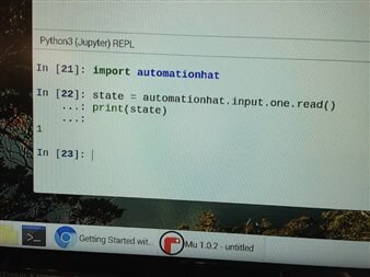

Inputs
  • The three input channels are:
    • tolerant up to 24V
    • Their state will be:
      • low below 1V,
      • high between 3 and 24V,
      • and undefined (either low or high) between 1 and 3V (these are approximate, not exact values).
  • When read, they will return
    • 0 for low a
    • nd 1 for high,
  • They can be read in a very similar way to the analog channels:
state = automationhat.input.one.read()
print(state)
  • They can be referenced automationhat.input[0].read(), automationhat.input[1].read(), and so on, using indices rather than the word form of the channel numbers.
  • Try the same test as before with the analog channel, and connect a short length of wire from:
    • the 5V terminal
    • to input channel 1 terminal.
  • It should now be pulled high
  • Try reading the state again and confirm that it has changed from 0 to 1.

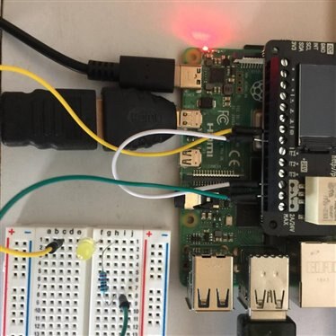

Outputs
  • The outputs on Automation HAT are sinking, so your load should be switched on the ground side, i.e. 12/24V (from supply) -> load -> output terminal -> ground (from supply).
  • To test the outputs use the Test Code below and wire up the HAT to a Test Circuit on a breadboard also described below
Test Circuit
  • The circuit consist of:
    1. An LED
    2. voltage-limiting resistor
  • connecting the positive leg  (short leg) of the LED to the resistor
    • the other end of the resistor is wired to the 5V terminal on the Automation HAT Mini (mini only has ONE?)
  • run a wire from the negative leg (long leg) to output one on the Automation HAT Mini
    • <picture of my test>

Relay (only one on the HAT mini)
  • Relays are mechanical switches that are turned on and off by an electromagnet on one side. They work in much the same way as the outputs, although they can tolerate up to 2A each and should be switched on the high side rather than the low. Plus, they have the advantage of having both normally open and normally closed sides.
  • Which side you choose to use - the normally open or normally closed - depends on the default state you want. If you're switching a device that will be switched off a majority of the time and then will be switched on then you'll want to use the normally open side, and if your device will be switched on a majority of the time and then switched off then you'll want to use the normally closed side.
  • to test the relay you will use the same test circuit we used for testing Outputs in the previous section, but the wiring will be different
Test Circuit
  • You'll need:
    • LED
    • 470Ω resistor
  • We're going to use the relay now  to toggle the LED on and off, but you could use any device that takes up to 24V, as long as you remember to connect it on the high side, i.e. 12/24V (from supply) -> relay -> load -> ground (from supply).
  • We use the circuit to wire to the Automation HAT Mini:
    • Take a male to male jumper wire and connect it to the resistor in the breadboard
      • and screw the other end into the COM terminal on relay .
    • On the HAT MINI, use another male to male jumper wire to connect the NO terminal on the relay to the 5V terminal .
    • Finally, connect another male to male jumper wire to the other leg of your LED (the shorter one) to one of the GND terminals.
  • It should look something like the image below once connected up.
    • image

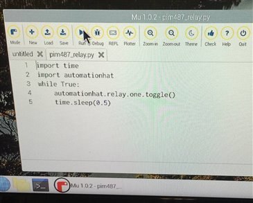

Test Code
To toggle the LED on and off. run the following:
import time
while True:
    automationhat.relay.one.toggle()
    time.sleep(0.5)
  • Your LED should now be blinking on and off, once every second.
  • The relays work, in terms of their methods, just the same as the outputs.
    • As well as the .toggle() method that toggles the state of the relays,
      • there are .on() and .off() methods that do exactly what they say,
      • and .is_on() and .is_off() methods that return Boolean (True or False) values depending on whether the relays are on or off.
  • Like the outputs, there's also a .write() method that accepts a Boolean value (0 / 'False', or '1' / 'True') to switch them off or on respectively.

PIM486 Enviro HAT for Raspberry Pi
Designed for environmental monitoring, Enviro for Raspberry Pi lets you measure temperature, pressure, humidity, light, and noise level. It's an affordable alternative to environmental monitoring stations that can cost tens of thousands of dollars and, best of all, it's small and hackable. In this section, I'll go through what the different parts of the board do, how to attach it to your Raspberry Pi, how to install and use the Python library, and also look at how to run a few of the code examples included in the GitHub repo.
What's on the Enviro?
BME280 temperature, pressure, and humidity sensor
    • The BME280 is a neat little weather sensor that measures temperature, pressure, and humidity. It's great for indoor monitoring, if you want to keep track of conditions in your home, for example.
    • On Enviro, the BME280 sensor is at the left hand edge of the board, and has been placed there deliberately to be positioned away from the Pi's CPU.
    • There's also a little slot routed out next to the sensor that helps to reduce heat radiated through the Enviro+ board to the sensor.
LTR-559 light and proximity sensor
    • This sensor can read the ambient light level in Lux (a unit of light intensity) and also has a proximity sensor.
    • The LTR-559 is the same sort of sensor that's next to the camera in your mobile phone that automatically dims and brightens the screen depending on the light level and disables the touchscreen when it's next to your ear.
    • As well as being great for reading the light level, the LTR-559's proximity sensor is really handy as a proximity-sensitive input. It is used it in one of the examples to toggle through displays of the different data from Enviro on the LCD.
MEMS microphone
    • Enviro has a tiny MEMS microphone that lets you record audio or detect noise levels.
    • It's really good for monitoring levels of noise pollution,
      • It's not clear when the company will be adding support for this to the Enviro Python library.
0.96" color LCD (160x80)
    • The tiny full-color LCD on Enviro is a neat way to display live data from the sensors onboard.
    • The display is an IPS display, so it's great quality for a display of its size,
      • and it's driven by SPI so you can update it pretty quickly.
    • The all-in-one example displays sensor readings from Enviro on the LCD,
      • with the live readings and a graph of the most recent values.

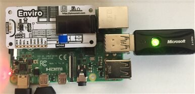

How to attach Enviro to your PI
  • I was intrigued to find out that the Enviro is the same size as the  Raspberry PI W. In fact the Raspberry Pi W WH model has the same 40 Pin GPIO header as the larger Raspberry PI.  Making the Enviro a perfect fit.
  • To attach Enviro to your Pi:
  • The orientation of Enviro pin header to the Pi 40 pin is as follows:
  • push the female header on Enviro down onto the male header on the Raspberry Pi as far as it will go, making sure that you've lined all of the pins up correctly.

  • BME280 Weather Sensor
    • get into your favorite programming environment and run
      • weather.py
    • You'll see the temperature, pressure, and relative humidity values being printed every second or so.
      • Try touching the BME280 sensor and see how the temperature changes,
      • and try breathing close to it to see how the humidity from your breath affects it.
        • Temperature: 23.35 *C
        • Pressure: 996.36 hPa
        • Relative humidity: 39.70 %
    • You'll probably notice that the temperature value is a bit higher than you'd expect (around 5 degrees C higher usually).
      • This is because some heat is radiated from the Pi's CPU through to the Enviro board and hence the BME280 sensor.
      • However, we can get the temperature of the Pi's CPU from its internal temperature sensor and use this value and a little bit of math to compensate the temperature pretty accurately.
      • Try running the compensated temperature example now, and you should see much more realistic temperature values. Type the following to run it:
        • compensated-temperature.py
        • There's a variable in that example code that you can change to tweak how much the temperature is compensated.
          • It's been calibrated against an analog alcohol-type thermometer and, ideally, you should too.
          • Look for the line that says factor = 0.8 and change this number a little either way until you get to around the right value.
            • Making this factor smaller will shift your compensated temperature further down,
            • and making it larger will shift it back up towards the uncompensated temperature.
  • LTR-559 light and proximity sensor
    • This example displays the current ambient light level in Lux and a value (from zero to a couple of thousand) for the proximity, with larger numbers being closer proximity and vice versa.
    • Run the example by typing:
                    python light.py
    • You'll see light values in Lux and proximity values (that'll be zero if there's nothing close to the sensor) streaming out.
      • Light: 1497.45 Lux
      • Proximity: 00.00
    • Try moving your hand close to the sensor (where it says "LIGHT") and see how the values change. We'll use the proximity sensor as an input to trigger changes between the variables displayed on the LCD in a later example.
  • 0.96" LCD
    • We've provided a simple example that shows you how to write text on a coloured background to the little LCD on Enviro+. The all-in-one example below has a much more complex use of the display to show text and a graph of values.
    • Let's try running the Hello, World! example on the LCD now. Type the following:
python lcd.py
  • All-in-one example
    • This all-in-one example displays all of the data from the sensors on Enviro+ (with the exception of the microphone) and lets you toggle through each of the variables using the light and proximity sensor.
    • Each variable on Enviro is displayed on its own screen, with the live reading at the top, and a graph below with values as a line graph and a colored heatmap-type background with red-ish color being higher values and blue-ish color lower. The graph auto-scales to fit the lowest and highest values currently being displayed.
    • Type the following to run the example:
python all-in-one.py
    • Tap your finger to cycle through the different variables being displayed, and press control-c to stop it running again.
PIM300 PICO HAT Hacker
I'm not sure if I will get to use the PIM 300 PICO HAT Hacker yet since it appears like it requires soldering. My soldering skills are not great, so I might pass. It would be nice to be able to stack the 2 hats on one PI.  It would be nice if Pimoroni had a product that Had the Header already soldered onto the board for me.
For now it will stay in the box.
Running both HAT's on One Raspberry PI
I was somewhat disappointed that I could not stack the Hat's using the Pico Hat Hacker,but happy to find that another challenger, dules had a solution in one of his blogs Aquaponics Box: #2 - Hacking the HATs (both HATs from the challenger kit on single RPi)
I was able to get both HAT working, using the wiring diagram and his PIN analyst contained in this blog.
Thanks dules
The only wiring I did different is that I used GPIO 13 for the Enviro display backlight.
