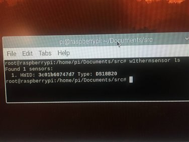

Testing
you can check the connection from the command line
List all available sensors:
$ w1thermsensor ls

SUCCESSThis sensor works great.
