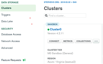

  • Getting a MongoDB connection string
  • Atlas has a neat way to construct a connection string in any language for use in the connection call in the client Driver.
  • To get a connection string:
  • Go to the Atlas Cluster page and  go to the connect page by
  • Pressing the "CONNECT"  button
    • image
  • Select the following Button
    • image
  • This will bring up the following dialog box.

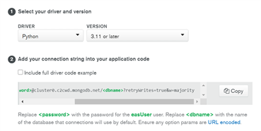

    • image
    • Select "PYTHON" from the "DRIVER" dropdown.
    • Now Select your python version from the VERSION dropdown
    • Copy the string for later use. You will need it later for a connection string. For now past it to a text editor for safe keeping..

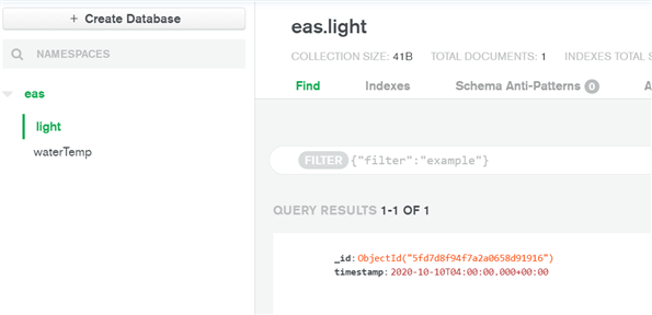

  • Creating a new Database on your cluster
    • Now, while still in Atlas you can create a database and collection in the Atlas dashboard by following these steps:
    • Press the COLLECTIONS Button
      • image
    • The following  screen displays the create Database button, a list of collections if they exist, and a query window on the right hand side.
    • TIP: collections are the same concept as tables in SQL DB's
    • The query window displays the documents (records in SQL), for the selected collection. In
    • Hare's a screenshot of mine, yours will have no databases at first
      • image

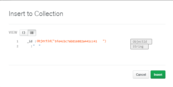

  • Create a document in a collection
    • Select the newly created collection
    • on the query to the right, press the "Insert Document" button.
    • The following dialog box appears.
    • Documents are stored in tuples pairs. You will see that in the code later on.

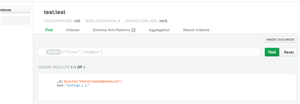

    • add some more fields. note that a unique key is added for you.after finished editing, press the "Insert" BUTTON.
      • image
    • you will see the document in the query results window.
      • image
