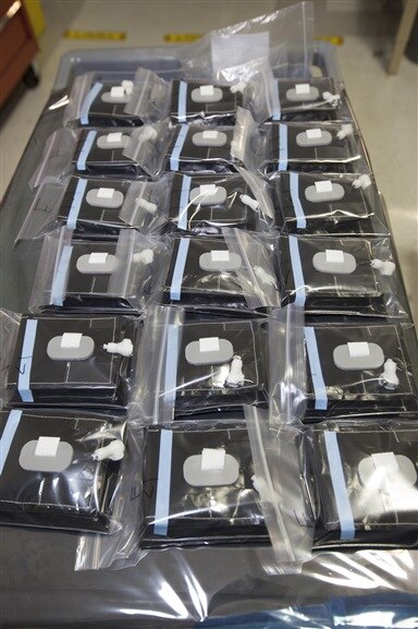

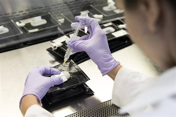

Veggie is a plant growth unit on the International Space Station, it's a simple low-power system to grow fresh, nutritious food on the ISS. There are 2 veggie units aboard the ISS. The veggie was flew to the ISS in April of 2014 aboard the SpaceX CRS-3 commercial resupply mission and was installed on the ISS on May 7, 2014. The whole system uses about 70W of power for the lights, fans and control electronics. I found a great article on Nasa's website going over how the whole system is designed and how it operates on the ISS: https://www.nasa.gov/sites/default/files/atoms/files/veggie_fact_sheet_508.pdf
Seed Planting
Pillows Preparation for Flight
Here is a link to a video on how the plants are watered on that experiment using a big syringe. In the pdf I've linked above there is a really good explanation on what they are using to hold the plants, all of the materials and how they're delivering the water to them: https://images.nasa.gov/details-ISS-Downlink-Video_Acaba-VEG-03-Experiment_Veggie_HD-DL-5_2017_269_1128_566623_hires.htm…

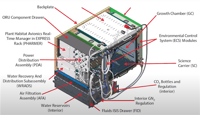

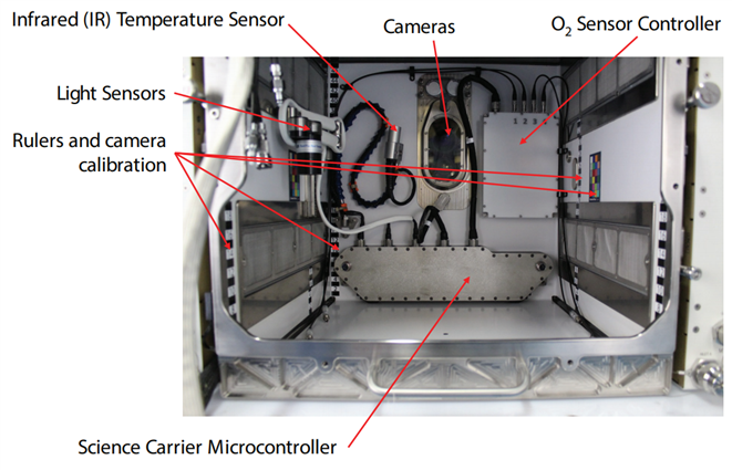

Plant Habitat-02 or Advanced Habitat-02 is a recent addition to the ISS. It was launched aboard the Northtop Grumman's 14th Cargo Resupply Mission which launched in October of 2020. Compared to the Veggie, this has an incredible number of sensors and amount of electronics as a part of it, you can see some of the details of the Plant Habitat here: https://www.nasa.gov/sites/default/files/atoms/files/advanced-plant-habitat.pdf
This system, how complex it is and how it looks is simply said amazing. Unlike veggie, this is an automated system, it has over 180 different sensors and it uses a porous clay substrate with controlled delivery of water and fertilizer for optimal plant growth. A version 1 of this system was already tested back in 2018, https://www.nasa.gov/content/growing-plants-in-space . And just about a week ago, Nasa published on Twitter that they have radishes growing onboard the ISS.

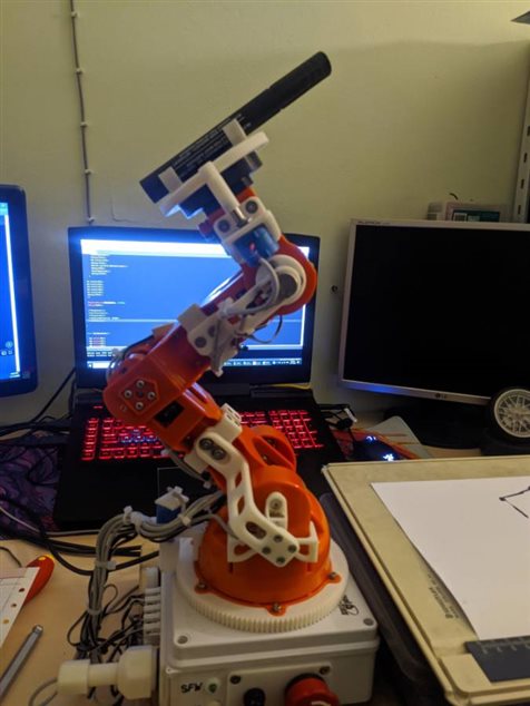

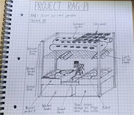

     My idea is to design and build a conceptual module which would automatically grow food on Mars and be used as an experimentation setup for testing out different soils and different types of crops. Going back to the name of Robot Assisted Garden, it will for the most part be run by a robot arm which will go and do different kinds of tasks like, measure soil humidity at various point, plant seeds, take samples, get angles with the camera and so on. In the last few weeks I was working on designing a sensor kit for my robot arm: Sensor Kit For BRACCIO  which I plan on using for this project. The main brain of this project will be of course a Raspberry Pi 4, which will use the Pimoroni hat to track some of the parameters of our garden. Besides that, it will be the main unit which will control all of the different modules as well as power to them. There will be another sensor module which will be used to double check all of the measurements on the Raspberry, a light module which will control the lighting system in the project, robot module which I already covered in my braccio blog and so on. Here is a picture of my original concept drawing for this project:
In the original sketch there were 2 levels to the garden, first being the traditional garden, while the second level was a hydrophonics system. I will be mostly be concentrated on the lower level as I have described already, but if I have some time left at the end, I'll also go and play with the second level. This was the very first sketch I did for this project, so of course, my mind has changed on a few things, what will be where and so on. But for the most part, the arm will be on rails which it will be able to move up and down and go between two small gardens. It will have a quick change tool head on it so it can switch it's head for various different tasks. I will be changing some of the things, where they're located and will also be adding some additional things. But I will talk about them when I finalize them. And in the end, here is the picture of our gardener for this project (he's an artist in his free time as you can see by the marker he's holding, but let's just say he's still learning how to draw....):
Since this is supposed to be an experimentation station, I'm still working out plans for making a small lab as a module for this project. I want to have a place where the robot can put samples of dirt or samples of plants, where I can do some analysis, things like color of the leaves from the sample, soil pH levels and so on, but this is a part I'm still trying to work out on exactly what I want it to do, so it will come towards the end of this project.

    I'm curious if your robotic gardener/artist is your own 3D printed design? The link to your project collection seem to be broken
  • milosrasic98
    milosrasic98 over 5 years ago in reply to ajcc +1
    Hi! The artist/gardener/astronaut (many many interests in his life) isn't my design. The arm isn't my design, it's a product made by Arduino, it's called BRACCIO, here are some links for it: https://export…
  • milosrasic98
    https://export.farnell.com/arduino/t050000/tinkerkit-braccio-arduino-robotic/dp/2831002?ost=braccio
    https://store.arduino.cc/tinkerkit-braccio-robot
    The white parts that you can see on the pictures are 3D printed and are the part of the sensor kit I designed for it to track all of joint angles! Checking the links now I see they show up as links but are not working, thanks for giving me a heads up for that! Those are the links that I use throughout all of the blogs, so I'll take a look at fixing it!
