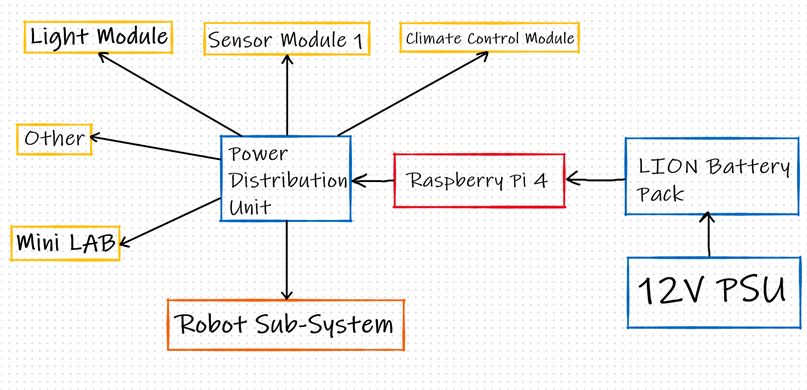

For what do I need connectors?
     My project will have a modular design, where I'm going to have a central unit with the Raspberry Pi 4 which will control and communicate with the other modules in the project. The Raspberry will also control all of the power to the modules, since there will be a central power supply module backed up by a central battery bank in case of a power loss. In this way, if there is a power loss, the Raspberry can shut off unneeded modules like redundant sensor modules and so on. From there we can see that we need a connector for data transfer as well as a power connector to tie the modules between themselves.
     Besides those 2 connectors which are used for connecting the different modules there is another connector I will be needing. As I've mentioned in the first blog, the robot will need to change it's head to perform different functions. Because there will be active components on the head of the robot, I need to get power and maybe another signal to the head of the robot somehow. One way to do this would be to have long cables which the robot could pull around as it's working, but those would catch on everything and just cause a big mess. My idea, why not design a sort of an automatic connector. It has to have 3 pins, and it has to engage when the to halves are close to each other, so I decided to go with magnets. Before going into the details on how I designed both of these connectors, let's make a short requirements list for both of them.

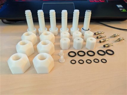

     The main idea here was to copy the old design which was pretty good and upgrade it with rubber O rings. Rubber O rings are great thing, I managed to find a set with many different sizes for around 10$ and it proved to work great with 3D printing. It's a bit tricky to get the dimensions just right for embedded O rings, but I managed to do so after a few tries. In the next part I will go over the design for all of the components of the connector. The parts which are labeled as 3.5mm variant and barrel jack variant are for the panel mount part of the connector which is different in regards for the type of connector which is used.
Design

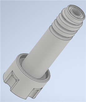

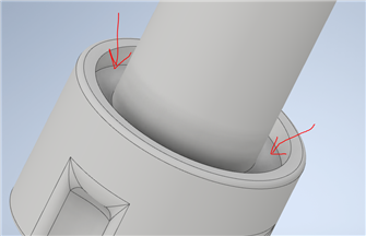

Body of the Connector
Body of the connector

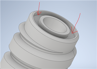

This is the main part of the connector as the name implies. The length of the body of the connector can be made shorter for a shorter version of the connector. Here is a technical drawing for this part:
The weird shape at the top is the "key" for the other part of the connector. When you plug in into the other, it will stop this connector from turning in circles while you tighten it. As you can see at the top as well there is a shallow ring shaped hole, that is the part which is going to go over the O ring which is mounted on the panel connector. There are 2 O rings that can go on this part of the connector, one is in the small channel near the tip of the connector pictured here.
The other O rings goes where the cables enters the connector. My design philosophy was that the mushroom gets glued to the cable so when you tighten that mushroom down with the cable nut, it will compress the o ring and make that seal much better. The slot for the O ring can be seen on this picture.
Besides that, other things to point out is the thread at the top which is used for the cable nut. This of course isn't a standard thread, I designed it myself to be strong when 3D printed, the way I did this is by coiling a trapezoid around the body of the connector making the cut. The cable nut has the same thread as you will see soon, with just a slightly bigger radius due to the tolerances of 3D printing. In the end, this is how the model turned out.
Locking Nut
Locking Nut
This here is the locking nut which goes over the body of the connector, it can slide up & down it, and it threads onto the panel connector to lock the connector in the place.
The thread on this nut was designed in the same way as for the cable nut and the thread on the body of the connector, the only noteable thing here is a small lip inside this nut, which serves the purpose of pressing the first O ring shown in the last tab. You can see that lip here
In the end, we end up with a model looking like this. It can be printed without any supports which goes also for the body of the connector, the trick for the nut is to turn it in a way that the smaller part is touching the buildplate. The overhangs are 45 degrees, which most modern 3D printers can handle without any issues.

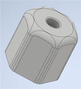

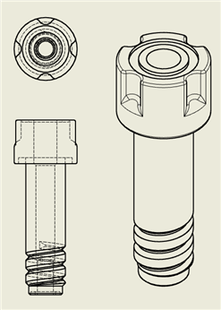

Cable Nut
Cable Nut
This part is used to tighten the cable in the connector so it can get pulled out. The design is pretty simple, one thing to not about this design, is that you need to either adjust or do some post process working on it if you wanna fit a larger cable through. Here is the technical drawing for this part.
The thread was made in the same way as for the other parts of this connector, just a trapezoid coiled cut, it has a slot on the inside for an O ring, but I found to be unnecessary since there is one underneath the mushroom which is the important one.

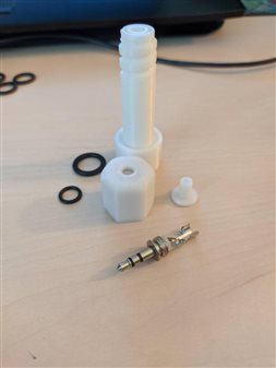

Mushroom
Mushroom
This is the last part needed for the connector, the mushroom. This is the smallest part and it's designed to be modified depending on the size of the cable you are planning to use. This is the only part on which I would recommend some glue. I'm personally not putting any, but I'm putting a smaller hole, and getting it wider by hand until I get a really really snug fit on the cable. For the most part I need this cable to be humidity resistant, but even without glue, if the the cable fits in snugly, it will be pretty water tight as well. The connector can accept cables up to 9mm, where at 9mm, you don't need this part at all. Here is the drawing for this part as well as how the 3D model looks like.
     That would be all of the parts needed for that side of the connector. This side of the connector is same for both the 3.5mm jack as well as the barrel jack. I designed all of the parts so you can print them without using any supports, as for bed adhesion, you can go with a raft if you want to be sure you won't get an elephants foot at the bottom, or if you've dialed in your bed leveling, you can just go without it. Link to all of the STL files for 3D printing as well as STP files if you wish to edit the models yourself can be found on this link here: https://github.com/MilosRasic98/1MeterOfPi/tree/main/3D%20models/Waterproof%20Connector . Those files come without any warranty but you are free to do with them whatever you desire. If you do something cool with them please share them with me, I would love to see! Here is how this part of the build looks printed out.

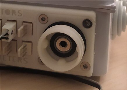

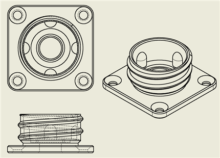

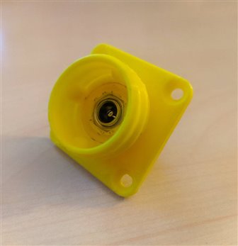

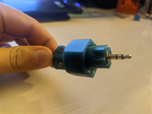

3.5mm variant
     This is the part that will differ between the 3.5mm connector and the barrel jack connector. While it can work using only this connector for the cable mounted variant of the barrel jack, it just wasn't it. It was obvious that it was designed for it, even though it somehow fit. I did a few tweaks to make it work, but I will show that after going over this version of the connector first. Just like we did for all of the other parts, let's begin with a technical drawing of the part.
     To mount it somewhere, I left holes big enough for M3 screws at each corner with a cone head, where the top of the cone on the model is 7mm in diameter. The thread of course matches the locking nut thread sot hey can work together, and you can also see the "key" that I talked about in the part about the body of the connector. Around the connector itself there is a small ring shaped channel left for an O ring to go in. This part is also designed with maximum overhangs of 45 degrees, so it can be printed out without any supports. As for the connector that goes inside it uses the standard 3.5mm female cable connector variant. Here is how it looks when it's printed.
     Just like all of the other models, you can find 3D models for this link, both STL files and STP files on the GItHub link. On the picture you can see the 2 O rings used for this connector. The bigger one isn't that necessary, and you need to put in the connectors absolutely precisely for that one to have effect. Much more important is the small one inside the connector. To put it there I used a screwdriver and went in circles slowly, and then used a wider punch to just press it in firmly when it was inside all around.

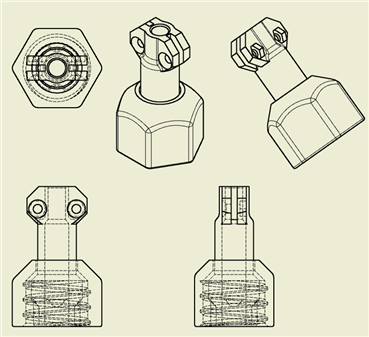

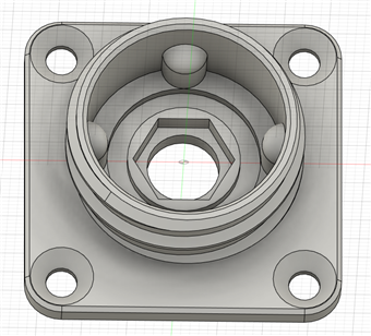

Barrel jack variant (5.5/2.1mm)
     While the above model can be used with a barrel jack connector, I had mixed success with it, because you need to use the barrel jack connector which is designed for a cable, of which I am not a big fan of. After trying to solder some thicker wires to it, the connector just melted inside itself and it had an internal short, that's why I did a redesign where in the same formfactor just using a different off the shelf connector, we can get much better results. Here is how that went, let's look at the changes on the model first.
     Instead of a circular hole, you can now see a hexagonal hole going 2.4mm down. The reason for this is because I found barrel jack connectors which are designed to be mounted on a panel which come with a locking nut. This proved to a be a great thing, because with just a couple of small changes we can have a much better and sturdier connector. The normal ones requires a bit of super glue to hold in the connector properly, while this doesn't at all, but it still keeps the slot for the rubber O ring. Of course, to make it compatible with some of the things I've already designed for this project I kept the same outer form factor as the last one. Here is a picture of the printed version of this.
     With that, the design process for these connectors is complete. Models for this one are available for free as well of course just like the rest on this link.  With all of that complete, let's take a look at how these connectors used when cables are attached as well as when the panel mounted connectors are connected.

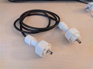

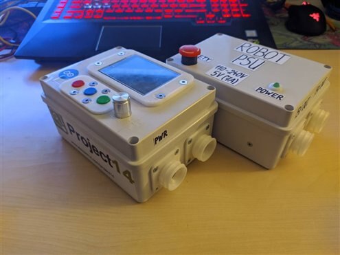

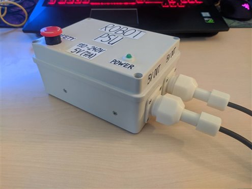

Finished Connector

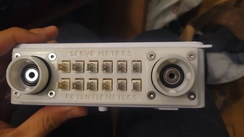

     All of the pictures you're about to see are from my sensor kit for braccio project: Sensor Kit For BRACCIO . The robot, as mentioned before will be a part of the project as well. So here are some pictures of the cables I made for that project as well as the panel mounted connectors. These connectors will be present between all the different modules that will be found around my project. I may do a redesign and update if I manage to find a suitable 3.5mm female connector which is designed for panel mounting, as I have for the barrel jack. But until then, I will be staying with this design since it's working great.

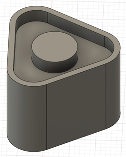

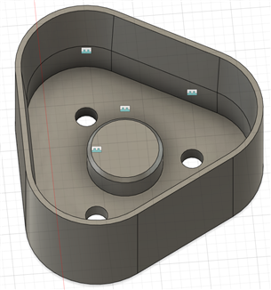

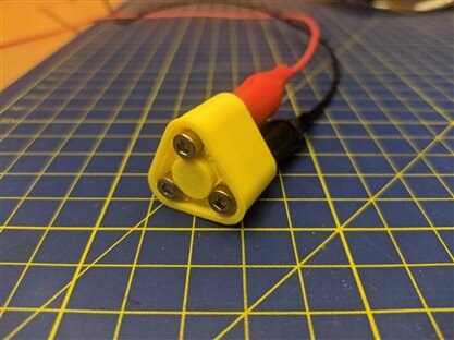

Design
     I kept the design really simple since this is just a proof of concept. As terminals and connection surfaces I used small M3 machine screws. To screw them in, I left a 2.4mm hole in the models and after that I went and cut the thread into the plastic. This is something I started doing recently and it's working out great honestly. The plastic is really easy for cutting threads. The connector has a triangular shape because of the 3 screws and magnet in the middle, any shape would work except a circle, because the magnet can't really orient the connector in that axis. Here are the 2 halves:
     On the first picture is the part of the connector which will go onto the tool head, while on the second picture, the part of the connector that will be mounted on the robot. The main reason this design isn't finalized is because the connector which is mounted to the robot needs to move freely along one axis. If the connector is fixed on the robot and on the tool head there really isn't any point to the magnets. The best scenario for this design would be for the second part of the connector to be inside the shroud of the first part when the robot grabs a tool, because in that case the magnets can do their thing, and there is no chance of this connector falling out. But I'll talk more about that and show that once I finalize that design. For now, I printed this out in PLA, and hooked them up to a power supply and a small LED to test them out.

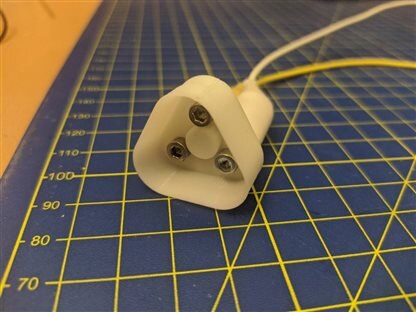

Finished Connector
     After an hour or so of printing later I finished up with the first prototype. I won't be posting these files on GitHub since this is only a proof of concept, but I will post the final version for sure so everyone can download or use it in their own project if they find a place for it. To test out the connector I just used a small LED.
Here is a video of the connector working, you can see the magnets doing their thing and pulling the connector together, and not losing the connection even after some shaking. On the final design there will probably also be a spring pushing the connector into the other half, so there won't be any chance for the connector disconnecting unless the robot is changing tools.
In the second video we can see from how far the connector can actually pull itself together using the grid on my cutting mat. Those squares on the grid are 10mm x 10mm, so from the video, we can see it's pulling itself together at around 6-7mm, and that's looking at the outer plastic part, so the results is even better.
