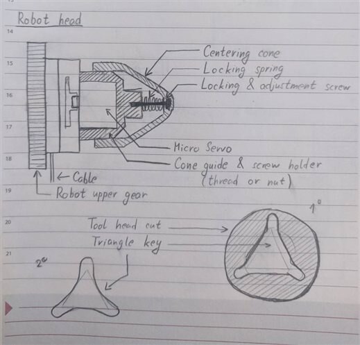

2. Idea
This mechanism needs some kind of an active component, a solenoid, motor, electro magnet or something similar, which would activate and deactivate the mechanism. I decided to go with a small servo motor since it won't require a lot of current, and it won't be too heavy like if I wanted to get a pretty strong electromagnet. This mechanism needs to lock a tool head in place so it can't come off and it can't rotate around it's axis. Another thing it needs to do is to not be dependent on the power of the servo to keep it place, the servo should be just like a key, just doing the locking and unlocking, while there's a mechanism that will be robust to keep the door locked. My idea is to go back to one of my older design from a year ago, when I made the Project Cookie Jar . Let's take a look at how the mechanism there worked:
Above is a sketch of the mechanism I designed for this project, I will use the sketch just to explain the concept. The idea is to have a center rotating crank with 3 pistons rods attached to 3 pistons which are essentially in 3 small cylinders. By rotating the crank in the center with a servo, we can extended the pistons out of the body of the mechanism, or we can pull them back in. Design wise, there is just a couple things to be vary of, the angles at which the piston rod will attack the piston and leaving enough tolerances. This of course the mechanism found in almost all car internal combustion engines (let's not forget the Wankel engine!) and the tolerances there need to be fine because of the incredibly high pressures, while for this, we just need the piston to go in and out. Give it a bit of slop and doing the angles so the piston rods push more into the piston rather than the piston walls, ensures we have a mechanism that will work pretty good. Here is a video of the old mechanism working, turned by hand.
The next step for that project was of course adding a servo motor to the whole thing and here is how it worked with that. The mechanism worked without any issues what so ever, it just need a bit of guess work at what angles the servo needs to go to get the full range without overextending and pushing the pistons out of the cylinders.
So that's where the idea for this mechanism came from, but there is one pretty big problem in this design, and that is, it's too big. While I could technically mount this to the end of my robot, you can see how bulky the whole mechanism is, and it was pretty heavy considering it was using a standard sizes servo. One thing to note about that mechanism is that I made it by hand from scratch using wood and metal pieces I had laying around, this time I can use 3D printing to get a really compact design.
3. Plan

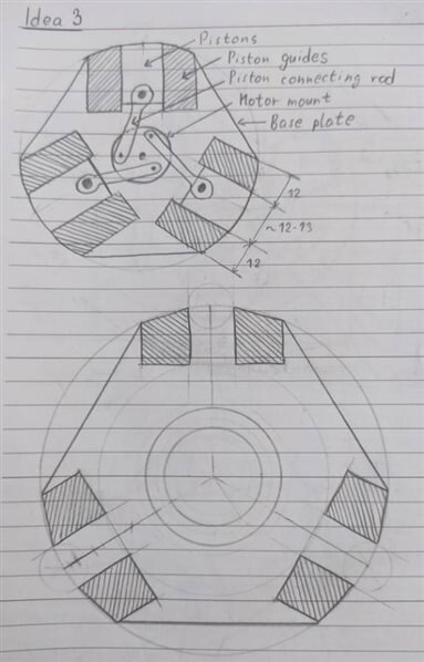

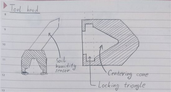

     Inspired by the design I've shown the plan for this mechanism is to design it in Fusion360 and make it as small possible, because the less mass we have on the top of the robot the better, and everything else will be much smaller as well. Let's begin with some sketches.
     This sketch shows my general plan for this, which went to the final version. There is a centering cone and a locking triangle. The centering cones purpose is, well, as the name suggest, to center the robot to the tool. Because the robot isn't that accurate to make sure it engages with the tool head every time, this cone will make sure even if there's a bit of play in the mechanism, it will still work. The locking triangle will be used to capture the pistons from the central mechanism to lock the tool in place. On the left you can see how I plan on mounting the soil humidity sensor.
     This is a sketch that covers more of the mechanism itself. You can see the robot gear on the top picture to which I need to mount everything, There are 8 holes on that gear that allow me to mount anything using M4 screws. Above that is the small servo which will turn the crank and push the pistons out, and on top of that is a spring loaded cap. Now let's get into why I have a spring loaded cap on top. If I did the mechanism without the spring cap what would happen? The mechanism would go into the tool, extend the pistons and lock in place. If the dimensions are not completely perfect, either the pistons won't engage properly, or there will be a small gap between the top of the cap and the mechanism, giving us some slop in the mechanism. By adding a spring loaded cap, we ensure, that even if we have some dimensional errors, everything will fit properly, and furthermore, when the pistons are in their holes the springs will cause tensions in the mechanism making it more robust. The only thing to watch out for here is that the robot needs to compress the springs when engaging with the tool head, which isn't hard to accomplish. On the bottom of the page you can see the drawings for how the keying mechanism should look like. The holes for the pistons need to have a bit of a fillet on the edges to guide the piston into the hole, since there is a change it will be off by a couple of millimeters. These sketches are of course just the concept idea, let's see how this will go when we start designing it in 3D part by part.

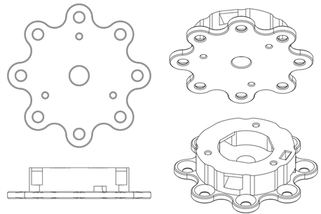

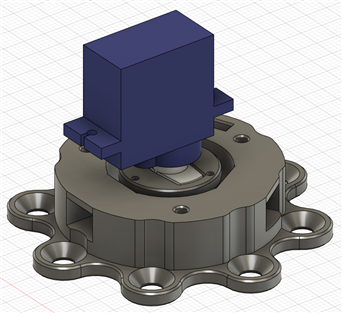

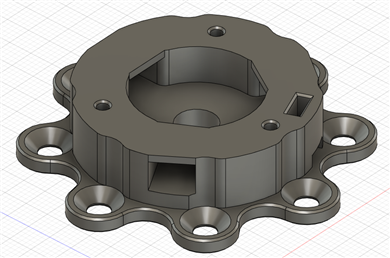

Base
We will begin with the base of this mechanism, let's define what the base needs to do first. The base needs to have the holes for attaching the whole mechanism to the robot, part of it will be the cylinders that will be used as guides for the pistons, we need a hole for the cable routing and we need holes for attaching the motor mount to it.
It has a hole in the bottom in the center which is used as a brace for the barrel when turning as well as for tightening the screw that attaches the motor adapter to the servo motor.

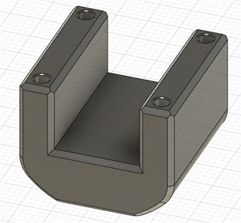

Motor Mount
This is the part that holds the motor with 2 small screws I found laying around (though some super glue will work fine too) and attaches on top of the base. It needs to have the cable routing hole in the same place as the base, 3 screw holes for attaching to the base, and 4 more holes for the screws which will go upside down and used for the cap. Here is the technical drawing for this part.
It's a pretty straight forwards part, it was modified along the way to fit everything and that's how I got it in the end.

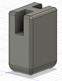

This was the simplest part to make by far, it's a small rectangular piston, I made the tolerances so it's about 0.2-0.3mm smaller than the cylinder hole on the base. At the back of the piston there is a small rod to which you attach the copper wire as a piston rod.

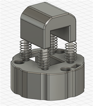

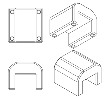

Cap
The cap is the part going above the servo which is spring loaded by the 4 small springs already mentioned. It has 4 2.4mm holes for the M3 screws. One thing I didn't point out for the base, is that the holes for the screws are also 2.4mm so I can easily cut the thread into it. This is something I started doing recently and found to be very easy to do, while working absolutely great for me.

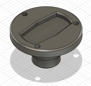

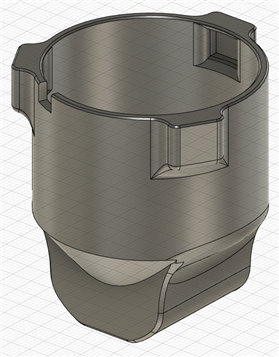

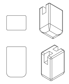

Sleeve Template

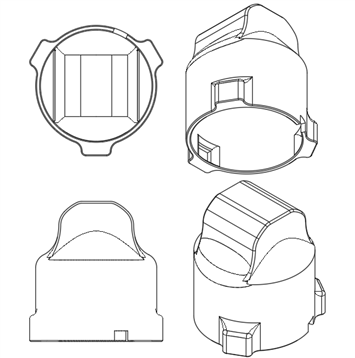

This part was the hardest to model and I didn't get it to work on the first try. This is the sleeve that goes over our mechanism that needs to push on the springs and align the holes with the small pistons. It looks like a weird cup currently, since it is only a test to see if the mechanism works. I will use this model later on to make special tool heads by adding features to it.
Finished Assembly

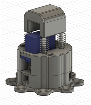

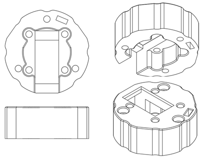

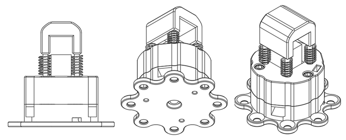

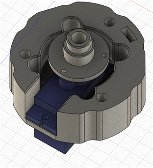

     Those would be all of the parts needed for this assembly. Now, let's take a look at some sub assemblies and then at how the final assembly turned out. Another thing to point out is that I've designed all of the parts so they can be printed without any supports. I printed them on my Ender 3 Pro, using Creality White PLA, at 205C and 60C bed. The tolerances for the moving parts are 0.3-0.4mm, so most 3D printers will be able to handle that. I could have pushed for finer tolerances, but there really wasn't any need to. On this link, you can find STP files for all of the components if you wish to edit them in any way as well as STL files so you can slice them right away and print them. All of the filed are of course free to use, so you can do whatever you want with them!
     On this picture you can see how the base of the mechanism works with the barrel and the servo motor. There's a pretty big gap between the barrel and the base because I don't need them to be close and I've put chamfers on the bottom edges of all models  to compensate a bit for the elephant foot while printing.
     On these 2 pictures you can see the motor mount doing it's 2 jobs, holding the motor snuggly in place and on the second picture you can see how the top cap is mounted using the 4 screws and 4 springs. You can notice on the first picture that there are like channels around the motor, those are for the screw heads to go up and down when the cap is moving, and the square hole is for routing the flat 3 wire cable from the servo. Let's take a look at the full assembly now.

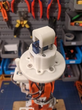

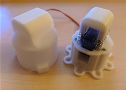

     After a day of printing the parts one by one I had all of the parts complete. The only other thing that I needed was a bit of solid copper wire to make small connecting rods to connect everything together, which I'll show in the next section. This part required a bit of effort to make everything work, but it did in the end, in total, there were 114 different sketches for this design.

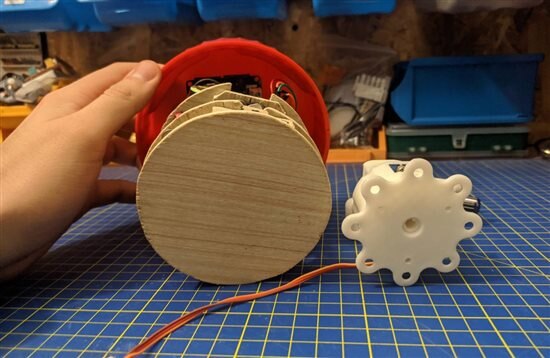

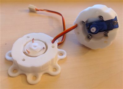

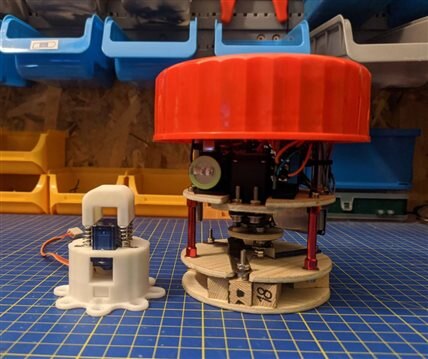

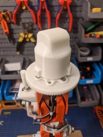

5. Finished mechanism
     And finally, after all of that work, let's take a look at the finished parts. There aren't many pieces to the assembly and from the 3D models above, it's pretty straightforward with just a few screws. The only thing not covered above is the solid copper wire connecting rods. I had some 1.7mm thick copper wire (not sure what's the correct diameter, my calipers were showing 1.71-1.73mm). To get them to attach to both the pistons and the barrel it just needed a few twists, the wire in the end needs to look something like this:
     The hook that you can see at the bottom goes onto the center section that you can see on the model of the piston, while the vertical part goes into the barrel of the mechanism. To secure it in place, I just bent the wire at the end and cut off the excess after putting it through the barrel, here is how the finished result looks like.
     In both pictures, you can see the tips of the copper wire slightly bent so they can't come loose that easily from the barrel, looking at it now, I should have maybe bent and cut the wire first to the final shape before assembly, but since it's working great now, I really don't want to take it apart again. In the end, the whole mechanism with the template sleeve turned out like this.
     All that's left to do now is to do some testing with this, to see how well it works. One thing I haven't mentioned is that I cut off the old connector, since of course, I couldn't get it through the routing for the cable part with it attached, but I crimped a new nylon connector on, to match the connectors that I'm using for the other servos on the robot. Before we get to testing, this is something I made in the meantime, since I'm working a lot with servos and needed an easy way to test them.

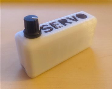

6. Servo Tester
     While small, multi channel servo testers can be found easily for a really low price, I just wanted a small, simple and robust one that would allow me to test one servo. Another thing I wanted was to not have to go and look for any jumper wires to power the device on, but rather power it using a phone charger and a USB Micro port. So I decided to design a simple servo tester. I went with the easiest way of using an Arduino Nano, potentiometer, Micro USB port and a small 3 pin nylon connector. The potentiometer was connected to the analog pin and the power, while the servo was connected to the 5V and one of the PWM pins, then the reading on the input pin was mapped to an angle of 0 to 180 degrees which was used in the "servo.write(x)" command.
#include "Servo.h"
int angle, potentiometer;
Servo motor;
void setup() {
  // put your setup code here, to run once:
  motor.attach(3);
void loop() {
  // put your main code here, to run repeatedly:
  angle = map(analogRead(A0), 0, 1023, 0, 180);
  motor.write(angle);
  delay(50);

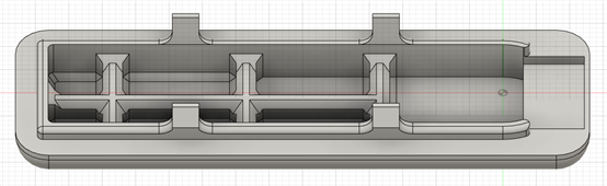

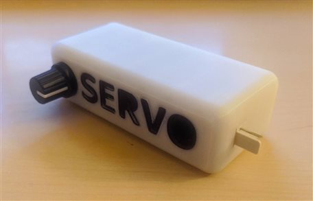

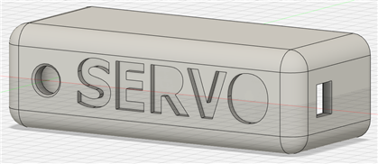

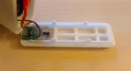

     The only thing needed for this project was an enclosure, so I designed one that snapped into place into a small box with openings for the USB port, the motor port and the potentiometer. Here are pictures of the 2 3D models of the enclosure for the servo tester.
     The first picture shows the enclosure of the servo tester, while the second picture shows the lid that goes on the bottom. The models are designed so they can be printed without any supports. To print them, I used, as I've already mentioned for the rest of the project. My Ender 3 Pro, with pretty standard settings, 205C and 60C for the bed, Creality White PLA (I found their PLA really does amazingly on my printer, it's the same filament that comes with the printer). As with all of the other models used in this project, you can find both the STP files as well as the STL files on this link: Servo Tester 3D models. You are free to do with the models whatever you want! Here is how the end product turned out like.

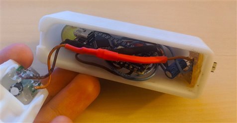

     I just directly soldered the wires on the inside as there really weren't too many of them. Another that I added which you can see in both pictures are capacitors, both at the USB port and at the nylon motor connector. In my experience, servos love to draw a few spikes from time to time, so this is just a way to make sure everything runs smoothly, though, since I'll be using this only on small servos, I could have probably done everything without using any capacitors at all.
With the servo tester complete, we can finally see a few test videos for the quick tool change mechanism!

     Time for the fun part! Testing the thing we were designing and making. It's such an incredible experience seeing something work as it should after putting in the time to get something from an idea to a physical thing. To start off the testing, let's take a look at the mechanism extending the pistons and retracting them without doing anything else, and then slowly go further.
     That was the easy part, now let's see how it works with the sleeve template that I've printed out. Before getting to the video, just a quick reminder, to engage the mechanism with the sleeve template, the sleeve template needs to compress the springs a bit, as much as it can which isn't a lot, so the pistons can line up approximately with the holes on the sleeve. And then, when we extend the pistons, there should be a strong mechanical linkage.
     It works! Honestly, I'm thrilled with how good it's working. I knew it was going to lock in place but I didn't how much slop it would have since the springs aren't that strong, but I'm happy to say it's holding on really really good. This far exceeds my expectations that I had for it. The only thing left now is to mount it to the robot and see how strong the mechanical link is.
     I love how it looks on the top of the robot! The size of the whole contraption isn't too big at all, specially if I'm start with the tool designs later on, this will work without any problems whatsoever. To test the strength of the mechanical bond, let's see if it's strong enough to withstand the mass of the whole robot and the giant wooden block that the robot is mounted too.
     Didn't even break a sweat, and this block of wood is pretty heavy. The sleeve has minimal movement on the mechanism when it's engaged, it can rotate around it's axis by a fraction of a degree, but that's all, it will do the job really good for sure, I can't wait to put actual tools on the top. In the end as a cool bonus, I still have the jar mechanism I made last year, here is how they compare in size to another, I was able to get this one much more compact than the last year version, though, of course, with a much different set of tools and materials compared to the last time.
