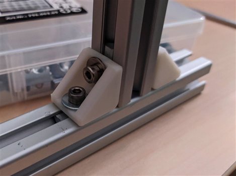

5. Assembly
     With all of the parts designed and printed out, the only thing we have left to do is assemble everything. The first thing I assembled is the wheel assembly for the robot. The reason why I did this so I can know the exact measurement to which I'll need to make my frame so the robot glides nicely on it. Here are the pictures of the wheel assembly which you could have seen above as well.
     After this part of the assembly was finished, it was time to turn my attention for putting together the whole frame. The wheel to wheel distance came to around 178mm, so that was the dimensions that I was aiming for when putting this together first. Here are all of the fasteners and parts needed for this part of the assembly.
     On the left we have the L brackets, screws, washer and nuts needed for them, in the middle we have the motor assembly, and on the right we have the belt assembly. To make the frame, I used 4 pieces of 20x20 extrusions, two with the length of 993mm, and 2 ones I had laying around that are 280mm and 425mm. I didn't shorten those to the same length, as it gives me more room for mounting things later on. As for why the length of the rails is 993mm, the guy I ordered them from cut them to that size on purpose, since, if the package is above 1m, the postal services charges way way more for shipping where I live.
     Above you can see some of the close ups of the construction. On the first picture you can see the frame held together with the L brackets and the belt tensioner doings it's thing. On the second picture you can see the legs mounted to the construction, the height adjustment works great, and on the last picture you can see the part where the motor is. Next to it, you can also see the limit switch. Here is a big picture of how the whole construction turned out.
     I am so happy with how third turned out. In the picture, the legs are at their shortest setting, and the lower wheels are still clearing the ground by a couple of cm. They can go much higher if needed. After doing the first test assembly, I took the whole thing apart and with help from my dad, we slowly put it together to make sure everything was aligned properly and centered. After that assembly, it turned out great! The only mistake I made was tightening the belt too much, but after loosening it up everything went smoothly.

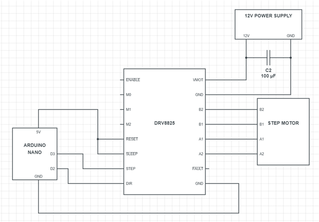

6. Electronics
     As mentioned multiple times, I will be using a stepper motor for this part of the build. As you know, driving the stepper motor isn't as easy as just plugging it into power and it turning, but, to be honest, it's not much harder than that using small stepper drivers. They became really popular and low cost specially because of 3D printers using them. There are multiple options for widely available stepper drivers, here just a list of the basic few:
  • A4988
  • DRV8825
  • TMC2208
     They all do the same thing for the most part, driving a stepper, but they are rated for different current of course and have additional features compared to one another, like silent stepping, sensorless homing where it measures the current going to the motor to home and it so on. The one I have and will be using is the DRV8825.
Here is the datasheet for the driver that is on this breakout board as well as a link going into a bit of a detail when it comes to using the module:
  • https://www.ti.com/lit/ds/symlink/drv8825.pdf
  • https://www.pololu.com/product/2133
     Driving this stepper driver is pretty simple using a small microcontroller. On one side of the board we have connections for the motor and the power supply for the motor, while on the other side we have the control inputs. We have reset, enable, sleep signals, we have inputs for microstepping and most importantly we have the step and direction pins. By sending a pulse to the step pin we can turn the stepper motor, while depending on the logic level of the direction pin, we will be turning it either one way or the other. Here is a simple schematic of this breakout board.
     The connections between the components are simple as you can see from the diagram above, all we need are 2 digital pins from the Arduino Nano. I haven't played with microstepping features of this breakout board yet, but I'll look into that in the future. The power supply pin for the motor accepts a wide range from 8 to over 40 volts, but I'll be going with 12V so I can use that at the rest of the project. All we need now is a short piece of code and we can finally test it out.

     As you can see, the code is incredibly short, the only thing I did was send a pulse to the DRV8825. The frequency of that pulse signal determines how fast our motor spins. All that was left now was to connect the motor and see it working.

We have the motor spinning, let's just see how it works when we have it all mounted to our rail system.
And here we can see the stepper moving the cart along the rails. During testing and preparing for another video, I managed to short something out on the motor driver so I had a bit of a situation, as you can see on the following photo:
     In other words, I'll be needing another motor driver. Besides just sharing all of the things that went right, I think it's important to also show some of the stuff that went wrong, like here. I'll just order a new (or 2 to be safe) and continue on with this build. To wrap it up, here is a picture of our astronaut mounted on the rails.
