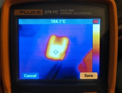

     First thing I did when this happened was order new drivers and a new motor to be safe. There are 2 important things to notice in the sentence and that is the plural form of drivers and the new motor, which proved both to be essential. I ordered another DRV8825 but I ordered an additional A4988 driver just in case. Let's begin by talking about what I did in the meantime while waiting for these drivers and motor to arrive. I did some reading trying to understand what went wrong or what I could have messed up. Which gets us into our first troubleshooting and important first step when playing with stepper drivers which is setting the Vref voltage.
Setting the Vref
     This is an easy but a really crucial and important step for using these drivers. What is Vref? Vref is the voltage that we can adjust with a tiny screw potentiometer on the stepper driver which gives the driver a current limit for that motor. Adjusting this potentiometer we can limit the max amount of current that goes through the driver.
     You can see the small potentiometer on the right side of this picture. To measure the Vref, you need to connect one of the probes to ground and another probe to the screw of the potentiometer itself. An easy way to do this, as suggested on many websites, is to use small alligator clips attached to the screwdriver so you can see the value change as you're turning the screw. Now, to know to what value to set the Vref depends solely on your motor and driver. There is usually a simple formula to follow, for example, for my new motor and DRV8825, the formula is: Current Limit = Vref x 2, and my motor is good up to 1.7A, which means I can set the Vref to no more than 0.85V. For other drivers there is a different formula. Here are guides that cover both the DRV8825 and the A4988:

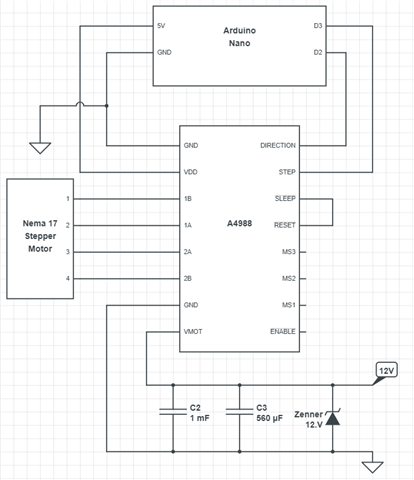

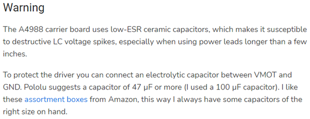

Protecting the driver
     One thing that I wasn't adding every time when I played with this circuit was a big cap at the power leads and more thing I shouldn't have done was move the motor by hand specially when using the DRV8825. This sentence sums up pretty much everything that was the problem last time, even more so, this time because I have used really long wires. Initially, I thought the DRV8825 was a better option than the A4988, since it can do 1/32 microstepping and some other stuff, but there is one crucial thing that the A4988 has that the DRV8825 doesn't have. Looking online and at the datasheets it became apparent that the A4988 has 40V Zenner on the inside for protecting the driver while the DRV8825 doesn't. Why is this important? Here is a screenshot from one of those sites linked above:
     And this here is the reason for the dying DRV8825 drivers. This is essential on the A4998 which already has more protection, so it's even more important on the DRV8825. To protect the A4988 properly I looked around and found some old caps I desoldered from some PCB-s and put them to good use, another thing I did to further protect the driver was add a 12.1V Zenner. The A4988 has a 40V Zenner as I've already mentioned, but since I am not planning on using that high of voltage, I added the diode as well. This is how the end schematic for me turned out.
     With this, we are almost ready to conduct our first tests with this setup. Besides this, all we needed was a bit of code to test everything out properly. I went to one of the above linked tutorials which covered the A4988 and pasted and modified the code from there. The code that I ended up with looks like this:

     This code was made by using the code from here ( https://www.makerguides.com/a4988-stepper-motor-driver-arduino-tutorial/  ). I modified the code to only spin the motor 5 rotations in one direction and 5 rotations in the other direction. Here is a small test video after uploading this to the Arduino and hooking up the motor and power supply.
     As you can see and hear from this video (or better said not hear) this is working so much better now. I've playing around with it quite a bit and was checking the temperatures on the driver but everything seemed great. The only thing I avoid doing as much as I can is rotating to the motor myself by hand. To finish up this part of the blog, all that's left to do is mount the motor to the rails and give it a spin!

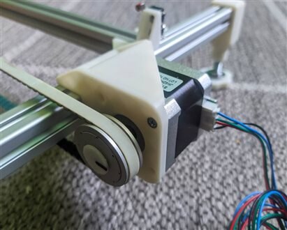

New mount for the motor

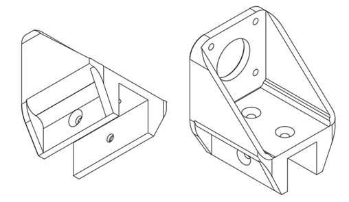

     In the last blog for the mechanical build: Project R.A.G. - Blog #6 - Mechanical Build P1 - Robot On Rails . I showed how I designed 2 different mounts for that motor, one for a flat surface mount and the other for mounting it to the 20x20 extrusions. Now it's time to design the third mount since this motor is a bit different. It's roughly the same size with the exact hole spacing of 31mm, but the motor shaft is center while on the other motor it was moved to the side a bit. It was a quick redesign, but a needed one nevertheless. To design the motor mount I used Fusion 360 and printed it on my Ender 3 Pro using Creality white PLA filament. It was printed at standard quality with 205C on the nozzle, 60C on the bed, at 0.2mm layer height using a 0.4mm nozzle. You can find both the STP file and the STL file for this mount on the following link: Rail System 3D models. It will be under name of Nema17 motor mount.
     As I've already said, it was almost the same design as the last one, with slightly thicker motor mounting plate and slightly thinner walls to accommodate the slightly wider motor. The only thing left to do is mount this to the rail system and mount the motor so we can finally see if the rail system is working as intended.

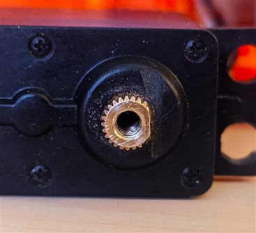

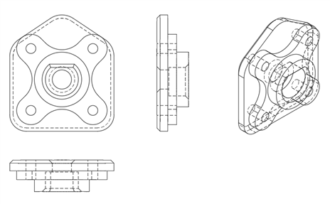

     Now it's time to perform surgery on our astronaut. As we have seen before he is a man of many talents, from dancing to art, but even though he is a sporty type, he doesn't handle falls or sudden moves good. The robot arm uses servo motors for moving the joints around. They are a great choice since it makes the arm fairly cheap to make an easy to use, since there are no needed additional motor drivers and so on, the only thing you need to do is send a PWM signal to the data pin of the motor and it will turn from 0 to 180 degrees. The biggest problem however comes in their mechanical design in my opinion.

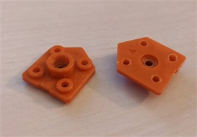

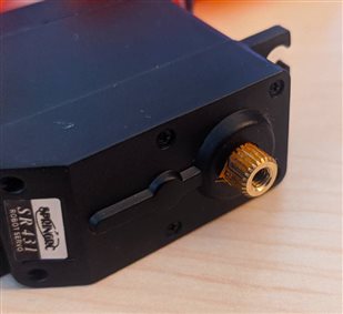

     The only problems I ever had with this arm are because of the way the motors are attached to the arm itself. On stepper motors, like the ones I used in this blog earlier, we have what's called a D shaft. It's a thick metal shaft with a flat spot on one side, this gives an ability to transfer great amount of torque easily. On the servo motors however there is a different solution. These motors are usually small and are used for things where a lot of torque is not needed and this problem is obvious when we are using plastic parts. Let's begin by examining the servo motor end.
     On the first picture you can see the stepper motor and what I talked about. This is a great and reliable way for mounting stuff to the motor, all we need is a mount with the right hole size and shape and a set screw if we want to keep it in place. On the second picture we have the servo motor. You can see that it has small teeth on the outside which are supposed to meat with the teeth on the motor adapter. But here is where we run into the problem. It's good that the teeth on the motor are out of metal, but unfortunately, the motor adapter isn't, it's out of plastic. You can see in the second picture how much orange plastic is stuck between the teeth of the gear from grinding one against the other. To the engineers credit who designed the robot arm, they were aware that this was going to be an issue and made it so you can replace these plates when they fail like they did on me and they even included spares in the box with the robot. Unfortunately, as I've been using this robot for quite a while, I've gone through all of those that were included.

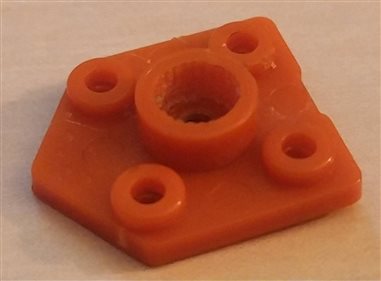

     They sell a kit on the store with a spare motor and more of those adapter, but I don't have time to wait for a new set of those, so I need a different solution. This will probably void the warranty (like I haven't done that already with this arm...) but I am going to try and file down a side of this metal gear to make it into a shape of a D shaft and then mimic the shape and holes from the original adapter just with the fitting for the D shaft.

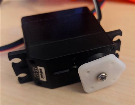

     This was surprisingly easy to do with a small hand held file. I thought it would give off a bit more resistance but it went pretty fast. I could have went more, I could have even gone to the thread itself but I thought to stop here and to see if it was good enough. The next thing I had to do was design a small motor adapter to replace the old ones, but, this one had to have the D shape hole in the top. I just used a pair of calipers to get the dimensions and slowly built it up in Fusion but adjusted it so I can print it easily and added a bit more material to be stronger than the original one.

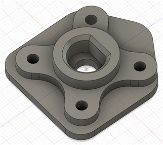

I moved the servo to roughly the 90 degree position because we are losing symmetry by doing this and can't mount the adapter however we want. This just made the modelling process easier knowing that the straight edged part should be at the top as you will see now.
     The best thing about it how short the print was at around just 13 minutes. I printed it at 0.2mm layer height, 6 outside walls and 100% infill to make it as strong as possible since it is a small part with only one purpose and that is to transfer torque. If you maybe had the same issue as me and would like to go this way, here is the folder where you can find the 3D model for this part under the name ServoAdapterPlate, you will find both STL and STP files inside: BRACCIO 3D models. All that was left now was to fit this part to our servo.
     The adapter fit was spot on! I could have maybe went with a little bit of a smaller diameter on the outer hall but it was already a really tight fit when I was mounting the adapter. The outside dimensions could maybe be trimmed about 0.1-0.2mm to just fit the robot better, but it works great like this as well. I am happy to say that this was the first try for this. The only thing left to do is to see if everything is working on that joint as it should.
     That's a relief, the surgery was 100% successful and it promises even more torque ability. As you can see from the video, the range is great and I tried going as fast as I could on the servo with sudden changes to the movement, but nothing gave up. Even if this goes overtime I can just print out more in a matter of minutes, but if I see that it's becoming a recurring problem again, I'll file it down more and redesign the adapter.
