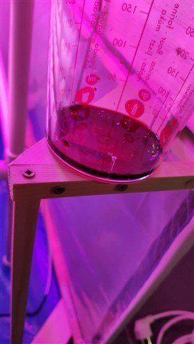

It was time to add nutrients to the water (three part nutrients)

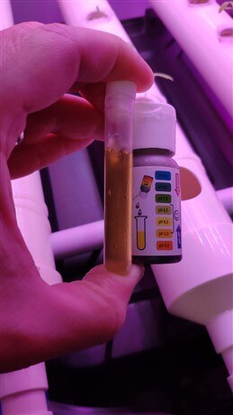

and to check the PH level of the water - always about 30 minutes (and a watering cycle) after adding the nutrients, because the nutrients alter the water PH - to above .
the following week I'm planing to make this automatic with the PH sensor.

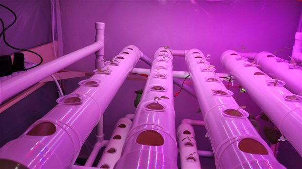

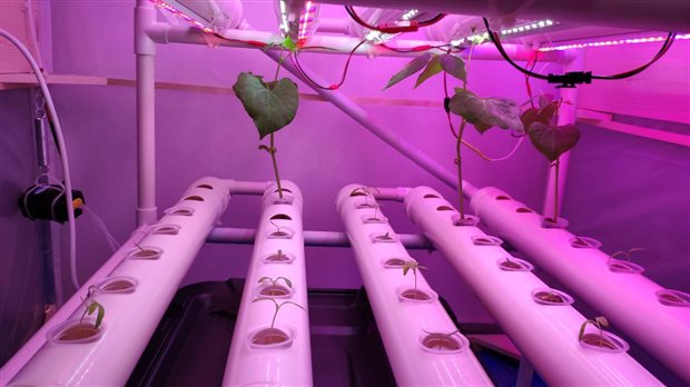

After a week I can already see some changes - the plants have grown. image  I'm happy with the progress so far.
The beans have grown and I can tell because they are touching the lights - will do something about that - they will not grow much more - this bean quality has been chosen specifically because they don't grow much taller.

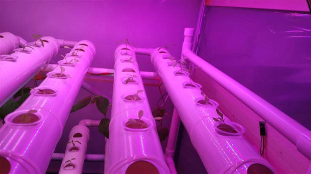

The other plants have also grown.
I had to change 4 of the plants because they were dry. When replacing them I realized that the fault was mine - when transplanting them last week, I accidentally broke them in the stem ...

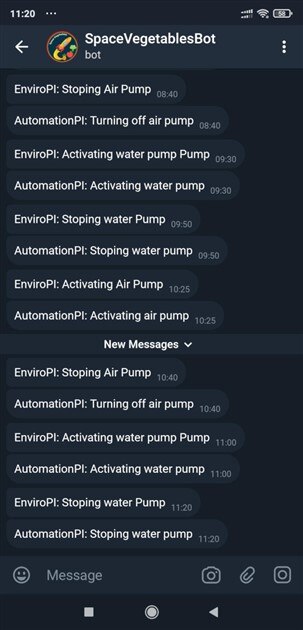

The Air pump and water pump both are working well and they turn on and off when instructed.
I've added Telegram notifications for when all this happens so I can keep an eye on all of this.
