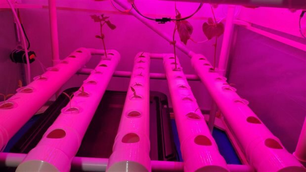

With everything set, let's start the transplantation.
Moving to Hydroponics

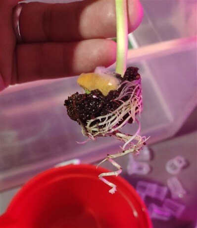

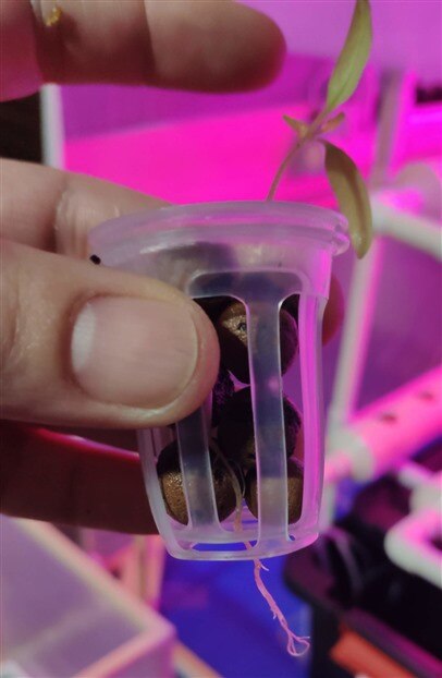

The plants now go to a small plastic vase and then they go into the hydroponics kit. At first, I was going to use expanded clay balls to hold the plants in place, but a problem arise:
Fullscreen contentimage_146902.html Download
<html><head><title>Jive SBS</title></head>
<body><font face="arial,helvetica,sans-serif">
<b>Error</b><br><font size="-1">
An general error occurred while processing your request.
</font></font></body></html>
The freaking vase has big holes on the "sides" and in the bottom - the clay ball would just fall off. My solution (for a brief moment) was to use 2 vases together to make the holes smaller and find big clay balls for the bottom...It worked, for the bigger plants.

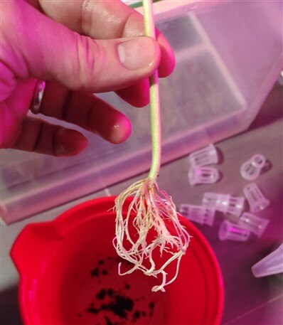

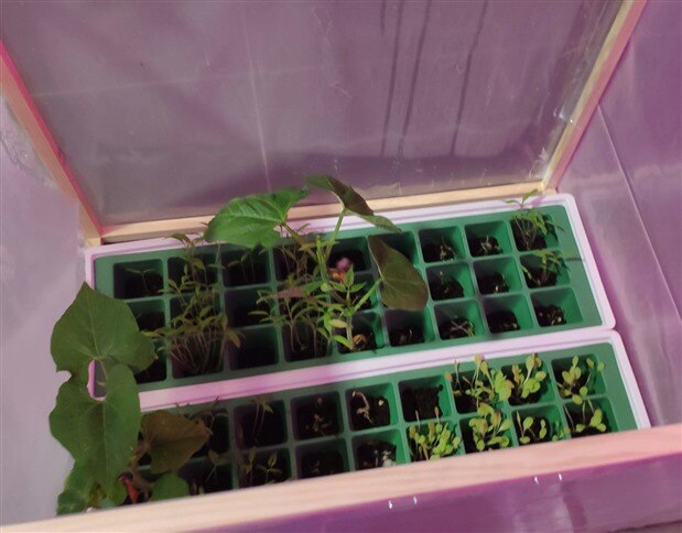

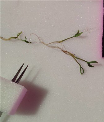

First, I got them from the small greenhouse I set up to let the seeds sprout. A small cleaning (rising with water) and to the vase it goes

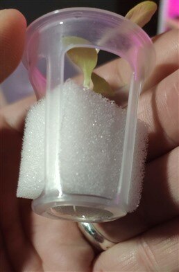

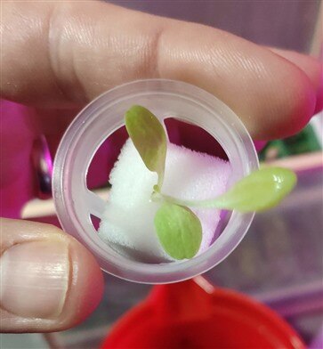

Since I only had 3 beans sprouts, everything worked fine with the vases and the clay balls... Until the smaller ones:
It seems fine, but it will go throw the hole ! image
Then, I remembered that the kits came with small sponges right for this task. Let's use them. They are so small that I had to use tweezers .

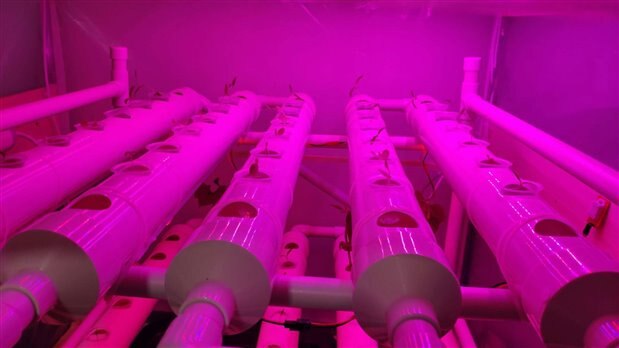

After a few hours work, this is the result
And the project is a go.

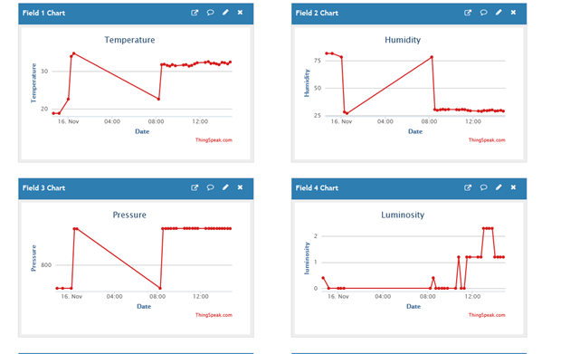

There are still a few kinks to workout in the code, but you can follow the project (beside here - still a few more posts to go with code and schematics and progress) using Twitter and ThingSpeak, where all the environmental parameters are being sent.
Twitter for Space Vegetables
The twitter updates are every 4 hours with a photo and environmental parameters
Here's the Twitter page
ThingSpeak
You can also follow the project using ThingSpeak. All the values will be there:
Remember: There's still some kinks, so, the values will not be real (not all, just some) until next week.
