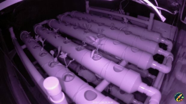

When submitting this project, one of the requirements I've set was to have a script to post to twitter (at least twice a day) a photo of the hydroponics vegetables progress with some environmental status.
Here I'm going to explain how .

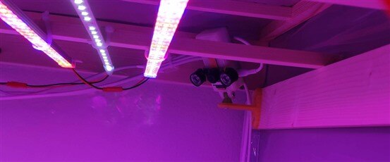

Hardware
This is installed in a Raspberry PI Zero W with a 64Gb SD Card. It's equipped with a RPI Camera NOIR 5M fisheye with 130 degrees.
Software
The software is a simple python script that takes pictures every 10m, but only posts to twitter every 4 hours.

Line 41 will display a message in the log.
Because this script takes a picture every 10 minutes, and a post to twitter is only every 4 hours, when posting to twitter I want the latest picture available.
This following lines will get the latest image available.
Line 51 generates a list of all the images in the directory.
Line 52 , using the max function, returns the image name with the latest modification time. The max function uses a key to order. We use ctime (Linux changed timestamp) to know the latest one.
# get latest file in directory
list_of_files = glob.glob('images/*.jpg')
latest_file = max(list_of_files, key=os.path.getctime)
Lines 55 and 56 create the message to be sent in the post. We get the environmental parameters with the function getEnvironment(). In line 56 we add some hashtag words .
message = getEnvironment()
message += "#spacevegetables #element14 #1meterofpi"
In line 57 we send it, using the tweepy function update_with_media to attach a picture to our message. The result is:
def addWatermark()
This function adds a watermark to the pictures taken.
Lines 66 and 67 define the dimensions of the watermark picture. Lines 69 and 71 open the watermark picture and the picture just taken. Next, in line 75 we get the dimensions of the image taken by the camera. We know the dimensions, but this way we can use it for any image, even with not known dimensions.
size_w = 105
size_h = 105
# load watermark
img_watermark = Image.open(pictureWaterMark)
# load image taken from camera
img_orig = Image.open(pictureFilename)
Lines 77 and 78 calculate the top-left position in the picture taken from the camera for the top-left watermark picture. I left a 20px margin, so the watermark picture won't be positioned at the edges.
def_w = (img_w - 20) - size_w
def_h = (img_h - 20) - size_h
ie:
picture_widht: 1920
picture_height: 1080
watermark_w: 105
watermark_h: 105
position_watermark_w = (picture_widht - 20) - watermark_w = (1920 - 20) - 105 = 1900 - 105 = 1795
position_watermark_h = (picture_height - 20) - watermark_h = (1080 - 20) - 105 = 1060 - 105 = 955
1795, 955 will be the top-left position in the picture taken from the camera for the watermark picture.
Line 79 pastes the watermark picture in the original picture at the position (pixels) calculated above
Line 80 saves the changed picture - to be easier, it overwrites the original picture with this new one.
img_orig.paste(img_watermark, (def_w, def_h), img_watermark)
img_orig.save(pictureFilename)

Here's an example (already with timestamp and watermark):
After that, we add the watermark, the timestamp and sleep for 10 minutes .

    Very good update. Are you using white light or a combination of blue and red? DAB
