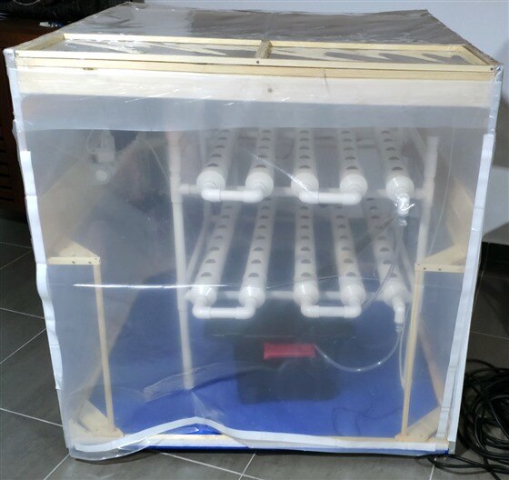

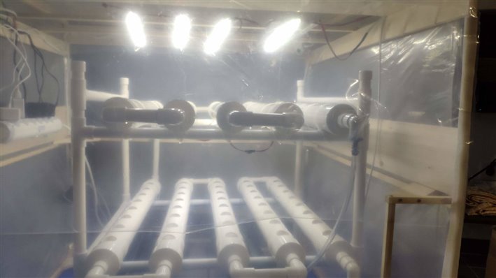

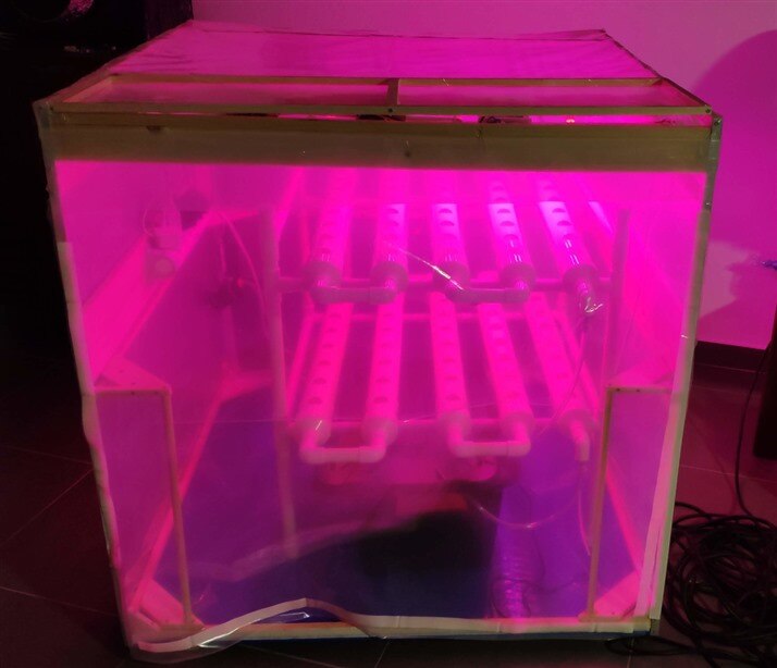

Greenhouse
This is the finished "contraption" to house the hydroponics and all the electronics that goes into controlling it.
The housing is just some aluminum profiles with wood to make it sturdy and be able to fix all the electronics.

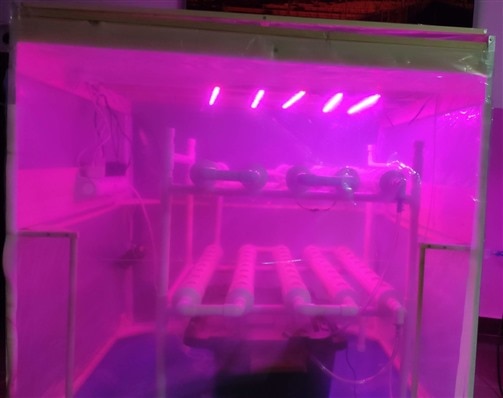

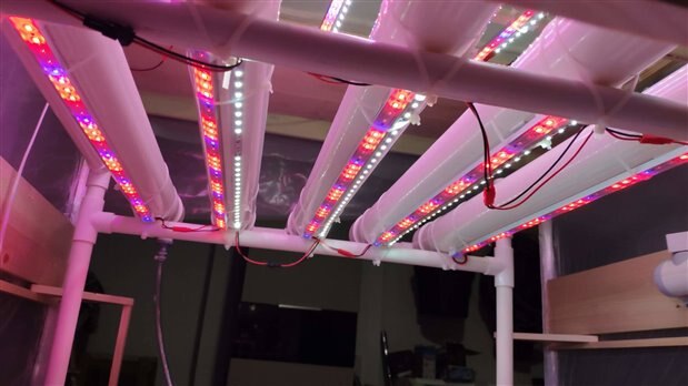

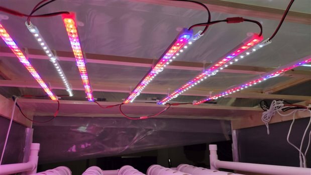

Because this is not able to withstand the rain - and I'm in the northern hemisphere, its fall/winter time, it has lights to help the plants grow.
The first set of lights are fixed to the greenhouse and the second set of lights are fixed to the top layer of the hydroponics kit.
I have white lights and red/blue lights, in the ratio 5:1 .
It has been shown that plants not also need red/blue, but also white lights - the full spectrum. It's certain that when growing they need more of one than the other, but when in the vegetative state or fruiting, the need more of the other
Further reading here and here
It has a tick plastic all around it and the "doors" - front and back - have velcro to allow to "open" and "close" when needed.

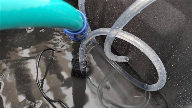

The kit already has been tested with water to search for leaks. Everything is fine and no leak was found. There was some problems with the water tube connection, but a bit of plumber tape solved the problem.

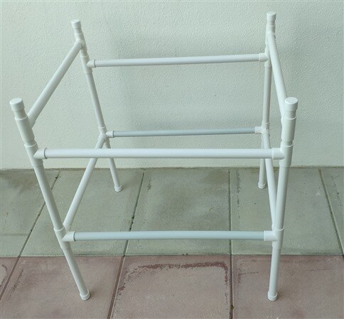

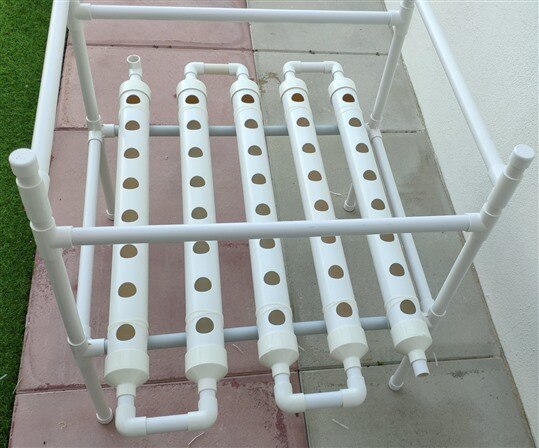

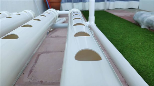

Assembly of the hydroponics kit
Here are some pictures of the assembly

Why two lights ? Well, they should have been together, but the 12v power source I was going to use for both does not have enough amps.So, I've split them into two.
