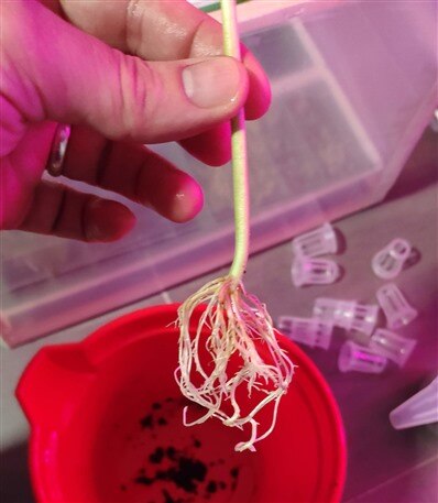

Moving to Hydroponics
The plants now go to a small plastic vase and then they go into the hydroponics kit. At first, I was going to use expanded clay balls to hold the plants in place, but a problem arise:
Fullscreen contentimage_146902.html Download
<html><head><title>Jive SBS</title></head>
<body><font face="arial,helvetica,sans-serif">
<b>Error</b><br><font size="-1">
An general error occurred while processing your request.
</font></font></body></html>
The freaking vase has big holes on the "sides" and in the bottom - the clay ball would just fall off. My solution (for a brief moment) was to use 2 vases together to make the holes smaller and find big clay balls for the bottom...It worked, for the bigger plants.
The following one is a bean sprout
Fullscreen contentimage_146903.html Download
First, I got them from the small greenhouse I set up to let the seeds sprout. A small cleaning (rising with water) and to the vase it goes
Since I only had 3 beans sprouts, everything worked fine with the vases and the clay balls... Until the smaller ones:
It seems fine, but it will go throw the hole ! image
Then, I remembered that the kits came with small sponges right for this task. Let's use them. They are so small that I had to use tweezers .
After a few hours work, this is the result
And the project is a go.
