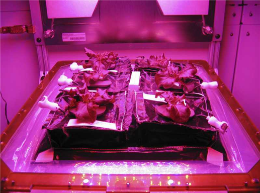

Researching available technologies is a great way to start a technical challenge. Chances are, a technology similar to the one I'm looking to create already exists. Lo and behold, I came across NASA's Veggie, shorthand for The Vegetable Production System. I found two insightful research papers: "Plant Pillow Preparation for the Veggie Plant Growth System on the International Space Station" and  "VEG-01: Veggie Hardware Validation Testing on the International Space Station" (PDFs attached). The first research paper highlights the importance of containing the grow medium, fertilizer, and water as there is no gravity in outer space to anchor these elements. The second research paper describes the experimental results of Veggie aboard the International Space Station and suggests that automation of processes such as irrigation is the next logical step in developing robust plant growth chambers.
Outredgeous red romaine lettuce plants grow inside a prototype Veggie flight pillow.
Photo Credits: NASA/Dr. Gioia Massa
